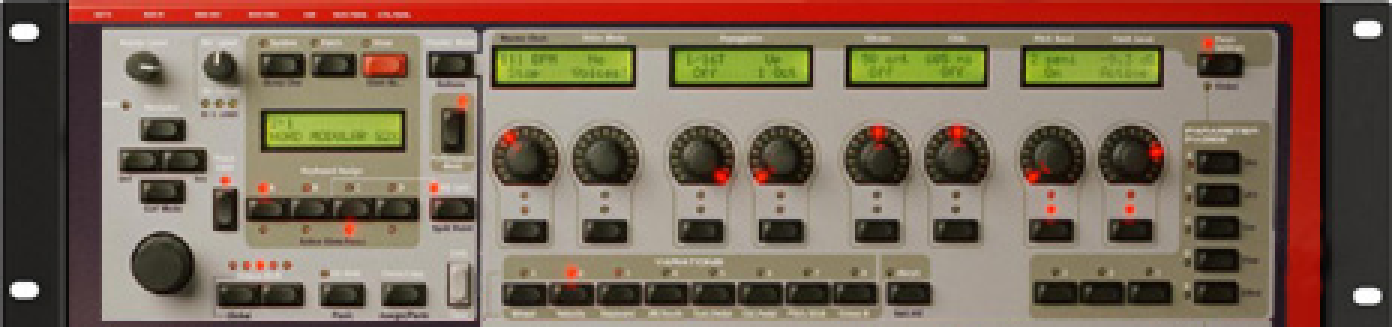

Please vote if you would buy a controller with the same functionality as the G2 keyboard control panel.
It is possible according my research. I could implement such a controller based on the number of votes.

Thanks for sharing the service manual here! I think these 2 resistors are related to the extra controllers on the G2X. I did not follow the traces on the pcb but they must be connected. On the other hand, I doubt that the OS makes the difference between G2 keyboard and a G2 engine in the same way, with a resistor. But I'm not saying it's impossible to spoof / emulate G2 keyboard components and cheat the G2 engine OS. But it requires a little material, time .. and who wants to risk damaging his G2! But if you have other leads I can participate in the project (the one you are talking about at the start) and do some tests if I don't think it's too risky. I had in my possession a G2X, a G2 keyboard and a G2 engine. I changed some parts on some of them.
I also did some research in this direction. When I wanted to convert the parameter names for the 'parameter pages' to send them to the screen of a novation SL mk2. At this point several people were suggesting sites that make custom MIDI control surfaces. I use the Novation SL mk2 to control many other machines, especially with sysex. So I use the Novation to control the G2 engine parameter pages I gave up making a custom controller for the G2. But you have my vote if you want to work on it, if it's quality, serious and it costs a few hundred dollars.
Can you give a little more detail on what you have in mind? Would the engine OS be able to recognize the custom control surface as a G2 keyboard?

The Engine main board is a population variant of Keyboard version board (some components are soldered differently). My original idea was to make a controller that could be connected to the Engine's main board (However it would be much more elegant to connect it via MIDI/USB).
My goal is to achieve the same user experience as the Keyboard version gives.

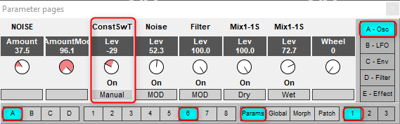

Hi Bruno,
Thank you for your quick response.
So as I mentioned before I would like to design an external Physical controller for G2 Engine like G2 Keyboard version has. Same functions and similar layout.
I see three approaches to implement it:
1. "Clone" the G2 Keyboard front panel and connect it to G2 Engine main board (already proved it is working).
2. Design an external controller that is capable to control G2 Engine via MIDI(not CC).
For example use a Microcontroller:
- Interface to G2 Engine (MIDI host)
- Interface to Encoders (knobs), LCDs and buttons.
3. Design an external controller that is capable to control G2 Engine via USB. For example use a Raspberry Pi:
- Interface to G2 Engine (USB host)
Could you please help me and give some explanation how parameter page values are communicated via USB or MIDI(if so)? Sorry I'm not familiar with Delphy.

A knob on the parameter page refers to a parameter.
To change the value of a parameter through USB you have to send the following message:
(In file g2_mess.pas, line 3657)
function TG2MessSlot.CreateSetParamMessage( aLocation, aModule, aParam, aValue, aVariation: byte): TG2SendMessage;
begin
Result := TG2SendMessage.Create;
Result.WriteMessage( $01);
Result.WriteMessage( CMD_NO_RESP + CMD_SLOT + SlotIndex );
Result.WriteMessage( FPatchVersion);
Result.WriteMessage( S_SET_PARAM);
Result.WriteMessage( aLocation);
Result.WriteMessage( aModule);
Result.WriteMessage( aParam);
Result.WriteMessage( aValue);
Result.WriteMessage( aVariation);
end;
CMD_NO_RESP (Hex30) means it is a message that does not initiates a response
CMD_SLOT (Hex08) + SlotIndex refers to the slot the patch is in.
FPatchVersion is a number that increases every time a structural change is made in a patch.
S_SET_PARAM (Hex40)
aLocation refers to the VA or FX section.
aModule is the Module id in the location
aParam is the id of the Param in the module
aValue is the new value for the parameter
aValraition is the variation
The in-memory data structure of the G2 is more or less the same as the file structure. The file structure consists of "chunks". So there one or more "module" chunks, one or more "cable" chunks, "module name" chunks, "parameter" chunks, "parameter name" chunks, "knob" chunks, "cc assignment" chunks and so on.

I asked you a question in "NMG2 Open Source Editor" topic. Do you have an idea how to collect controllers names (with OSC or whatever) from the parameter pages box on the G2? I want to mimic G2 display and pots with a Novation SL mk2. I know how to send/change knob names in real time with sysex for the Novation SL mk2. if I understand how to sniff parameter names in real time, I should be able to code a small tool that will do the conversion to sysex and send it to the Novation screen. I thought it might be easier from your editor to send the name of the parameters to an external tool than with the official editor
The Novation has 8 infinite knobs and 8 aligned buttons, then a screen at the top of each knob like the G2.
Cheers!
brunov
Joined: Aug 03, 2011
Posts: 227
Location: delft
PostPosted: Fri Sep 09, 2022 4:15 am    Post subject: Reply with quote  Mark this post and the followings unread
Probably the simplest way is to initiate a patch/perf sysex dump from the g2 over midi and extract the knob assignments and parameter names from this data.
The complicated way would be to create a program that gets the data over the usb interface, as explained in the above posts.
There is also maybe a third way, that is you can connect to NMG2 OS editor using TCP/IP. The editor must be opened and connected to the G2 of course, but then you can get (or send) G2 messages over TCP/IP to the editor. These are the same messages you would use over the USB interface.
The TCP/IP port and host are on the "Application settings" dialog, tab TCP/IP.
This can be a bit complicated too of course, depends on your programming sklils. What programming language do you use?
Electromagnetic Wave
Joined: Apr 28, 2013
Posts: 305
Location: Kebek
G2 patch files: 38
PostPosted: Fri Sep 09, 2022 2:18 pm    Post subject: Reply with quote  Mark this post and the followings unread
Your first option is brilliant and simple. But I don't have a clear idea how I can only display the parameters of the current 'parameter page' on the 8 knobs of the Novation SL mkii. I assigned control changes on Novation SL mkii buttons to change the parameter pages (1,2,3,A,B,C,D,E) of the G2 with NMG2 OS editor. I imagine that a solution to make the bridge in real time would be to send the value of the ccs assigned to the 'parameter pages' to the tool to be programmed. After the value for the letter and number of a 'parameter page' (A,B,C,1,2,3,4,5) are sent the tool will update the name of the 8 knobs on the Novation SL mkii by sending the name of the parameters converted into sysex messages.
This is the option that looks like this that I was considering the most. I was wondering if it was not possible to modify the editor to retrieve the name of the parameters. Then send the 'pameter names' to the tool which will convert the names to the Novation screen.
If I understand correctly this solution is similar to the previous one but using TCP/IP instead of USB?
I know visual basic. I can open a project in delphi and understand a bit but I'm not comfortable coding. What seems certain is that even if I make a tool to transfer the names of the 'parameter pages' I will continue to use the NMG2 OS editor in parallel to control the knobs of the 'parameter pages' in real time on a G2 engine
brunov
Posts: 227
Location: delft
PostPosted: Mon Sep 12, 2022 1:03 am    Post subject: Reply with quote  Mark this post and the followings unread
Yes I think it is possible to send midi messages in response to label changes on the parameter pages. Only I don't think it is a good idea to build in code in the editor for a specific type of controller, this should be something that is generic.
I mean, you should be able to create some kind of config file in which you can define how to convert de label data into a SysEx message that is specific for your controller.
But, let's see wat sellblue ideas are on this.
