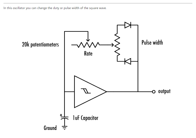

I'm just starting my lunetta journey, well, restarting actually, after a long time with my head in code I've gone back to hardware and finally getting round to making a 'modular' lunetta setup.

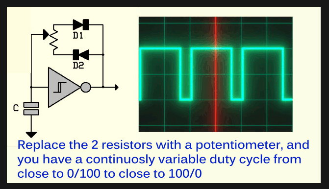

I've got a 4093 square wave going with variable duty cycle based on two diodes and a pot. I've put the schematics I've copied and followed the discussion here https://electro-music.com/forum/topic-47266.html
I've found the modulation of the pulse width gives some more interest to the sound and I'd like to automate it - with other variable resistor controlled parameters (e.g. pitch of an oscillator) I've replaced the pot with a homemade vactrol - i.e. an LDR flashed by an LED linked to a lower frequency oscillator - a but I'm a bit stumped how to get this to work when all three legs of a pot are connected, as a divider rather than variable resistor. I thought I could just bridge one side of the pot with a LDR but it doesn't work to effect pulse width, instead the pitch is altered.
Grateful for any advice!

A pot really is like two resistors where the one is the reciprocal of the other, so .. I'd expect two LDRs.
To make that reciprocally controled by a PWM signal there should be two shiners too .. LEDs . where the one gets the inverse PWM control from the other.
Does that make sense for you?
Edit: on a 2nd thought - as the LDR / LED system is not linear and you may still get frequency control .. so .. eh .. maybe the first thought was just stupid Shocked
Edit 2 : 'stupid' just means 'naive' here - or 'without thinking', of course :`) anyway - it is an interesting problem!

I think I see what might be happening then - the circuit works best for me when the frequency pot and width pot are the same value (100k) - the large resistance of the LDR (could be about 1M fully dark) must be too large and means you get a frequency change rather than an effect on duty cycle.
Is there a way to modify the circuit to just control 'one side' of the the pulse width - with the two diodes-pot setup you can go between 0-100% (about 2-98% with a limiting resistor) but really 0-50% and 50-100% sounds the same in terms of the modulation effect. If it were possible to just to one side with a pot in variable resistor configuration, then the LDR across the resistor trick might work for me. I've done a bit of trial and error but turned up nothing.
Otherwise perhaps I need to investigate voltage control of some kind. I'd sort of resisted that as it seems to stray away from the simplicity of the lunetta idea and into bipolar power supplies, op amps and 'proper' synth circuits.

Like blue hell said, if you want to emulate the behaviour of a voltage divider potentiometer, you would really have to replace both sides with a vactrol, where as one LED is the inverted version of the other one. You could achieve that with one of the other gates of the 4093, if it's only a squarewave control signal.
But what i would suggest is replacing one of the resistors (or potentiometer wings) with a vactrol and playing around with a resistor size of the other one. I am actually sure this way you will find something that sounds interesting enough.
This approach is for example used to replace volume knobs (that are voltage dividers to ground) with LDRs, i also used this technique making a LDR controlled Logic Gate.
Let me know if you need a schematic of it...

Agree to "...sure this way you will find something that sounds interesting enough." When you are only looking for the audible result, then consider that a PWM of 80/20 sounds exactly the same as a PWM of 20/80. So you can use a 100k pot (or vactrol) in one diode path and a 100k fixed resistor in the other, for example.

Thanks for all the replies - so I split the 100k width pot into two 47k pots (which I had to hand, I guess 50k would be an exact swap out) and then fixed one at max and turned the other - and as you've said 50-100 (or there about) is the same sonically as 0-50 you get that strange modulating effect. I guess one of the pots could actually be a fixed resistor - but I can't find anything close in my selection pack right now.
It's difficult to replace the pot directly with a vactrol because the range of the LDR (~1M I think) is too great but placed across the 47k pot you get the parallel resistance so the overall range isn't as wide but you still get some nice modulation especially at fast blink speeds. Unless there's a way to set the range of an LDR?
As someone said up thread the non-linear nature of the LDR means you don't get that smooth modulation but I've got another circuit in the works which gradually fades the LED in and out rather than blinking on and off, so I'm hoping to get a more gradual effect in my finished vactrols.

For some reason in this circuit it works best for modulation with the frequency pot and width pot roughly equal (I used 100k in the non LDR version) - I've grasped the basics of the Schmitt trigger oscillator but if I'm truly honest I'm not sure quite how the two different facing diodes are working. But using my ears and a scope I can see it *is* working.
I've just seen PHOBOs' XOR based width circuit too where you input two copies of the same wave but with one slowed down (with a low pass filter?), so I might try that, as it only requires a variable resistor.
