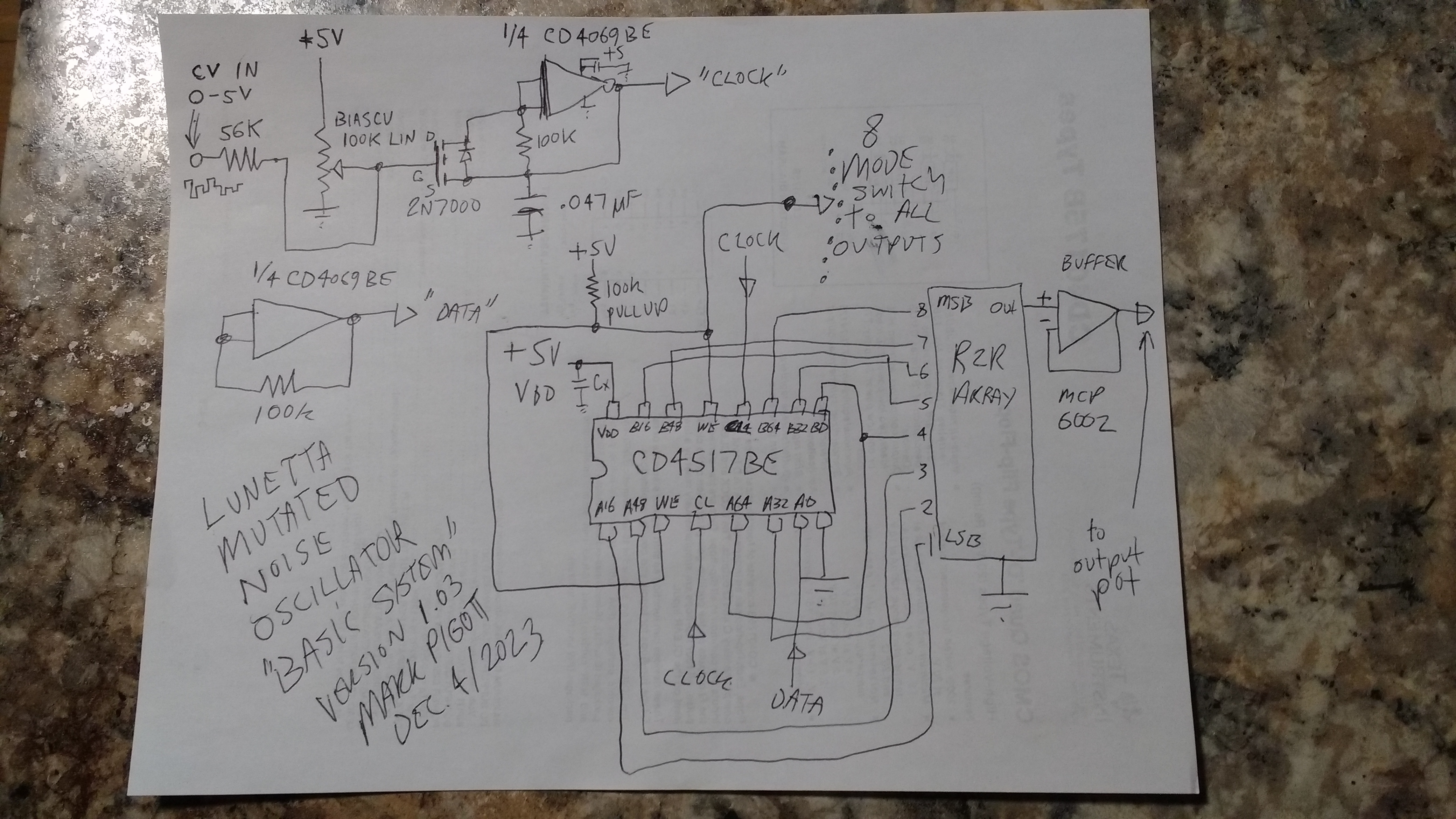

TYPO on the schematic. The CD4093BE is where the drawing says it is a CD4069BE.
My dsylexia!
It would not work well, or at all using the CD4069...but who knows!
https://youtu.be/ipZyAvl3NSw
FILED UNDER OBSOLETE ELECTRONICS:
The second revision of my Experimental Noise Oscillator series.
This one is a CD4093BE as a voltage controlled oscillator (VCO)and a high frequency oscillator generator (HFO).
A CD4522BE processes the "clock" which is the "VCO" output which then feeds the clock input of a CD4517BE.
4 outputs of the CD4517BE control the division rate of the CD4522BE.
The DATA (the noise element) is fed from a high frequency ring oscillator
from CD4093BE.
The 8 outputs of the CD4517BE are converted to analogue via an R2R DA
and an MCP6002.
The 8 modes are controlled by the WRITE ENABLE on the CD4517BE
by tapping 8 different points.
This will be replaced by an analog SP8T switch later on when I get said switch.
All powered on 5V for your benefaction.

Lots of stuff.
The frequency of the "VCO" requires an external source,
so it is connected to a three stage ASR. (using one stage)
At the time I left unused gates floating and this added to the wrecking.
Like a dumbass I never recorded the breadboard schematic
(because I thought I knew if off by heart ((I did not))
So this circuit for the first video is lost to time.
I do know I used a CD4093BE as the "VCO", a CD4522BE and a CD4517BE.
But how I wired it up to get the first video sound I was never able to replicate!
However, I am working on a new noise make called the LMNO or
Lunetta Mutated Noise Oscillator, so all is not lost!
