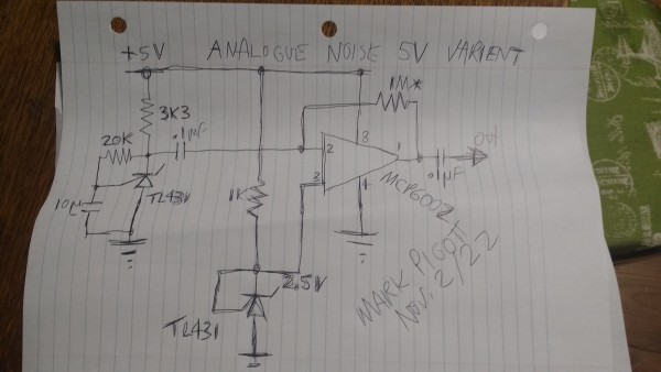

PostPosted: Thu Oct 05, 2023 4:40 am    Post subject: Reply with quote  Mark this post and the followings unread
This circuit works fine all the time at 5V, it might even work at 3.3, but I never tried.
To simplifiy you can use a 10k,10k voltage divider on pin 3 of the op am and it works fine as well.
This triggers shift registers fine as it is biased near the trigger point.

I find the LFSR a whole lot of chips that can be done analog with just some caps, resistors a TL431 and a MCP6002.
Analog brown noise has enough random to trigger a CD4517BE.

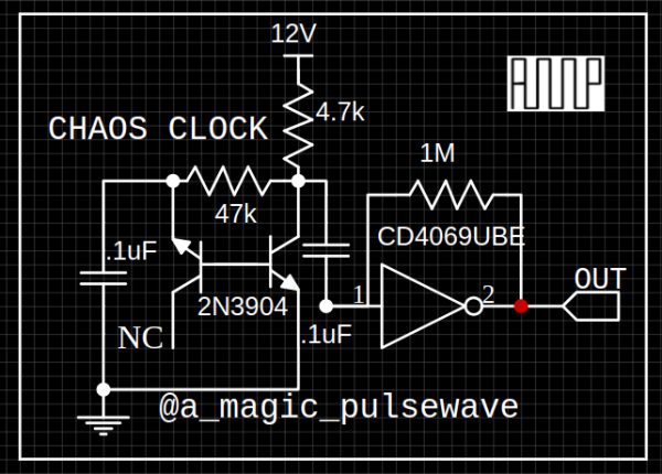

PostPosted: Wed Nov 22, 2023 3:11 pm    Post subject: Reply with quote  Mark this post and the followings unread
My contribution.
Basically just a white noise generator with an amplifier stage to square off and output random pulses. If it is not outputting strong enough signal from one CD4069 stage as shown, it can be followed by additional identical stages to further square the signal up. The necessity of additional stages may depend on how noisy your transistors are.
Following it with a divider, flip flop, shift register, etc, you can bring it down into lower frequencies or "sampled and held" results for use as a random logic source for various things.
I have used it as a clock source into a CD4017 to output random results. High logic into the "enable" pin on the CD4017 (or using a switch to connect/disconnect to the CD4017 clock pin) will freeze it on one of the output pins, basically acting like rolling "electronic dice." Setting the reset on the CD4017 from one of the counter output pins, you can set how many possible output states you would like.
