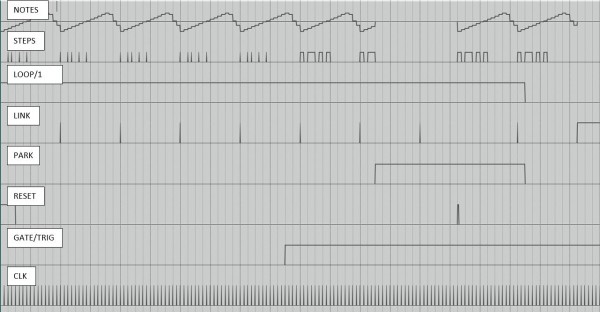

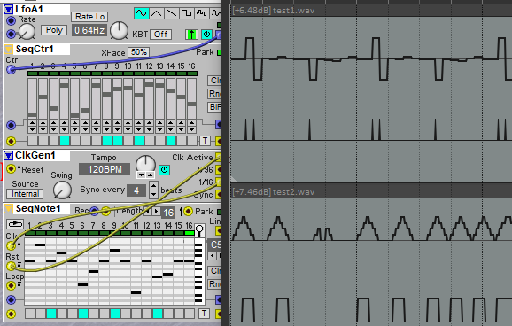

Hi folks! Long time no see. I am finally on my vacation after all.
So here we have a new update - some bug fixes and all 5 units from Sequencer group are done.
We continue to reverse some units from FX group, and also I plan to advance on Envelopes.
As always - any questions, suggestions etc are very welcome! see you soon!
G
PS the picture with Nord's units is not related to the its right side. It is just to show that we did a lot of test prior to posting it here)

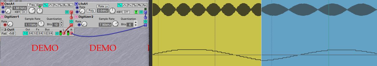

Hi people!
Meanwhile the digitizer is online. I've personally never used it, but anyway let it be. As you may see, bit reduction works fine (see for bottom LFO waveforms). Rate reduction gives slightly different results (e.g. the parasite amp modulation is different for upper waveforms). My theory is that the Nord sine wave has some higher (in)harmonics, which in turn leads to more harsh outcome under sampling rate reduction. Maybe later I will try to research more.
Until next time!
BTW modules table on github is not sane for now. We will fix that soon. Also, installation procedure changed. See for more details on github.
