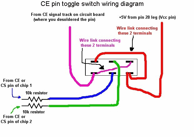

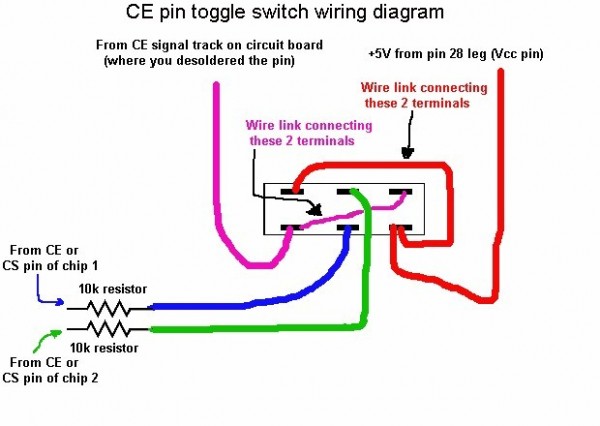

I now have 2 chips installed in my Casio SK8 - the original SK8 chip (the uPD43256), and the new chip (the DS1230Y), stacked on top of each other, with a switch and 2 resistors to switch between the 2 chips!!! Woooo Hoooo!!!!
This has given me 2 separate banks of 4 samples - the 4 from the original chip, and now an extra 4 from the top bank. Oh, joy, oh, joy!!
It wasn't really hard to do at all, but there were things that I have learnt on the way that I will share with everyone, so that the journey is as smooth as possible.
I understand a lot more about digital electronics since I started on this project 2 weeks ago; I want to thank mi_dach especially for his priceless advice about address line connections and stuff, and everyone else who has helped with advice. Thanks, guys, this forum ROCKS!!!
I am going to start a new topic as a full write up, with pictures, on how to do the expansion. I feel that it is an important project, not because I wanted to expand my SK8, but because the procedure will enable you to expand pretty much ANY device that uses RAM memory to store programs, setting, etc.
Just to leave you with something until I write it up, I simply soldered the new chip directly onto the old one, pin for pin, except for the CE pin (or CS pin on some chips), which I bent out horizontally away from the other pins on the new chip. I then disconnected the old chip's CE pin by de-soldering its track on the circuit board and isolating its pin. Please have a look at the datasheets for both of these chips first (they're a couple of posts up) and study them.
I then soldered 10k resistors to each of these CE pin legs of the 2 chips. These 2 resistors then went to the 2 centre terminals of a DPDT toggle switch via lengths of insulated wire - see the diagram below.
The rest of the wiring is as per the diagram. The CE signal track wire is soldered to the CE pin track on the track side of the board, anywhere near where you desoldered the CE pin from the original chip (make sure you don't accidentally reconnect the CE pin to the circuit track again).
The +5V supply wire is soldered directly to the exposed pin 28 leg (the +5V Vcc pin) of the original chip, as a convenient +5V supply for the switch.
That's basically it! Check out the full illustrated instructions in a new post soon. I'm off to play with my sampler expansion!! Mr. Green

I'm curious to know, is it possible to toggle between the banks at any time (ie when it's playing some samples?) Can you quickly jiggle the switch back and forth between the banks without it crashing? Smile
gmeredith
Joined: Jun 28, 2006
Posts: 82
Location: Tasmania, Australia
PostPosted: Thu Aug 03, 2006 5:50 am    Post subject: Reply with quote  Mark this post and the followings unread
Hi mi_dach!
There is lots of room for a socket and a single chip, i've already measured! Seeing my big 8MBit chip has arrived from the US today, I'll be attempting that expansion - 32x memory expansion! I'll really have to get the LED display happening in order to keep track of them!
I haven't tried toggling between the memories while it's playing yet. I'll try it when I get home from work tomorrow. Might make for some excellent sample mashing!!
Cheers, Graham
