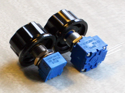

Bourns series 90 (used in MOTM) is not very small (16*18mm)
compared to for example Bourns series 50 (13*13mm).
I'm planning to use the wonderfully dampened metal-shafted 50 instead of the way too loose plastic 90.
Here is a picture of a 51 and a 91, both with MOTM-sized knobs (PKES90):
 Filesize:  83.32 KB
 Viewed:  2421 Time(s)

Yes, this smaller Bournes 50 is exactly what I need-- thank you very much for pointing it out. Very nice.
I figured these-- pictured Bournes pots above-- were a common species. I've seen them in many peoples' projects-- but I've just never looked further than the $0.50 small Alphas offered by Futurlec. But now I need something even smaller.
I wonder, if the Bournes 50 is indeed unavailable, if there is a Spectral pot, for instance, with similar specs, size, etc.
