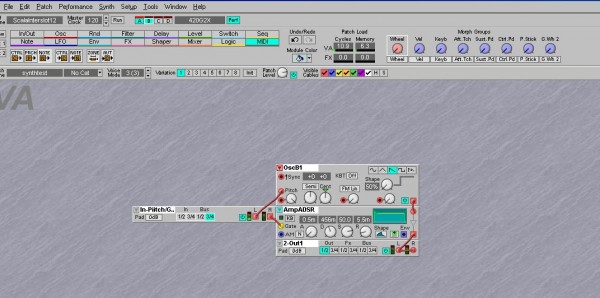

PostPosted: Sat Sep 07, 2013 7:33 pm    Post subject: Reply with quote  Mark this post and the followings unread
Can I use the Scala G2 tool patch (.phc2) for interbus slot patching ? Control the pitch on a synth to another slot ?
Not working with a "NoteSend" module linked to another slot. I tried this too :
Slot1
The output cable from the Mix1-1A1 in a new "2 outputs" module (Left In) and the gate from the "Keyboard1" module in the "2 outputs" module (Right In). I select BUS 3/4 on the "2 outputs" module.
Slot2
On the synth slot I create a new "2 Inputs" module. Select Bus 3/4. Left side go to "pitch oscilator in" and right side go to the envelope AMP gate.
The pitch move like a lfo or legato mode when I play keyboard. Can I have to convert the signal before to connect it in the OSC pitch input ?
EDIT : I cleaned the patch above to make it clear. I just need a tip to dig to understand the problem. Is it an issue about interslot (DSP) latency that I can fix with a delay? Or an issue about the amplitude from the signal ?

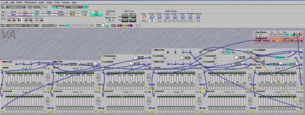

slot A
 Filesize:  226.65 KB
 Viewed:  2959 Time(s)
slot B
 Filesize:  92.88 KB
 Viewed:  2979 Time(s)
ScalaInterslot12.prf2
Attempts to use a scala (microtuning) patch on another slot
 Filename:  ScalaInterslot12.prf2
 Filesize:  7.48 KB
 Downloaded:  6246 Time(s)

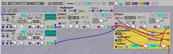

the G2 buss can only pass one signal value at a time
This is not the first time that the voice mode is causing me a headache. I've had a similar problem when I converted some NM1 patchs for the G2.
the G2 oscillators with an FM input can produce finer pitches in between this limit if you patch a pitch control signal into the FM input.
Thank you! I just tried and it works well. But this is a parameter that I automates all the time to vary the timbre (as in the screenshot, the wellow part) in my synth patchs. I need to dig to fit all this.
 Filesize:  54.98 KB
 Viewed:  3013 Time(s)
