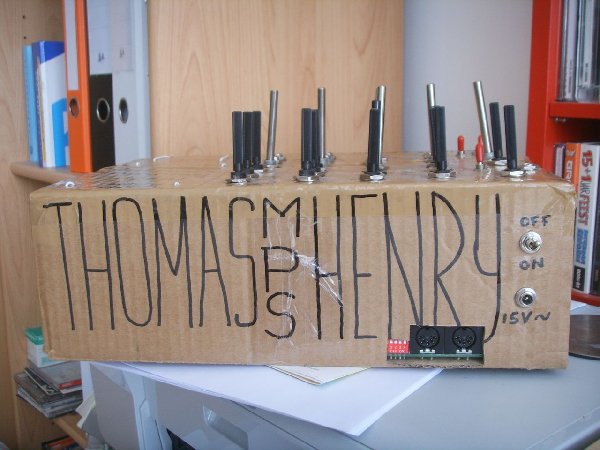

PostPosted: Sat Jul 24, 2010 4:00 am    Post subject: Reply with quote  Mark this post and the followings unread
Whoohoo cheers cheers cheers My trigger interface has come in and works (ordered it from http://www.engineersatwork.nl/catalo...roducts_id/536), made an extra switch behind the MPS input so I can trigger it via midi or trig-out from another device.
on the left of the photo you see the interface triggered by my AN1X thru midi, in the corner of the MPS the switch and on the right the DR-220E that triggers the MPS thru trig-out. Now I can finally search for a suitable case although I like this one as well. Smile
And put the print in the box, don't mind the tilted pots, that's because of the cardboard

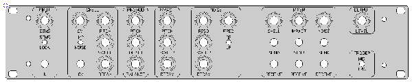

PostPosted: Sun Oct 10, 2010 6:13 am    Post subject: Reply with quote  Mark this post and the followings unread
And we've made some progress: the frontpanel is designed
See the attachement below
Right now I'm finding out where to buy the 19"rack but it'll be probably from this site http://www.modushop.biz/ecommerce/index_l2.php
And this set (Silver):
with this (mounting behind the front plate):
I'm thinking about doing the decals with waterslide decal, I'll order some today and see how it will look on a test piece (because you need to spray varnish over the decal and I don't know if it's going to be pretty on a rack)

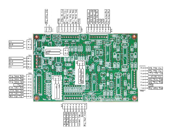

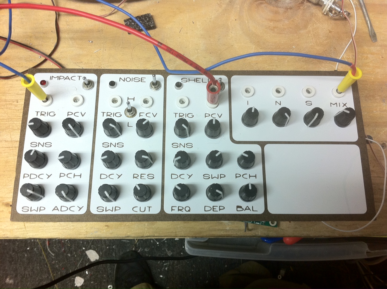

PostPosted: Tue Nov 09, 2010 7:12 pm    Post subject: Reply with quote  Mark this post and the followings unread
Fellow Chef's de le MPS: i need some help finishing up the MPS and i GREATLY appreciate any help.
Questions:
- I have two pots OSC1 LEV and NOISE in the shell section which i have no idea to wire out, same applies to the SEND/RECV and according SPST switch
- I have a wire which i don't know where to connect, in detail it is J17/6
Problems:
- Impact OSC Freq does not work, it's just a high pitch
- Noise RES has no effect.
Facts:
- It is creatorlars' panel version (see here)
- i used the MPS panel wiring from bugbrand mostly, but i have some issues and questions.
Pots wired / assignment
SHELL
OSC1 = RING FREQ
OSC1 LEV = ???
BALANCE = RING BAL
IMPACT= RING DEPTH
NOISE = ???
SWEEP = SWEEP
DECAY = DECAY
VC OSC2 = CV
OSC2 = PITCH
LEVEL = SHELL LEVEL
NOISE
VC CUTOFF=CV
CUTOFF= FILTER
RES = Q
SWEEP = SWEEP
DECAY = DECAY
LEVEL = NOISE LEVEL
IMPACT
SWEEP = SWEEP
DECAY = DECAY
OSC FREQ = PITCH
LEVEL = IMPACT LEVEL
MIX OUT = OUT

PostPosted: Thu Nov 11, 2010 3:24 pm    Post subject: Reply with quote  Mark this post and the followings unread
Hi, I don't have my notes or build in front of me, but I can offer some clues. One immediate suggestion: go to page 19 of the thread and check out hendrixworkshops' graphic which adds titles all the external connections on the board. This should help clarify from a board perspective what is directed where.
One problem you are going to have is that Bugbrand and Creatorlars both use slightly modified panels, which don't match each other. Bugbrand's wiring diagram is really useful, but can be misleading when you don't catch where he's modded something. (I had some difficulties at first too!)
Per the graphic mentioned above, this is "volume top", presumably the leftmost lug of the Mix Out pot if viewed from the rear. I think Bugbrand's layout only used the synth-level out, where creatorlars' looks like he only used the audio-level out. I think this also causes you some confusion below.
janvanvolt wrote:
IMPACT
MIX OUT = OUT
So just to confirm, MIX OUT <> OUT. Or at least not quite. Be sure to run your Out jack through the pot, unless you WANT synth level. In that case, Mix Out pot becomes redundant, as does 17/6.
janvanvolt wrote:
SHELL
OSC1 = RING FREQ
OSC1 LEV = ???
BALANCE = RING BAL
IMPACT= RING DEPTH
NOISE = ???
Osc1 Lev is probably Ring Depth.
Impact and Noise -- I believe these are pots to control the level of CV to the Shell Osc (Osc2?) from the Impact and Noise sections. In the Thomas Henry design, you select whether to send impact or noise CV to the Shell with a SPDT, and you use the switch on a 1/4" jack to disconnect either when you patch an external CV in. It appears Creatorlars allows for simultaneous impact, noise and external CV, each at their own variable level, since banana jacks don't have switching functionality. (I don't know whether high simultaneous levels from all three CV sources would cause any problems to the circuit.)
Note that Bugbrand instead uses a DPDT configured such that you switch between all three inputs (impact, noise, or ext CV) to a single pot.
So:
OSC1 = RING FREQ
OSC1 LEV = RING DEPTH
BALANCE = RING BAL
IMPACT= (Impact CV portion of Bug's DPDT switch)
NOISE = (Noise CV portion of Bug's DPDT swtich)
Creatorlars Send/Receive jacks appear to send the impact portion of the signal (or maybe the whole signal?) out prior to the Mix pot. (See TH's MPS block diagram Send/Rcv Loops section for details.) The switch above there should interrupt the signal before it hits the MPS mixer. That way you aren't sending both the internal Impact signal AND and externally-processed Impact signal simultaneously.
Finally, take a moment with the graphics from hendrixworkshop, Bugbrand, Creatorlars, and finally of course, the MPS block diagram (and schematics) and when the diagrams disagree, figure out why -- this will lead you to some changes. You should especially rethink your wiring on Bugbrands' switches, because apart from the Noise Filter switch, I think all of Creatorlars' switches (or lack thereof) will be different.
I'm sure that a little rewiring will fix some of your audio issues. Very Happy

What would be helpful to have the original jumper descriptions which correspond to the original MPS PCB and neither the lars or bugbrand version. Somehow i only got the 4 page pdf stuff.
I don't know if you found that hendrixworkshop pdf, but now that I'm on my home computer I can repost for you. It wasn't included in the official docs, it's just something somebody helpful put together!
Glad to hear things are starting to come together for you. I am in the middle of repaneling mine and fixing the last couple inconsistencies between the Bugbrand scheme and my own panel.
-Jim
Layout doc describing wiring from PCB.
