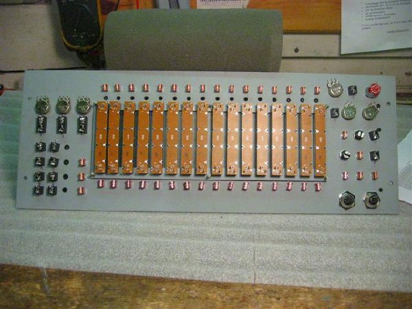

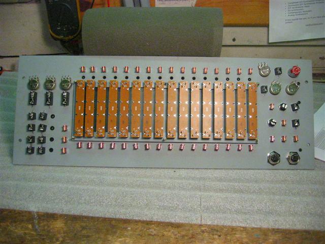

I started my Klee mid last year....June or so Sad Life got in the way...or something.
didn't buy the EM boards as i already had started a vero version.
Dug it out this week, must be time to finish it.
I took a few shortcuts -
the clock and load momentary switches are wired to the clock and load jack switches. As i understand it, it means i cannot use the momentaries when a clock or load signal is patched in.
The clock jack runs via the normally closed(H) hold switch.
left out the gate/trigger circuitry, just have 16 buffer/LEDs/gates running from the 4034s, similar to those in Ken Stone" Gated Comparator (that is the smaller board on the left).
also the level select is simply a 9v regulator and diodes wired in series on the rotary switch, or external input.
the panel is the cover off a dead PC, switches, knobs, stick-on labels, pots all came out of the dumpster behind the Physics dept. at uni.
LEDs and jacks are new though.... Wink

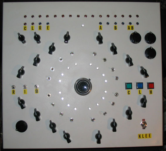

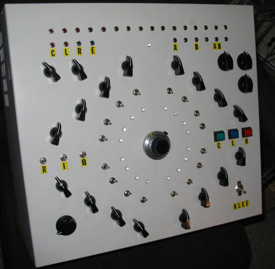

I played around with many different panel designs, gotta say thanks to EdisonRex, the panel you posted in this thread was inspiring.
Of course Thanks to Scott, Uncle Kr. and EM for putting out this design.

PostPosted: Thu Jan 17, 2008 8:08 am    Post subject: Reply with quote  Mark this post and the followings unread
cheers
its a bit minimalist.....i did have some plans to splash paint all over it but the paint tasted funny
Anyway, hope the cct works, no doubt there will be a few things i have forgotten

PostPosted: Mon Jan 21, 2008 8:00 pm    Post subject:   Reply with quote  Mark this post and the followings unread
yay worked 1st time, mostly. i think?, its a strange 'un! better read the user's manual.
guess i should mount the boards somewhere better than a notebook.
obligatory spaghetti picture -

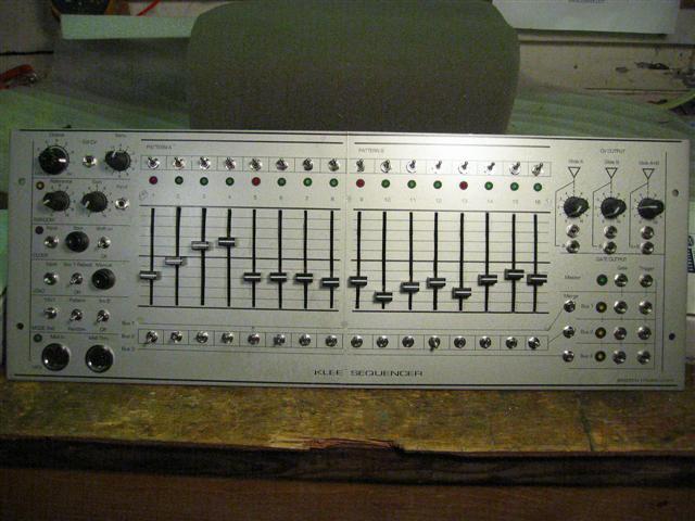

Here's my Klee front panel finally done. I had a lot of trouble with the Lazertran process I am using and had to clean it off twice and repaint, Lazertran is finicky and while I've got he knack for smaller projects, this is the first large one I've done and it was problematic. The final panel has blemishes here and there, but I could'nt wait any longer. I went with the 60mm sliders and I think you can see bits and pieces of every other Klee front panel in the design, thanks guys, you know who you are.

Alienation
Joined: Jul 23, 2007
Posts: 47
Location: Midsouth
PostPosted: Sun Jan 27, 2008 9:21 am    Post subject: Reply with quote  Mark this post and the followings unread
That's a very nice job on the panel. Cool
The lazertran is a nice way of labelling, I have been considering similar labelling for mine.
Did you do all the metal work?
Again, Nice job.

PostPosted: Sun Jan 27, 2008 10:40 am    Post subject: Reply with quote  Mark this post and the followings unread
Thanks, it was a lot of work. I did all the metal work, I have a drill press, and for the slots I used a 4.5 inch grinder, with a 1/16 disc, mounted in a stand which I then plunged into the secured metal, a bit of filling on the ends to square up and the slots where done.
Lazertran can be a pain. I print it reverse, put it toner down on the metal, then bake it in the oven. It has mixed results, and while the photo does not show it, there are large areas of blemishes on my panel where the Lazertran did not change properly with the heat.

PostPosted: Sun Jan 27, 2008 5:42 pm    Post subject: Reply with quote  Mark this post and the followings unread
Great panel!! - I was wondering about cutting slots for sliders with a grinder, so thanks for explaining the method, from the pic they look very straight.
(there is a box of 250 slider pots in my cupboard).
Lazertran - never worked for me, was like trying to unravel a spider web without breaking it Mad

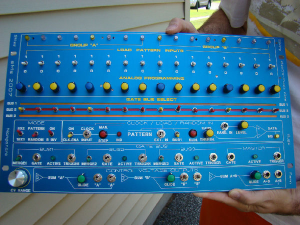

PostPosted: Fri Feb 01, 2008 5:38 pm    Post subject: Reply with quote  Mark this post and the followings unread
George, just dropped in to take a peek at the panels ... really nice job. I love it. I really like the slider based panels that have been done Cool
I should really post my Klee panel here also .....

PostPosted: Sat Feb 02, 2008 8:08 am    Post subject: Reply with quote  Mark this post and the followings unread
Wow... and what's all that other cool stuff in the racks? Wink

PostPosted: Sat Feb 02, 2008 9:17 am    Post subject: Reply with quote  Mark this post and the followings unread
Yeah, lots O' colors.
Tell us about your stuff, I see Blacet and Wiard represented. What's above the Klee and below it.
PM if you need to to keep the thread straight. Wink
