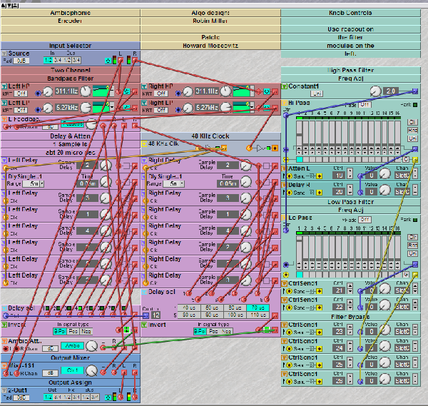

After a lot of experimenting, I'm posting a pretty deluxe RACE ambiophonic encoder realized on the G2.
See: http://electro-music.com/forum/topic-25669.html

The deluxe part is you can set the delay in 10 microsec increments from 40 to 110 usec. You can adjust with knobs the filter settings, the feedback, ambio attenuator, and I/O pads. Makes experimenting pretty easy. Not all that is essential, but I get obsessive sometimes, like everyone else around here...
Screen shot
 Filesize:  331.36 KB
 Viewed:  899 Time(s)

Well mine looks rather simple by comparison. Guess I'm going to have to add some knobbies Laughing
 Filesize:  13.14 KB
 Viewed:  34765 Time(s)

I find that delay line attenuator a very important thing to be able to adjust. The more of the delay the wider the stage but there are some timbre distortion. That knob might be better labeled width. With wide stages you can tweak the feedback knob and it can reduce the timbre distortion.
Adjusting the filters changes things too, but 300 - 5000 with 6 Db/8va seems to make things sound best. Apparently, those are the freqs where ITD works best. If one has full range speakers, it doesn't make sense to feed them out of phase signals. Robin has really thought this out, but I'm sure he'd admit there are many things to discover.

The filter's in my implementation are 12dB/8ve so that gives me an excuse to a button Wink I too have found that one needs to play around to find the settings that minimize "artifacts." To my ear the Carver C9 is virtually free of such, at least compared to my Ambi encoder. Not sure what to make of that.
