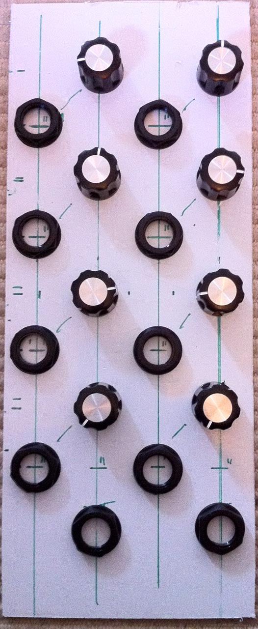

I'm now wondering how to do a 5U for this, If I do standard MOTM 1U, I'll have nowhere to put the extra socket, and it seems a little wasteful to use a 2U panel just to accommodate 1 extra socket. I may have to use smaller rotary knobs and place the sockets next to each of those
Any other 5U guys out there building this?
I've got 2 on the way, so I'm planning to squeeze 2 rows of 5 sockets on a 2U panel (You can just get away with this using Switchcraft jacks) for the both of them on one panel.

PostPosted: Fri Oct 29, 2010 12:23 pm    Post subject: Reply with quote  Mark this post and the followings unread
magman wrote:
Regards
Magman
Pretty much what I started planning (interestingly before even reading this), although I chose smaller knobs for this, as you will see in my example (even though I have not yet received the boards yet).
