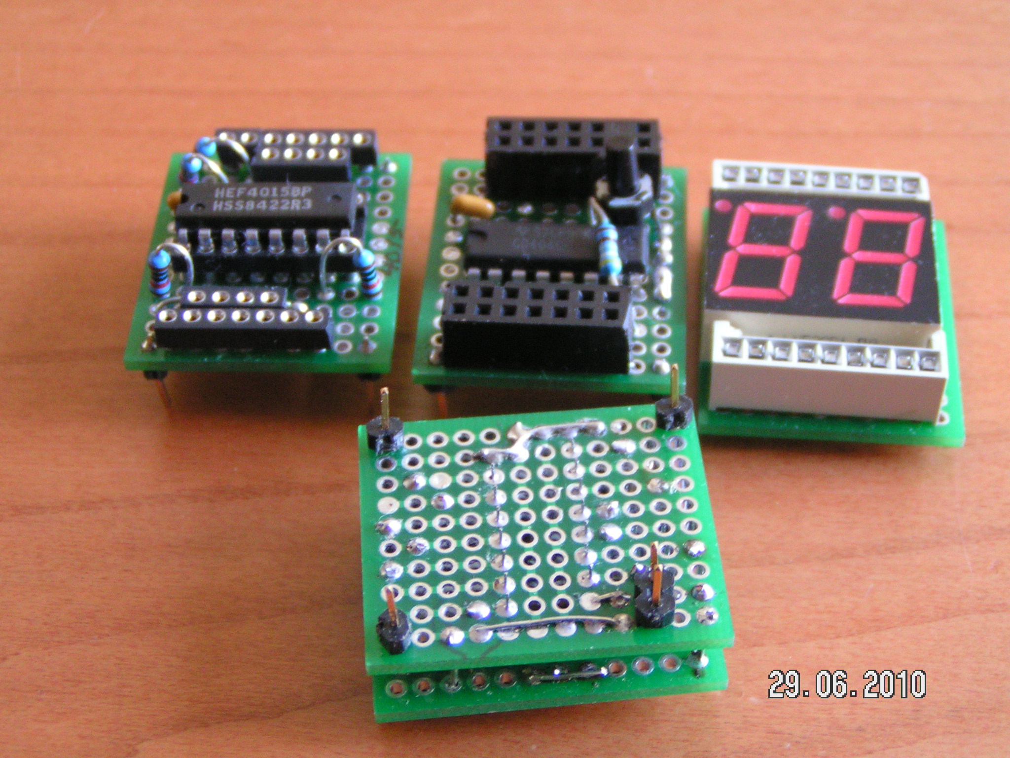

Stackable male headerpins. Good idea! Some of my modules have triple outputs and still I want more.
some remarks: I've used three versions of female in/outs on my Lunetta.
1: those that come on a strip that can be cut to size, looking like yours.However, when these were cut and plastic fractured sometimes, the inside metal bit was a fork like pinching system that needs the plastic support.
These were rather expensive (at the local store) so I started using:
2: cut up IC sockets that I have. I used the big ones for IC's I'm not using anyway (for processors and such).
3: Old computer flatcable connectors (look the same as your females, but are a double row). Nice and cheap (made from free cables that is), and a bit of work I happen to enjoy.
When the flatcable is removed the connectors have these small fork like little pinchers that pierce through the flatcable to make a solderless connection. These are a bit too close for circuitboard spacing, so I had to bend them a bit. Also, they are a bit short, so barely pass through the PCB. But so far I've managed to get good solderjoints. I think the double row looks better than two single soldered together.
Those stackable cable headerbits you have used actually look like the pins you get when you break away too much plastic when cutting up machined IC sockets. Now I cut these up a pin larger then I want, because they break easily.
I've actually kept the loose pins I got this way, I sorta felt those could come in handy for some purpose Very Happy .

PostPosted: Tue Jun 29, 2010 6:57 am    Post subject:
Subject description: improvising parts
Some of my improvised female in/out's.
Top row L-R :
Cut IC sockets , Flatcable connector , cut up LED display socket (used as a " LED bank")
Below: 4017-4051 Melody Generator module ( stacked to fit my plug-in module concept)

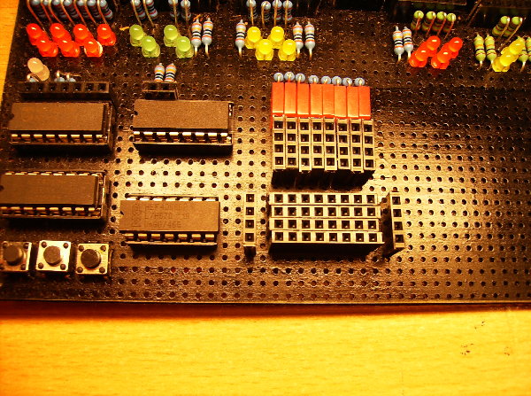

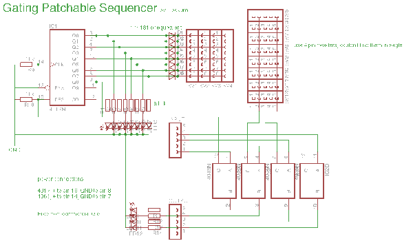

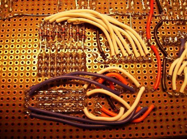

PostPosted: Sat Jul 17, 2010 2:56 am    Post subject: Reply with quote  Mark this post and the followings unread
Time for another update!
The sun has been pretty relentless here and couldn't get anything done the last 2 weeks. Although I couldn't do any soldering I did design my first ever module to have the center space on my board. I posted a question over at the deathlehem forum about a sequencer where you can plug in any sound and have it sequenced. With great help from Rfeng and mr Rykhaard it started to take shape very quickly and my first lunetta design was done before I knew it.
Ive called it the Gating Patchable Sequencer(GPS) and it uses just 2 IC's, the 4017 and the 4066. The 4017 is set up just like a baby8 and uses an external clock and/or reset signal, the 8 steps get routed to some led's and a 8x4 header patchbay with diodes to prevent feedback. The 4066 takes it's 4 control signals from a 4x8 patchbay to switch(gate) the 4 inputs and outputs. It's all very basic stuff and really idiotproof to build but with a lot of rythmic potential with a total of 32 possibility's and you can use anything as a sound input(circuit bend stuff, gates, oscilators) and have it sequenced on the output. It is fully functional but Im having some grounding issues in the patchbays so the schematic will be altered to a final version.
pictures!
copperside, getting more and more complex with every module
 Filesize:  2.04 MB
 Viewed:  444 Time(s)
topside, up/down, left to right: Pulldownresistors, LED's, 4017 output bay 8x4, sound input 1x4, control input 4x8, sound output 1x4
 Filesize:  2.12 MB
 Viewed:  469 Time(s)
tested and works, but still have groundingissues so wait for 2.0

Sad this forum is getting very quiet....
I have redrawn the entire schematic, and it's fully tested and working now.
Feel free to ask questions.
