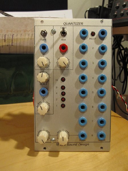

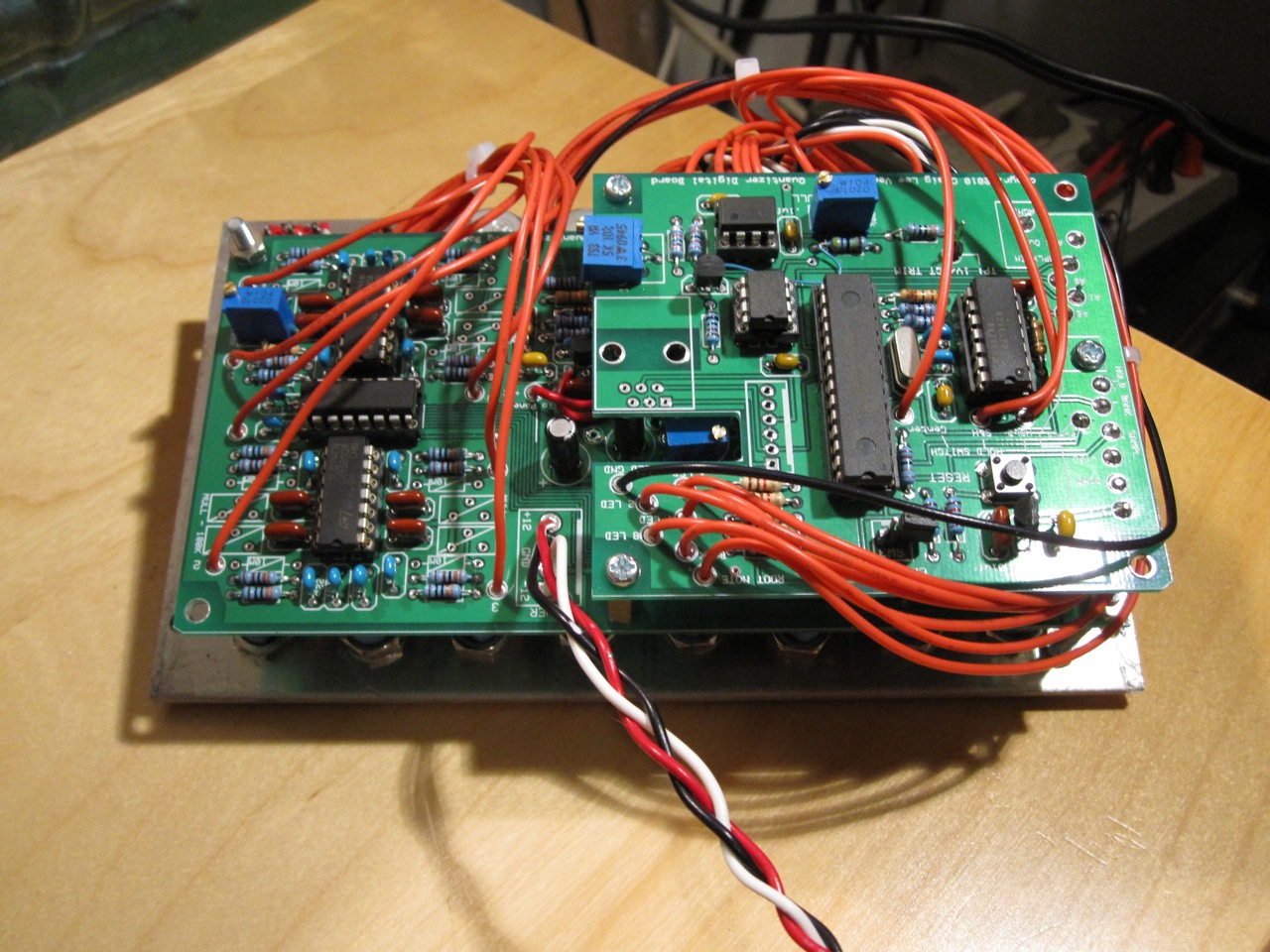

My Quantizer is up and running. I still have a few software tweeks, but the module works.
8 channels, VC scale selection (about 30 scales in 2 banks), hold mode or sample and hold mode.

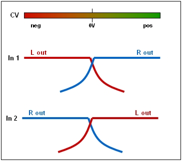

what do you mean by "equal power"? my english is not that good, especially when it comes to technical terms. Embarassed
anyways, each channel stays at unity gain for negative, resp. positive positive voltages and fades/pans when it becomes positive, resp. negative. the response is log by ssm2164 default. (see graph below)

Sorry about that fonik, actually your English is very good!
Equal power refers to the fact that when crossfading 2 signals, or panning one, the apparent volume has no dip, or reduction, in the center. If you were crossfading a signal with itself there would be no level change as you crossfade. My understanding is that equal power crossfaders use an exponential response.
awesome,what pcb's kits are these?

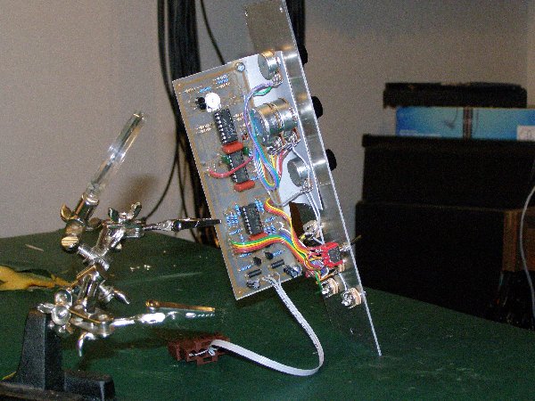

PostPosted: Sun Jan 30, 2011 4:26 pm    Post subject: A new Yusynth Quadrature VC LFO Reply with quote  Mark this post and the followings unread

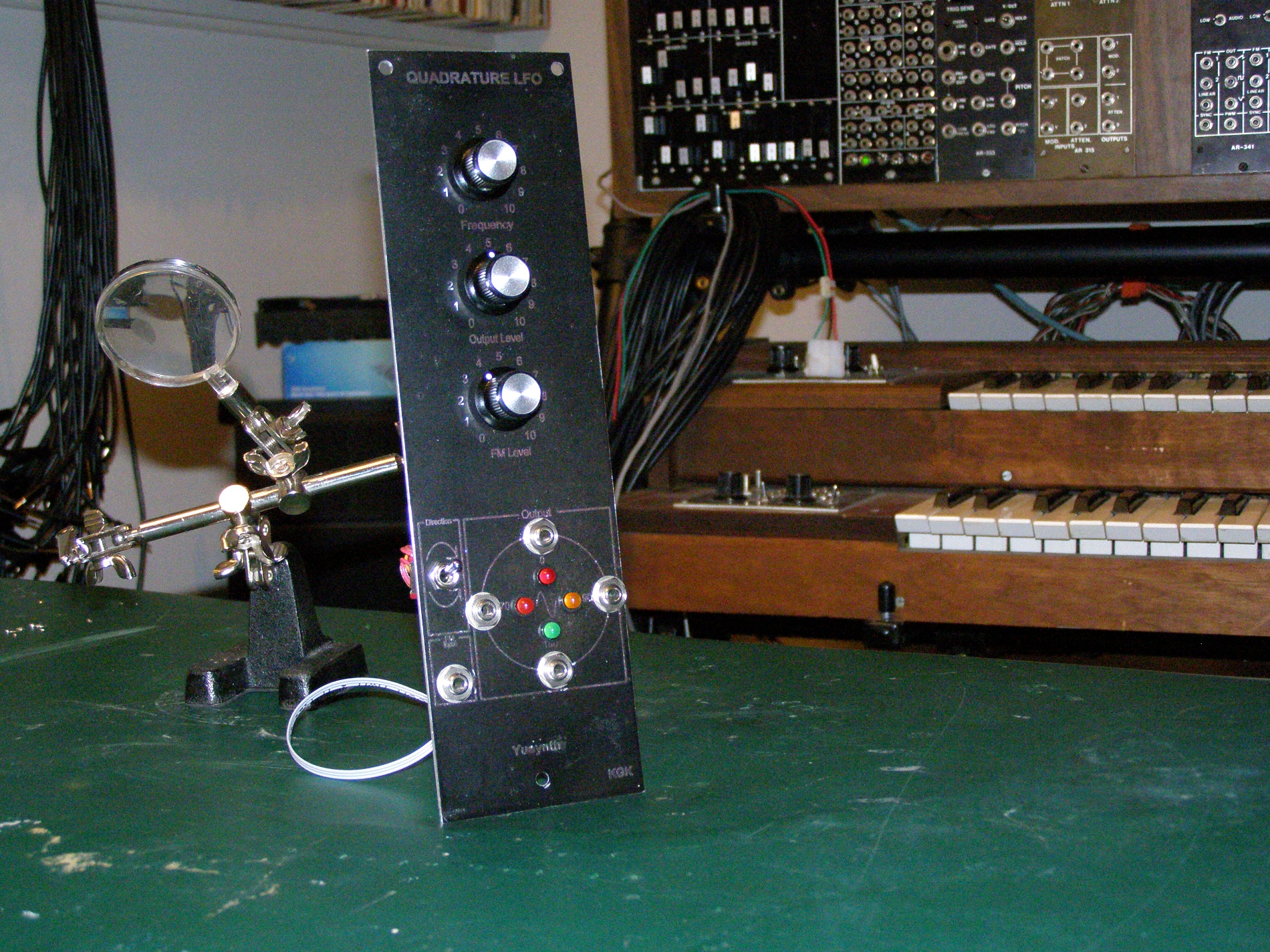

Had some time to build this weekend.
I populated the 2nd new cabinet and reorganized the keyboard rack.
Also completed a Yusynth Quadrature VC LFO module.
Five (3" each) module spaces remain in the new cabinet (which is on the top row).
This LFO produce a sine wave that is split into four outputs each shifted 90 degree from the adjoining output. The LEDs and the output jacks are arranged in a circle to represent the functionality of this module.
 Filesize:  1.78 MB
 Viewed:  353 Time(s)
View of the pcb and wiring.
 Filesize:  1.7 MB
 Viewed:  356 Time(s)

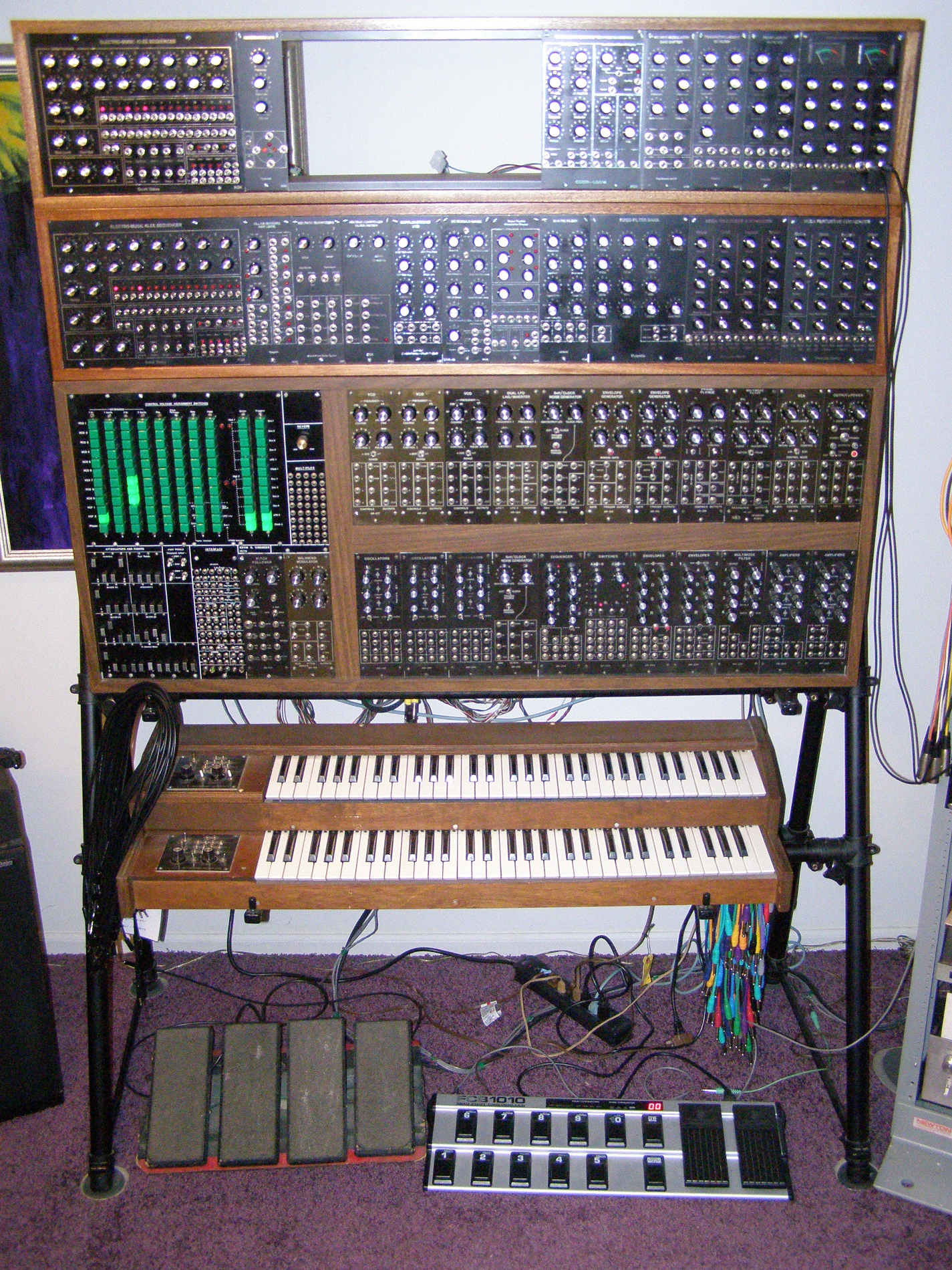

View of the synthesizer as of 01-30-2011 with the newly-built Quadrature VC LFO in the top cabinet.

wow,its getting big Very Happy
Posts: 1451
PostPosted: Mon Jan 31, 2011 12:48 pm    Post subject: Reply with quote  Mark this post and the followings unread
I didn't expect to complete as much as I have over the last 12 months. When I decided to order two new cabinets (a friend built them for me) I wanted to have some room for expansion and was present to the idea that to order two cabinets was overkill.
With all the new voltage-controlled modules the need for more LFO's has surfaced so I expect to build some LFOs in the near future.
I will soon run out of cabinet space though I have two 11-module cabinets available. I really don't need to take up more space however I really like to build so I will probably just build some more and add more cabinets. My parts stock is pretty rich so I can do quite a bit of building.
Lots of beautiful work in this thread. Before 2010 I hadn't done much outside of kit-building however the build threads and the DIY section beckoned. Kits are fun however to be able to "build from scratch" is very gratifying. It is fun to see a module that I like and just decide to build it.

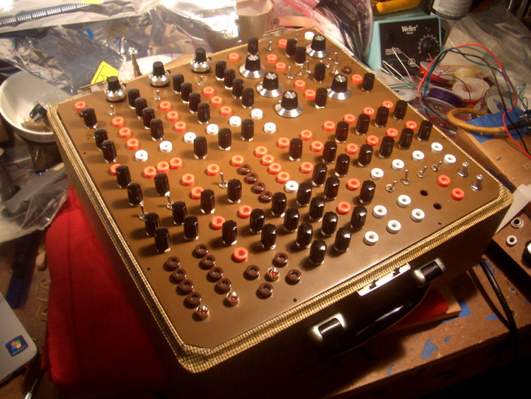

Compact Synthi in a box
Living VCOs, JH 36dB Filter w/ the LFO, CGS LFOs, VCS, Buchla 208 random, mix, Sergey Wave Multipliers, Quad VCA with VC Mixing.
So far, capable of tremendous range. Cant see it becoming boring, ever.

That's not loading for me...would love to see what you've done there.
I'm eventually going to do something similar with the JH Living VCO, a couple JH Trapezoids and one of the diode filters from Yusynth plus some ring mod and noise and mixing stuff...plus dual joysticks. Haven't spec'd it all out yet. Thinking of doing it as a stand alone synth for mainly SFX type stuff.

great work. is it housed in an old portable phono player case?

Typewriter case, has a removable lid. Perfect depth for 2 layers of boards where needed and a big PSU.
Working on a matching companion with loads of Fritz stuff.
