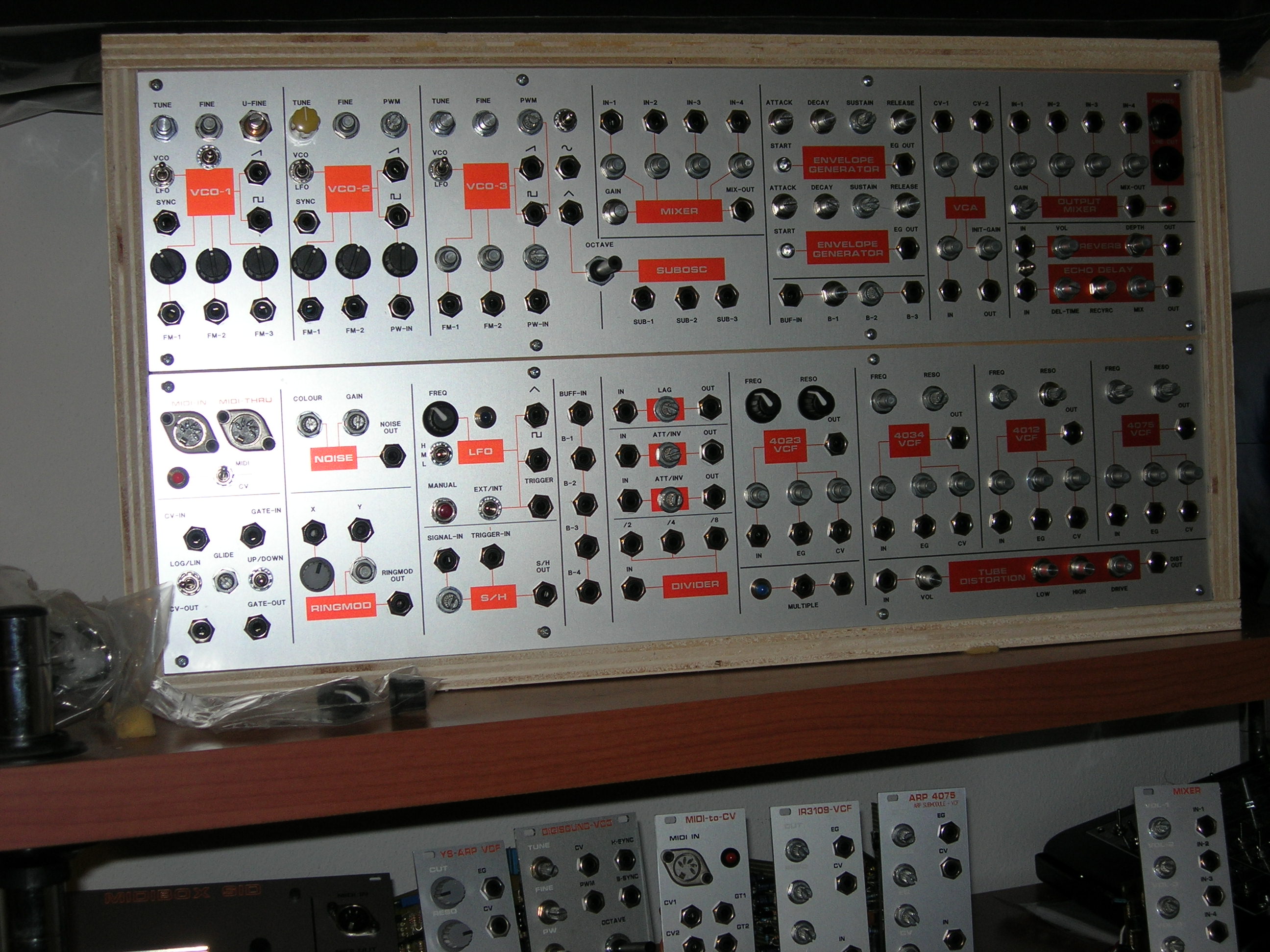

midi arp2600 clone with some genuine original arp submodule inside
1 x arp 4027
1 x arp 4034
1 x arp 4074
1 x arp 4012
the other circuiteries are cloned by original arp schematics
plus a belton reverb section , a og2 delay module section, and a real tube
distortion section.

Oooooo. I love the 2600. Somewhere down the road I want to build a 2600 clone as well, nice work.

wow very nice those arp panels

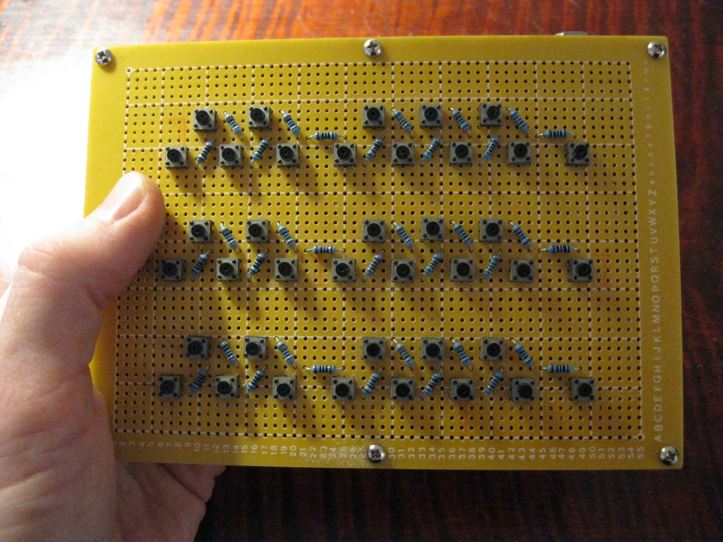

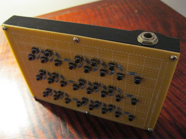

Here is a "just for fun" project. My brother gave me a literal bucket full of tiny momentary switches someone was tossing out, and i wanted to do something with them. It's a 3 octave single buss keyboard using Ray Wilson's design. The lowest octave is the bottom row, highest on top, with the two middle "C" notes appearing twice. Inside the box is just the switch/100r resistor part, it connects to the "brain" part with a TRS 1/4" cable. Ultimately i want to use it in a pre patched synth with an Acoupel CV recorder/sequencer as a remote control for programming sequences, and for directly playing in a twitchy/video game button mashing kind of way. I was a little bit worried that it would have issues with glitchy triggering, but it works great!

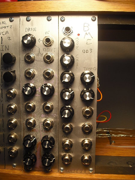

My arpeggiator prototype. Controls are (left to right, from top left):
-Reset (goes to root note and restarts clock)
-Movement (Up/down, up repeating, down repeating, pendulum, up non-repeating, down non-repeating, random)
-Chord to arpeggiate(Major, Minor, Major 7, Minor 7, Maj 7 w/o 5th, Min 7 w/o 5, 1 + 5, Octaves)
-Range (Selects between 1 and 5 octaves)
-Tempo
-PWM for the gate out
-Tempo modulator attenuator
-PWM modulator attenuator
-Tempo mod in
-PWM mod in
-Gate out
-Trigger out
-CV in
-CV out
 Filesize:  1.04 MB
 Viewed:  232 Time(s)
dougseidel
Joined: Feb 10, 2010
Posts: 74
Location: NJ
PostPosted: Wed Mar 02, 2011 8:09 am    Post subject: Reply with quote  Mark this post and the followings unread
Boogdish: I like the labels on this- do you etch right into those panels?

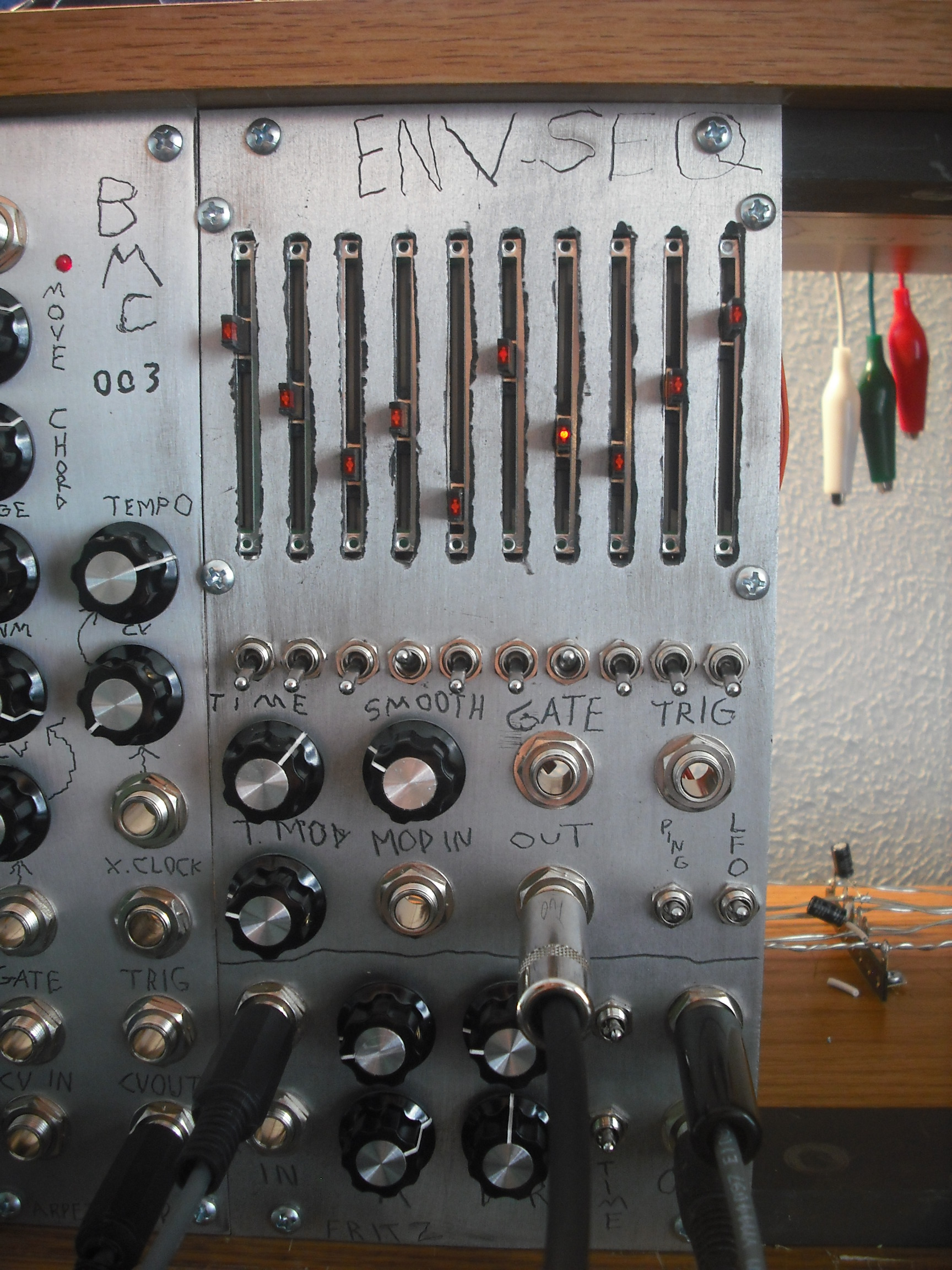

I finished two in a week! It's amazing what you can accomplish when you shun society!
It's a sequencer specialized for use as an EG. When fed a trigger, it goes through the sequence once, when fed a gate it will loop between points set by the switches below while the get is held down so you can get LFO-ish sustains.
Smooth control is your basic glide/portamento to make it less clicky, I made it variable as different amounts of smoothness will be needed at different speeds.
Time controls how fast it runs through the sequence, with an input and attenuator for external CV control.
Switches engage ping-pong mode for the loops and LFO simulates a gate permanently on.
On the bottom are two of Ian Fritz AR/AD circuits for when all that other stuff gets too complicated.

Oh, I meant to respond to Doug's comment in that last post but forgot. Thanks for the kind words, gents.
I engrave with a dremel, then spray paint black and sand off the excess spray paint, which also shines up the rest of the surface a bit. I'm still working on my engraving technique, I wish I had more control than I do now.
Also, I made a little video showing the ENV-SEQ. I apologize in advance for my crap camera work.

Boogdish, super cool envelope rig, i was thinking it was a 4017 sequencer (10 steps and all) except the forward/backward capability makes me think it's not, is it done with a pic, or...? Cool idea!

It's two chips, a 16F913 PIC and a quad op amp being used as an output buffer and voltage summer/limiter of the time CV. I'm sure it could be done using standard CMOS chips, but for me, it's easier to figure it out with a PIC.
I'm thinking about starting over with it and have the PIC read the values of the pots then output with the PWM or a standalone DAC. That way the PIC could do the filtering of between step voltages and have smoother transitions. I think I'd also have try having separate time controls for A/S/R.
