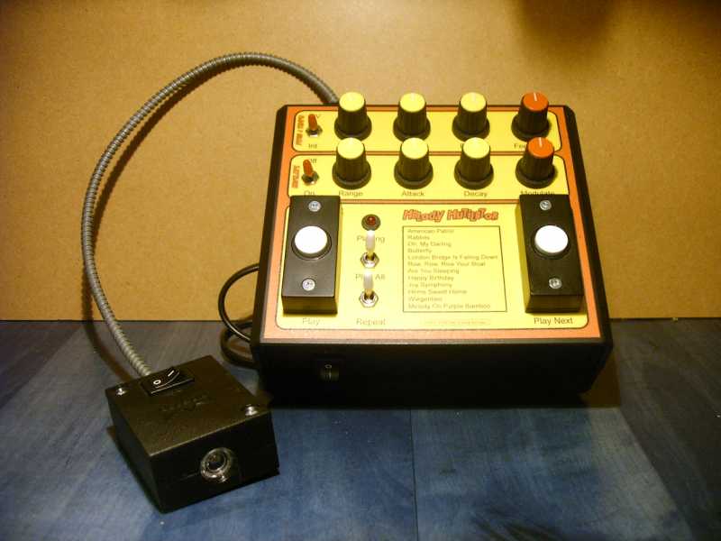

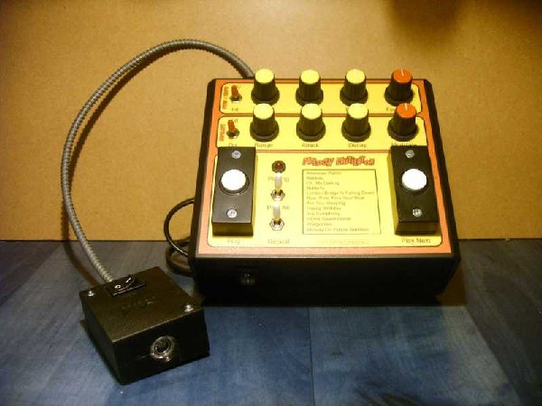

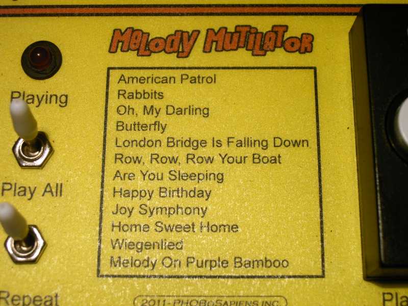

here's something else I recently build; The Melody Mutilator.
Based around a UM3482A melody chip that is meant for doorbells.
It's pretty much the basic example circuit from the datasheet but I
made a lot of things controllable, added a feedback control (from
output to CLK oscillator) and a CV input for the speed, which can
also be controlled with an LDR, that's what the extra box is for.
It can produce droney sounds, noise and things in between. Cool
some more photos can be found here

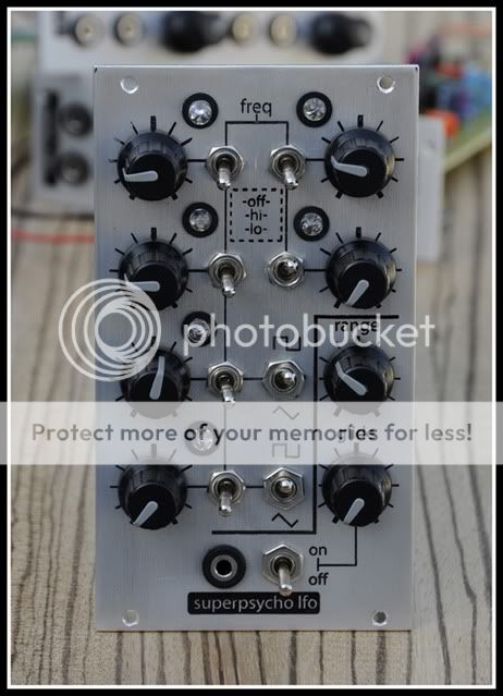

It's growing !!!
Ken Stone PsychoLFO
Yusynth S&H + Noise
MFOS Dual VCA

Nice looking panels!

Very nice. Some of the best looking modules I've seen in that format. Very clean, classy and functional. thumb up

Phobos! You always make the coolest shit! Very inspiring. I'm still trying to wrap my head around how to build one of those predictive synths Smile. Is your spring thing hooked up to contact mics? what's it do?

Okay, you can't show us something like that and not give us some sound samples!

@Kupfer: VERY nicely done! What are the modules on the first row?

Lovely little box,colorfull, i like it!

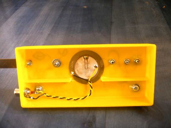

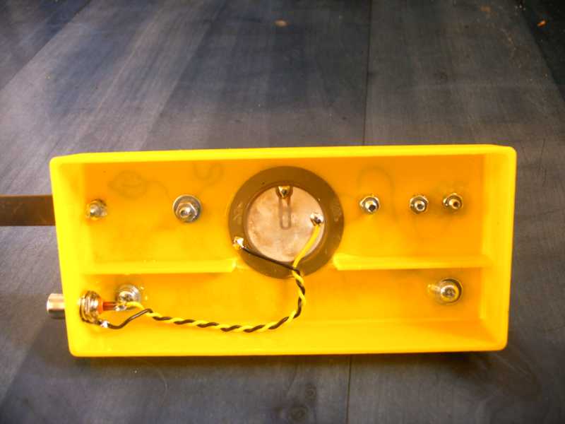

And yes the spring board has a contact mic, which is nothing more than a 35mm piezo disc. Wait, I make picture for you Wink (will end up at the bottom as an attachment). I came across some of my notes on the predictive synth, so I might be able to draw up a schematic (If I can find some time in between building other things)

Ok, I recorded something for you, first demo starts with the envelope controls, than I add the pitch controls and at about 7.00 minutes I start using the feedback control (that's where the real fun begins).
The 2nd demo uses a sequencer for the CV control (too bad I can't use the feedback together with it)
Thank you, I finally have some colored knobs now Very Happy
Inside look of the mini springboard

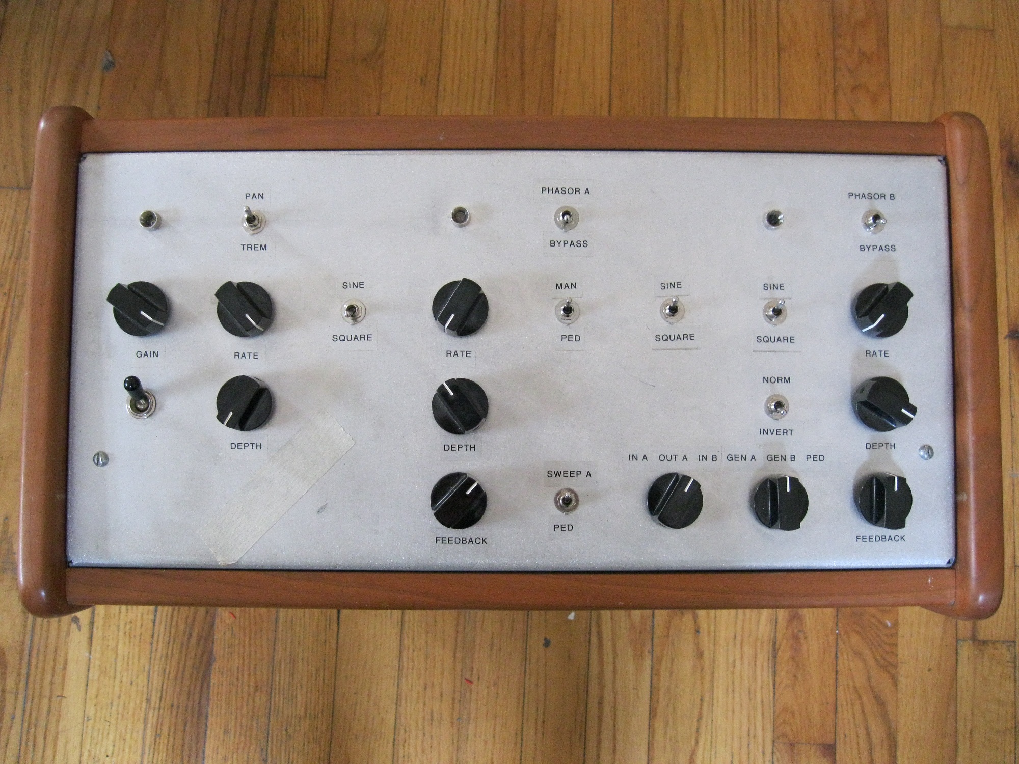

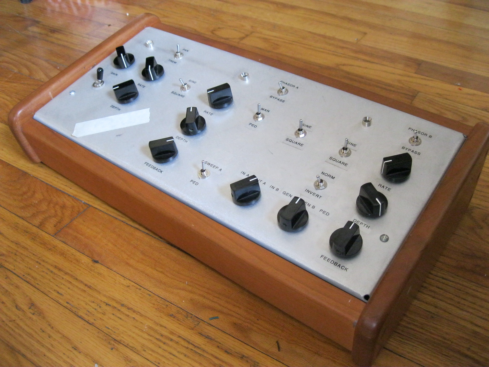

Here is a tremolo/panner + mutron bi-phase clone i built for a friend a little bit ago, back for a footswitch and a chance to take pictures.
The trem/panner is based on the MFOS circuit, but with an OTA sine shaper set up to distort a triangle into an almost square, but with sloping edges and rounded corners, we experimented a lot and felt the happiest about the way the panning sounded with that wave.
I borrowed a real bi-phase to compare the phaser to and the clone sounds awfully good. If it was for me i would add an "initial" knob, switches for number of phase and feedback stages, a more "modular" approach to the LFOs and a switch for inverted or normal feedback, but he wanted it set up just like the original. The bi-phase schematic is from Marc Bareilles site.
(i'm not sure what the piece of tape is for)

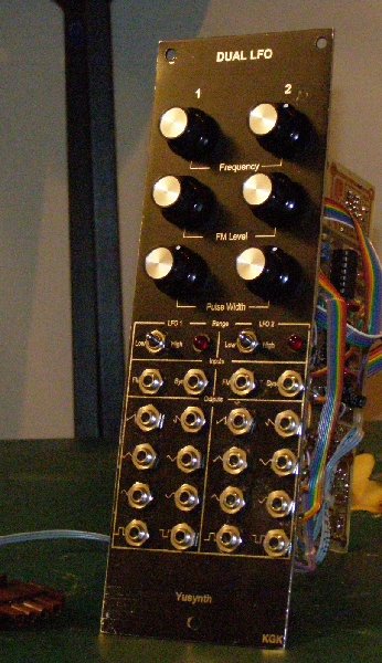

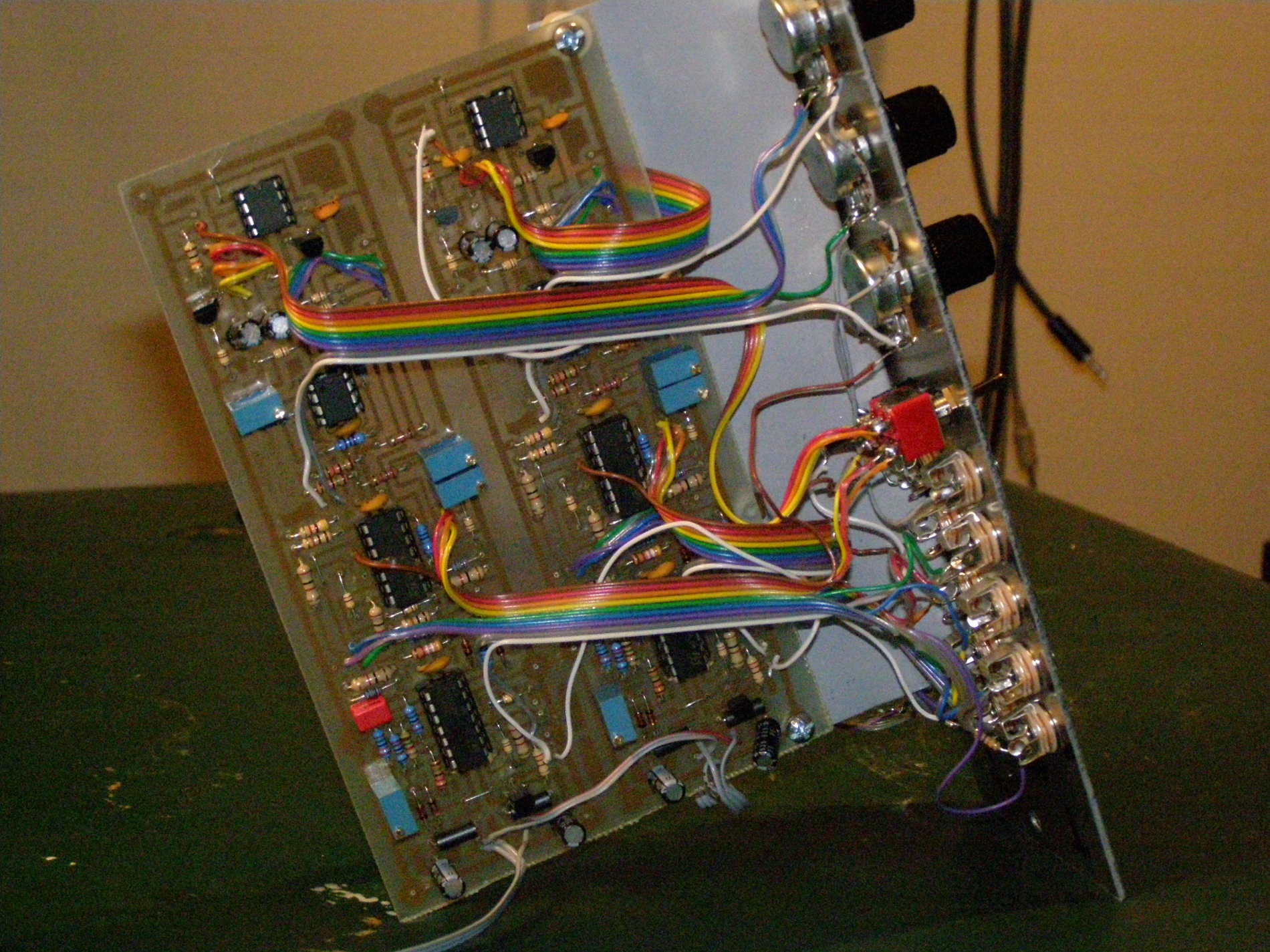

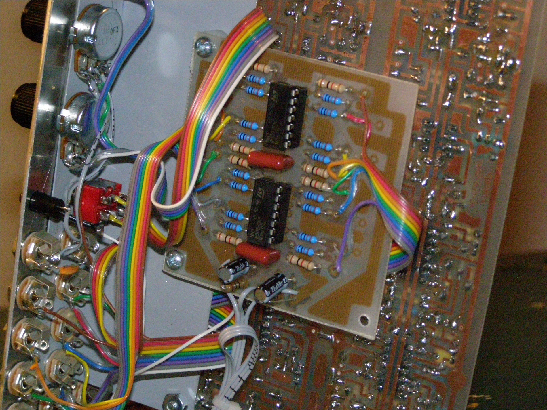

The Yusynth LFO has so many on-board features that Yves proposes two configurations. Both feature voltage-controlled FM and four (sawtooth, triangle, sine, pulse) outputs. Option one adds a rotary switch that selects one of the output waveforms and routes it to an inverter. Option two adds a panel-mounted Pulse Width control and a sync input.
Since all these are useful functions, I decided to design a configuration that allows all of the features. I discovered that there was not room for both a Pulse Width pot and the Rotary switch.
My solution was to build option two and to add a hex inverter board, route all the waveforms through inverters, and bring them out to output jacks. Thus, each LFO has eight outputs. In other words, there was room for additional output jacks but not room for another knob.
I look forward to putting this module to use!
The front panel. A redo (strip and relable) is on my do-list now -- I managed to scuff it a bit. A DIYr's work is never done!
 Filesize:  670.7 KB

The PCB with the two LFO circuits.

The Hex Inverter PCB (designed with Eagle)

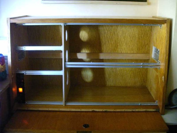

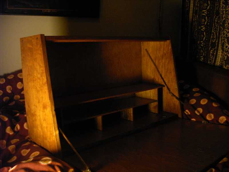

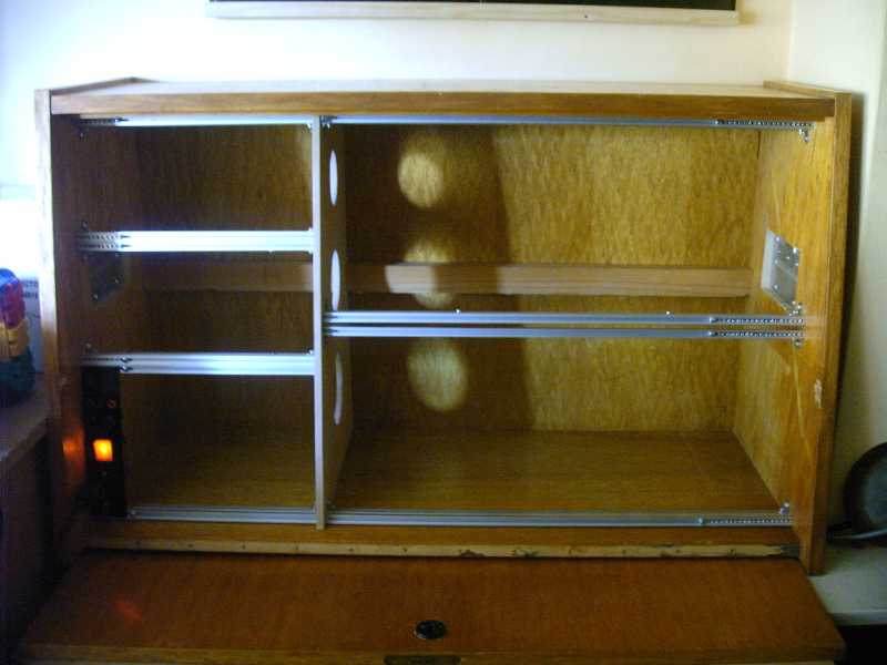

If we're posting first modulars I can join in Smile
I just turned an old writing desk (don't know if there's a better name for
this kind of thing) into a modular synth cabinet. The left space has a 6U
width and can hold two rows of 3U and 1 row of 4U panels. The right space
has a 12U width and two rows for 5U panels.
Also made the first panel which is for the power supply. I'll take a close up
once I've finished the PSU.

those mounting rails you re using, are they for M3 screws?
Posts: 5881
PostPosted: Mon Apr 25, 2011 8:42 am    Post subject: Reply with quote  Mark this post and the followings unread
yes, they are.

PostPosted: Mon Apr 25, 2011 9:36 am    Post subject: Re: New Yusynth LFOs in a Dual configuration Reply with quote  Mark this post and the followings unread
kkissinger wrote:
The Yusynth LFO has so many on-board features that Yves proposes two configurations...Since all these are useful functions, I decided to design a configuration that allows all of the features.
Excellent. I've looked at that one and thought the same thing.
But I haven't gone crazy and started etching my own PCBs yet, and this one's not available commercially. Sad
I think I'd add the PWM jacks and reduce the outputs to one per waveform...then use a DP4T switch to select the Inverted/Non-inverted output, like this:
POS LFO1 LFO2
1 + +
2 - +
3 + -
4 - -
Not as flexible as a + and - output for each waveform, but more panel friendly. I'm not sure how many times I'd want both the + and - from one LFO at the same time, though I suppose there would be times...hmm....
Posts: 1452
PostPosted: Mon Apr 25, 2011 10:51 am    Post subject: Re: New Yusynth LFOs in a Dual configuration Reply with quote  Mark this post and the followings unread
emdot_ambient wrote:
I think I'd add the PWM jacks...
Note that the module doesn't have an out-of-the-box PWM voltage input and that it pads the input to U2c down to (approximately) -6.5 to +6.5v (I haven't measured the value so I'm making a guestimate here).
You could substitue a Jack for the pot however you'd need to pad the voltage so as not to exceed the maximums.
I'd probably just grab a TL072 and build an inverting summer followed by an inverter -- thus, I'd be able to mix the voltages from the pot and a jack while adjusting the feedback resistor(s) for an appropriate gain.
Of course, there would be the temptation to add an attenuator pot for the PWM input voltage and then there would be a ton of knobs!
I actually pondered this a decided that such an application (to use a voltage-controlled duty-cycle) is so rare that I'd just use one of my VCO's in the sub-audio range to do this.
LOL -- I etch my own because I find it easier than to wire up components on pegboard! You sound like a future-PCB-etcher. And, hey -- you are doing sDIY -- the crazy train has already left the station! Very Happy
One thing I'm interested in is to route the pulse output and the inverted output to two VCO's. As I vary the Pulse Width, I should get an effect where the top (and bottom) pitches bounce between the VCOs. Will be handy for VCA cross-fading (using slews) and switching.
Sometimes I add modules/features with very specific applications in mind, other times I add stuff when I have the panel space. Sometimes, the things that I "just add for the heck of it" turn out to be very useful.

PostPosted: Mon Apr 25, 2011 3:28 pm    Post subject: Re: New Yusynth LFOs in a Dual configuration Reply with quote  Mark this post and the followings unread
kkissinger wrote:
...You sound like a future-PCB-etcher. And, hey -- you are doing sDIY -- the crazy train has already left the station! Very Happy
**shakes fist** Curse you!...but you may be right. That'll have to wait, though, I've got such a huge lot of work to do on my current DIY. Following a pretty definite plan with the goal of getting up and running for live shows.
Yeah, the more I thought about it the more I could see it being desireable and often used. Of course if you've got inverters elsewhere in your system (or better yet, a couple attenuverter mixers) you can use them. Double the jacks is a pretty heavy panel space price to pay for a double LFO module...still, sweet module!
