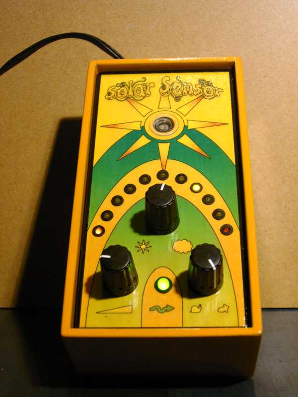

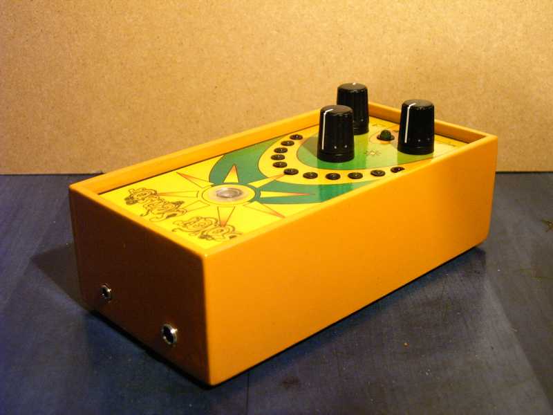

Here's one of my latest builds, I wasn't sure if I should post it here
since it's not actually some sort of instrument music making thingy
but it will be used as a controller so I guess that's ok too.
It's sort of light to CV controller made to react to changes in sunlight
(or other light sources). I can adjust the gain to make it really
sensitive so it reacts to minute changes in light (like slowly moving
shadows from plants), it has a control to adjust it to the amount of
light and a control for the reaction time from very fast to very slow
(glide effect). Output varies from 0 to 10V and is indicated with the
LED's.
I couldn't come up with an original name and really wanted to finish
it so just simply called it "Solar Sensor". I also did something
different with the front this time. Usually I use transparent but a bit
frosted looking adhesive foil that's specially made for making fronts.
Problem is that it's a bit expensive and I never seem to have
enough when I need it so I always have to order it (and I don't like
waiting when I'm working on something). So this time I just used
woodglue. First on the backside, and after it was glued on I also put
a coating of it on the front. I have to say I'm pretty happy with the
result, though next time I'll try a little roller instead of a brush.
here are some pics (more can be found here)
Its beautifull

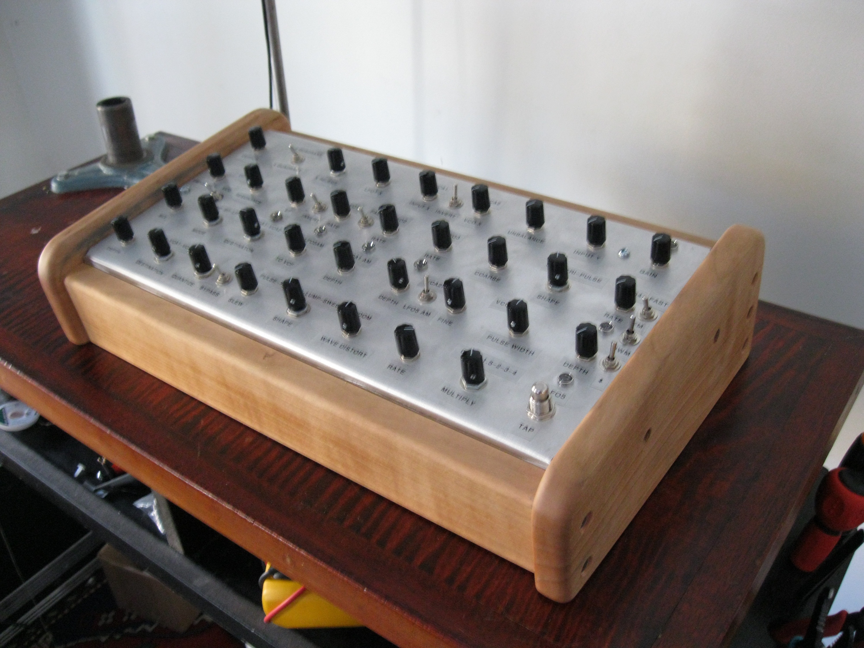

I just finished up a super bloated ring modulator thingy in a box. It has a transformer/diode ring modulator section based on Ken Stone's active ring mod, four simple LFO's, a Thomas Henry VCO-1, two Thomas Henry VCA-1's, a Thomas Henry VCF-1, an Electric Druid tap LFO, a Micheal Barton (Boogdish) pic quantizer and an envelope follower based on the one from Ray Wilson's envelope filter. And lot's of wires inside, i could barely close the lid!
Lovely work coming from everyone here!

looks great. and who cares about how it looks inside? Very Happy

jordroid, thats one nice wooden case. any vids with it in action? Very Happy Very Happy

Exactly...but we all do care about what it sounds like...would love to see/hear more about it.

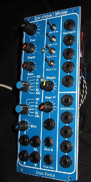

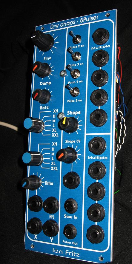

Hello , just finished my Ian Fritz / Bridechamber pcb's this weekend , panel done , drilled , assembled .
Double well chaos / 5Pulser / some multiples (handy).
The chaos used as a cv generator is great fun , i included a 6 way rotary switch for a selection of polystyrenes i had lying around for C1 and C2 cap selection, M medium setting is the standard 1N from the circuit down to XXL ... 680N for interesting sweeps.
The 5pulser is great fun as well, i like it alot Smile
i'll post some short sounds in a few days .
Here is the panels to match the rest of my modular .
Thanks for looking Smile
Dave.

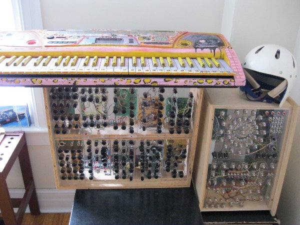

Here are some other recent things. There is an MFOS 16 step sequencer, sound lab mini-synth + and an MFOS phaser on one big panel.
In the modular cabinet clockwise from top left there is
-an MFOS quantizer and two 4 input mixers
-dual MFOS ADSR's
-an MFOS VCLFO
-two simple LFO's
- an MFOS state variable filter
-a module for bringing guitars or other instruments up to synth level, providing boosted clean signal out, squared out and octave down squared out along with gate and trigger signals, based on the MFOS sub commander mostly
-a Buchla low pass gate and Thomas Henry VCA 1
-a CGS active ring mod and two Thomas Henry VCA 1's
-half of a working mutron bi-phase type phaser with selectable number of phase and feedback taps, and voltage controlled normal or inverted feedback
-and a rehoused synthesizers.com midi to CV with two simple glide circuits and some multiple jacks.

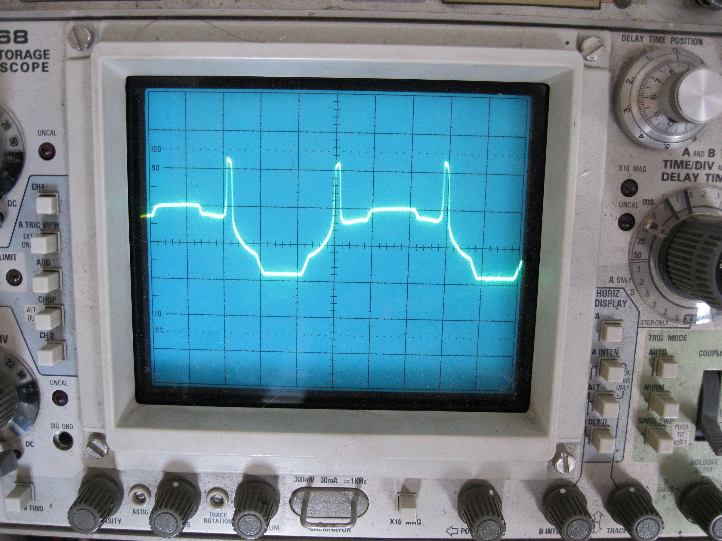

pair o bugs, wogglin'

Here's my buchla music easel clone. A complete build history, more pictures and sample sounds are here
http://minimalist.davidleith.com/DeitzModSynth10.html

Shocked very nice build and sounds

So many great builds on this page. I really wish there were PCBs for that Buchla...
