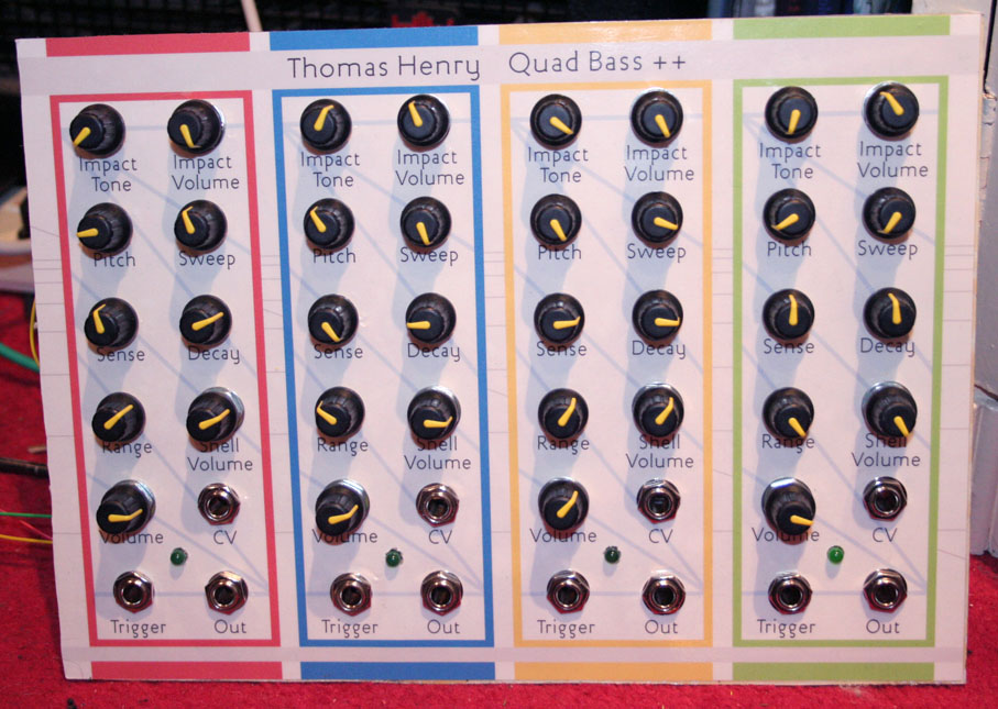

PostPosted: Sun May 22, 2011 1:42 pm    Post subject: Thomas Henry Bass ++ nearly finished! Reply with quote  Mark this post and the followings unread
Well this one has taken a while.
Learning to use the headers and crimp (and solder) all of those wires was a bit of a task to say the least. And getting them all wired to the panel was quite fun too! The 15v supply was another story altogether!!
Still it's done at last. Needs a case knocked up and one of the four voices isn't working yet so there's a bit of trouble shooting to do but I have three happy drums which is great.
Now I can get properly stuck into the lunetta rhythm maker I've been toying with to trigger this thing.

PostPosted: Sun May 22, 2011 4:49 pm    Post subject: Reply with quote  Mark this post and the followings unread
Looks great Captain, I'm inspired to finish my Quad Bass++ Smile

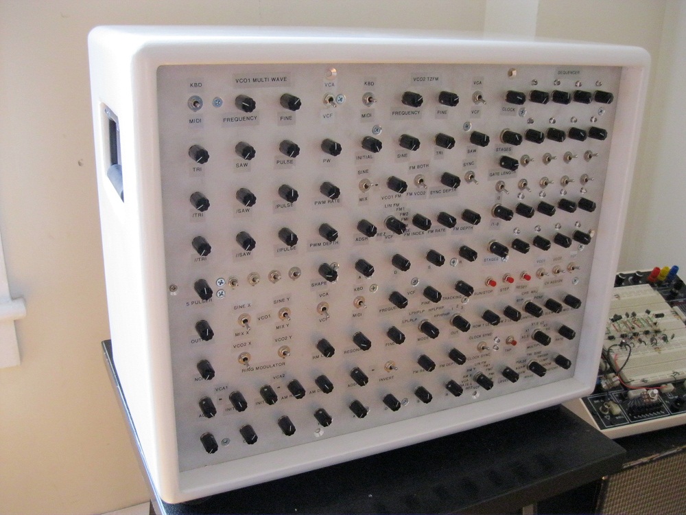

PostPosted: Mon May 23, 2011 8:48 am    Post subject: Reply with quote  Mark this post and the followings unread
Ahhhh, finally done with my winter project, a synth in a box with normalized connections for ease of playing, from an earlier post in this thread. I have added an Acoupel midi-CV converter and messed with a few things since then, but it's pretty much the same.

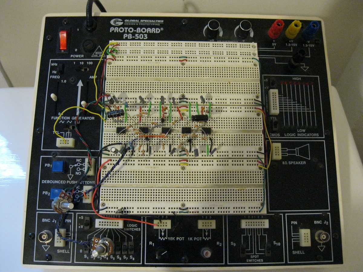

PostPosted: Mon May 23, 2011 2:49 pm    Post subject: Reply with quote  Mark this post and the followings unread
jordroid, that looks clean and awesome!
But I'm even more curious about that little doodad on the right - the thing with the solderless breadboards on it. What is it?

PostPosted: Mon May 23, 2011 3:10 pm    Post subject: Reply with quote  Mark this post and the followings unread
Ha, it's a breadboard with a bunch of handy stuff built in, a power supply with +5 volts and adjustable + and - rails, a function generator, a couple of pots, switches, logic stuff and a tiny speaker. I find it super handy, especially the power supply and function generator.
I live near cornell university, and this one was found in a dumpster up there with two others just like it, which went to friends. All three work perfectly, although they all have evidence of some serious DIP barbeque action, you can see a few brown spots where the plastic was melted.
I have a few other (less fancy) breadboards from "up the hill" as well. It's a longstanding tradition here to go dumpster diving right as the students are leaving, they tend to throw out some pretty choice items in their rush to leave town, especially the EE's Smile

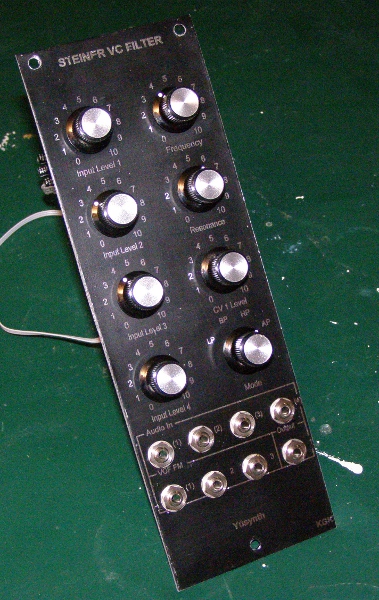

PostPosted: Mon May 23, 2011 10:40 pm    Post subject: A new Yusynth Steiner Filter Reply with quote  Mark this post and the followings unread
I probably don't really need another Voltage-Controlled filter however, for reasons that I don't quite understand, I enjoy building filters.
The Steiner filter is not a complicated filter however it works amazingly well.
To have a front-end mixer for the audio adds to the versatility of the filter. I like to have at least three control voltage inputs, too.
Front panel view of the Yusynth Steiner filter.

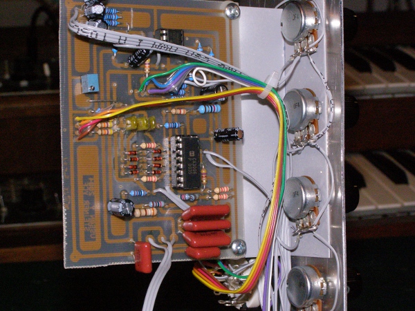

The PCB behind the panel. At the top left, you can see the resistors I added for additional audio inputs. Since the input stage is an inverting op-amp, this was an easy mod.

PostPosted: Mon May 23, 2011 10:45 pm    Post subject: Reply with quote  Mark this post and the followings unread
Wow, that proto-board is awesome. I've been picking up parts to build something similar, but designed specifically for synth/audio development. I can't find anything like those mini-breadboards on each of the modules. What you've got there would be worth $100 just for the PSUs, and it comes with so much more. Nice find!
Access to the Cornell EE dumpster, sounds like the beginning of a cool sci-fi story in there somewhere Laughing Lucky dude.

PostPosted: Tue May 24, 2011 6:48 am    Post subject: Reply with quote  Mark this post and the followings unread
kjackman wrote:
Wow, that proto-board is awesome. I've been picking up parts to build something similar, but designed specifically for synth/audio development. I can't find anything like those mini-breadboards on each of the modules. What you've got there would be worth $100 just for the PSUs, and it comes with so much more...
Looks like it's about a $300 value.
