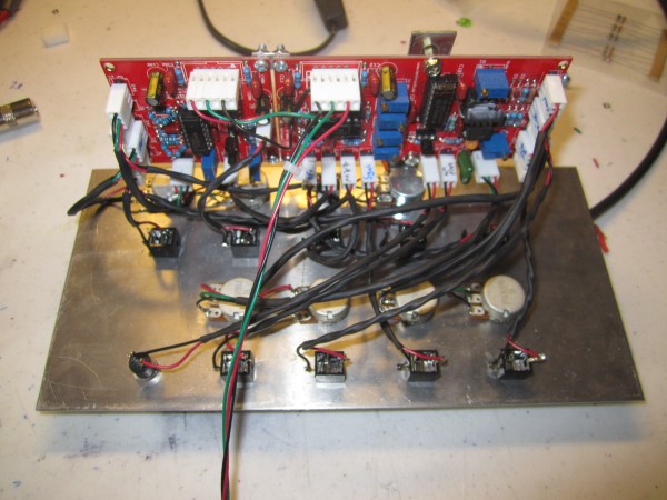

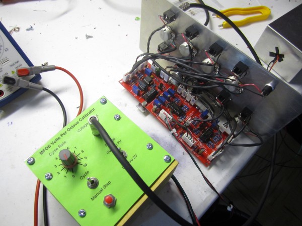

Finished mine last night. Working on calibrating it now. I have only been doing DIY synths for about 3 months. This is my 4th completed module. Calibrating is going OK so far. When the VCO gets into higher octaves, it cuts off. Powering it off then on brings it back once the frequency is turned back down. Not sure if this is a characteristic of my 4046 or not (which is a motorola). The HF trimpot is set to maximum resistance per Thomas's calibration instructions. I am going to continue calibrating with tools now. However if anyone has any input it would be gratetfully appreciated. So far I am very happy with it. A very big thanks to Matthias and Thomas for this great project.
Andrew
Completed X-4046 VCO
 Filesize:  2.94 MB
 Viewed:  475 Time(s)
Completed X-4046 VCO & MFOS 1v\oct calibrator
 Filesize:  2.6 MB
 Viewed:  469 Time(s)

ive built one now and am finding myself here because i could not tune 1v/O whatsoever.
i now see that the ON semiconductor 4046 was a fail and that's what ive got in it now.
i also have the nxp 4046 and will be installing it tonight to see if my results improve.
other than the tracking problems (about a semitone per two octaves), im enjoying the sound of this oscillator.
the "pips" in the triangle wave make it buzzier than others in my system,
but the osc FMs wonderfully and has a very wide range, well down into lfo territory.
edit:
problem #1: 100k in R2...changed that to 390R
i then swapped out the ON PLL for the NXP PLL--wow, what a difference.
it was remarkable how much my waveform improved. i can barely see the pips in the triangle now
its calibrated very well now and it sounds fantastic. cant wait to build the next one

After swapping my 4046 for an NXP and a few hours of messing about with the trim pots, it is working beautifully! Sounds fantastic with my MFOS 10 step sequencer. The only thing that I do not understand is how to use the hard sync. Everyone says it sounds great so I am dying to hear it myself. Do you need 2 VCO's connected with this? Or does the CV connect to it? Or am i completely wrong lol?

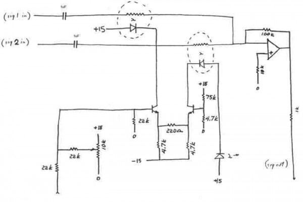

hi mattias
i have a question about the skew function
i don't understand if it's possible to make it cv controllable
on the pcbs i was checking the in and outs
so i have
triangle
rampoid with his skew control
saw
sine
and pulse
but i don't see in wich way i could modulate the skew
just adding a connection from the tip of a jack to the middle pin (pin2) of the potentiometer could work?
PostPosted: Thu Jul 21, 2011 7:35 am    Post subject: Reply with quote  Mark this post and the followings unread
tokyomatik wrote:
hi mattias
so i have
triangle
saw
sine
and pulse
if you take a look at the schematic you will see how it works:
from the VCO core we have the saw and the saw outputs. they are simply mixed manually with a potentiometer (saw and tri on the CW/CCW, mix on the wiper), and buffered with an opamp (voltage follower). actually not mixed, but faded into each other.
therefor the waveshaper PCB provides the saw and a tri input.
to have voltage control you would need at least two VCA circuits, however, you could do it with two vactrols.

the vactrol is a vc resistor. so the ldr part would do the job of the pot, while it's controlled by a cv applied to the led side of the vactrol.
i've seen an example of a voltage divider somewhere around here in a thread not so long ago. that explained quite well how to use a vactrol.
hop.sing
Joined: Jun 11, 2011
Posts: 8
PostPosted: Fri Jul 22, 2011 2:44 am    Post subject: Reply with quote  Mark this post and the followings unread
Here is an example for a vactrol panner, should work for skew also.
 Filesize:  62.98 KB
 Viewed:  304 Time(s)
PostPosted: Fri Jul 22, 2011 2:50 am    Post subject: Reply with quote  Mark this post and the followings unread
that's what i was thinking of (buchla/mark verbos?). i recently ordered some H11F3 optocouplers, which are much cheaper than vactrol. i hopefully will be able to adapt the above ciruit easily...
