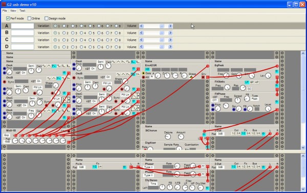

I've been able to speed up the creation of modules, thanks to Doremifasol's suggestion. There's only a bit of a performance problem now, because of the cables. My laptop is huffing and puffing when I move a module with a lot of cables attached. I think the cables look nice, but maybe there not very practical.
Anyone happen to know what font is used on the modules in the clava software?

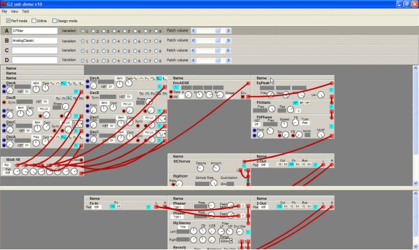

PostPosted: Fri Sep 09, 2011 3:26 am    Post subject: Reply with quote  Mark this post and the followings unread
Hey Bob, i work for a fruit and vegetables exporter: tomatoes, cucumbers and peppers, doing the logistics it. We have to work quick otherwise it all just rots away!
About the developement tool discussion. If i would have to write this in Java it would take very much longer, just because i'm not familiar with it. I think it may be more efficient that i just go on in Delphi and that a Java specialist ports it to Java, if necessary. I don't think this is going to be a lot of source code.
The graphic's part turns out to be the most difficult, because of the layers ( a layer modules the a layer controls and then the cables on top) and the large amount of controls and it all has to perform reasonably quickly of course.
And also because i wanted to put in rack rails in the background. Cool
I tried to do that in my hacked editor, but unfortunately the background texture is smaller than the module size Sad
Racks rails are cool!

PostPosted: Fri Sep 09, 2011 5:50 am    Post subject: Reply with quote  Mark this post and the followings unread
What are the 3 checkboxes for ? (Perf mode / Online / Design mode)
brunov
Joined: Aug 03, 2011
Posts: 227
Location: delft
PostPosted: Fri Sep 09, 2011 7:09 am    Post subject: Reply with quote  Mark this post and the followings unread
"Perf" is the same as in the clavia software, to switch between performance mode or not.
"Online" indicates if the usb connection is active. So i can test things offline ( displaying, changing patches) without the actual G2 connected.
"Designmode" i put in when i thought i had to design all the modules, with this you can add or move controles on the modules. But now that i can generate the modules from file this is not necessary anymore.

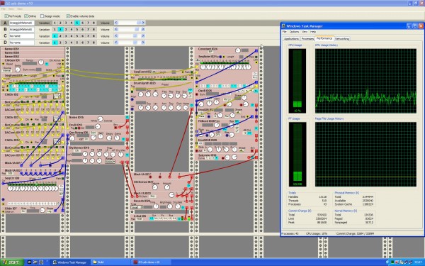

PostPosted: Tue Sep 13, 2011 1:55 pm    Post subject: Reply with quote  Mark this post and the followings unread
Here is a screenshot of the last incarnation of the g2 usb demo. I've put the sequencer leds and the mini-uv's in. I really had a big problem at first with these leds because the cpu usage went through the roof. Turned out that when a led in the left bottom corner went on and also one in the other end of the screen, the whole screen was repainted at 150Bpm's! So had to rethink the graphics rendering. Now it's around 20%, i think that's ok for the moment.
I also think dradpap's idea was very good, to put the volume and variations on top of the screen so you can change these in another slot without leaving the patch you're working on. I used to work only in one slot but now I'm more inclined to use the others and mix them in. Maybe you already did that, but I'm learning all sorts of new things! I still have to put the mute buttons on there also.
There's a bit of usb trouble now and then, mostly when I switch between the clavia software and the demo, it sometimes happens that the messaging goes out of sync, so bit more testing to do there, and also about a 100000000 other little things to do....
Hopefully I can upload a new version of the source next weekend, I guess you guys can't wait to port it to ipad linux etc etc etc

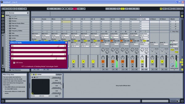

PostPosted: Wed Sep 14, 2011 12:48 pm    Post subject: Reply with quote  Mark this post and the followings unread
Looks like it's possible to make a vst out of it. I put together a little experimental vst based on the template from tobybear and put it in ableton. Seems to work ok. Very Happy
But how would you store a patch in a song? Sysex probably, but that's not possible in ableton yet, also don't know if sysex is in Tobybears template...

PostPosted: Thu Sep 15, 2011 12:33 am    Post subject: Reply with quote  Mark this post and the followings unread
The VST plugins has parameters declared in its interface. Those parameters are accessible for the host application and I think that only the value of these parameter are stored with the song or project.
This is OK for parameter values (like slider position...) but I do not know how this could be done for modules. I think NI Reaktor runs as a VST plugin. I don't know how it works...
May be I can have a look on the VST SDK to propose solutions.

PostPosted: Fri Sep 16, 2011 3:59 am    Post subject: Reply with quote  Mark this post and the followings unread
Maybe you could use VST Chunks for that:
http://www.tobybear.de/d_snippets.html

PostPosted: Fri Sep 16, 2011 5:49 am    Post subject: Reply with quote  Mark this post and the followings unread
That looks promissing, if I undestand it correctly the chunks are used to load/save presets and banks of a vst via the host from and to file as fxp/fxb files.
Do you know if they are automatically loaded into the vst if you load a project?
I've been thinking about the parameters also. Maybe the most logical thing to do is to expose the parameters to the host that are mapped in de parameter pages of the clavia software. Then you always have a fixed number of parameters.
