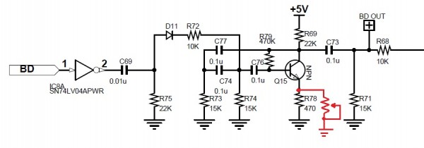

what i should do with the IC on the first part of the schematic?
im guessing that mi input (the part that says BD) will be like a Control voltage input?
And could i use a 2n2222 transistor?

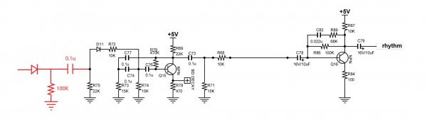

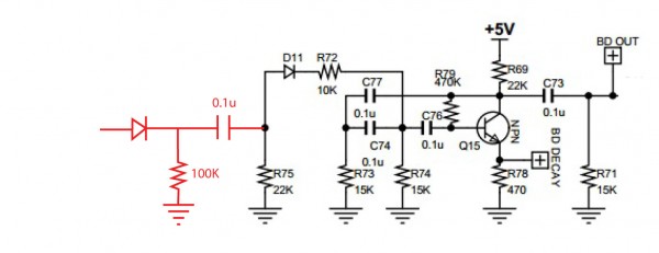

What I did with the input is this. I removed that section you circled on the schematic and replace it with a diode, 100K resistor to ground, and 0.1uF cap. This means I can trigger the drum to fire using a gate signal of any length. I am using these drums in my logic synth/Lunetta so it is handy to be able to trigger the drum from a logic signal..
I used 2N3904's in mine but a 2N222 should work as well. Also, I added the output transistor section to the right of the schematic from Korg. I left off the PORT section and just added everything on the right of that. This gave the kick drum heaps more BOOOOM. Oh, and I used a 1K pot going to Ground where Korg have BD DECAY labelled. This gives the kick drum adjustable decay to a point of self oscillation.

Sorry, I should have done this before. Mine looks like this:

ive just breadboarded the Bass Drum from the monotribe korg, i like it but i need a little more bass and deeeper sound
any recomendations?

Try a few different transistors, even of the same type. I replaced the quite a bit until I found one I liked. Have you used a decay pot? That will give it more boom. The other option is to try a more complex circuit like the 808. You'll need a bipolar power supply to run it though.

im not 100% shure of the location of that decay pot
i have a drawing right here, its right where i placed?

Yes, that is correct. Is it having no effect for you?
