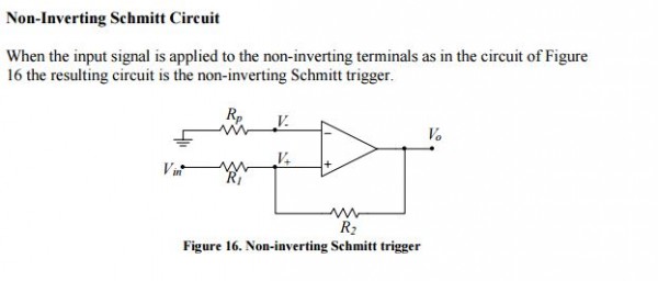

If you prefer to use an opamp, why not use it as a Schmitt trigger?
Just one more resistor as in a comparator and, especialy when your edges of your signal aren't fast, are less succeptible to noise.
http://neurophysics.ucsd.edu/courses/physics_120/AoE_Comparators.pdf

As far as I am aware turning it into a schmitt trigger by adding hysteresis only works if you swap the inputs and then it inverts.
Since the signal is already digital (and I assume we are not talking about very high speeds here) I don't think it is needed anyway.

Non-inverting schmitttrigger, bron: https://ocw.mit.edu/courses/electrical-engineering-and-computer-science/6-071j-introduction-to-electronics-signals-and-measurement-spring-2006/lecture-notes/24_op_amps3.pdf
Drawback is this has a hysteresis around gnd level, so would you want to use it, there will be a need for a voltage source.

oh nice, I'm not sure if I have seen that before. It does make sense though to just add the feedback to the input signal.
