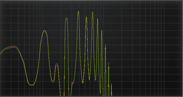

PostPosted: Tue Mar 20, 2018 9:45 am    Post subject: Some OscB FM modeling results Reply with quote  Mark this post and the followings unread
Hey people! Here are some fresh results of FM modeling through simulating OscB/OscC modules. One color is original NM2, another - our Cs model.

PostPosted: Tue Mar 20, 2018 4:22 pm    Post subject: Re: Some OscB FM modeling results Reply with quote  Mark this post and the followings unread
gleb812 wrote:
.Here are some fresh results of FM modeling through simulating OscB/OscC modules. One color is original NM2, another - our Cs model.
Looks good to me. We don't want to make the perfect the enemy of the good. Smile

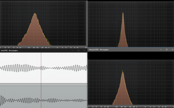

PostPosted: Wed Mar 28, 2018 1:05 am    Post subject: On OscNoise Reply with quote  Mark this post and the followings unread
Hey ppl!
Here some news from our labs! This time we got a OscNoise model. We use simple non-linear feedback filter. As it used to be, one color is Csound, another is for Clavia. Also some waveforms included.

PostPosted: Wed Mar 28, 2018 1:16 am    Post subject: Reply with quote  Mark this post and the followings unread
That's pretty close Smile

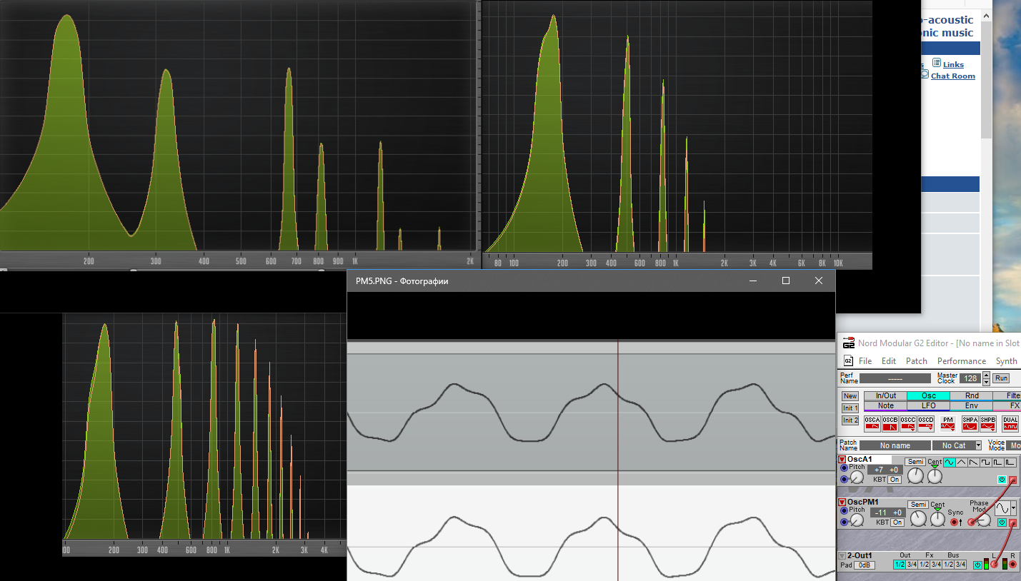

PostPosted: Sun Apr 01, 2018 7:14 am    Post subject: More FM/PM Reply with quote  Mark this post and the followings unread
Friends,
here are more modeling results for OscPM, which soon will be uploaded to our repository. Enjoy!

Electromagnetic Wave
Joined: Apr 28, 2013
Posts: 305
Location: Kebek
G2 patch files: 38
PostPosted: Wed Apr 04, 2018 3:31 pm    Post subject: Reply with quote  Mark this post and the followings unread
Hi gleb812!
Nice! Excelent results !
I'm a bit busy actualy. But I follow all updates. I will take more time to test and work on the project soon.
Big respect to you, your team and all the others who join the project!

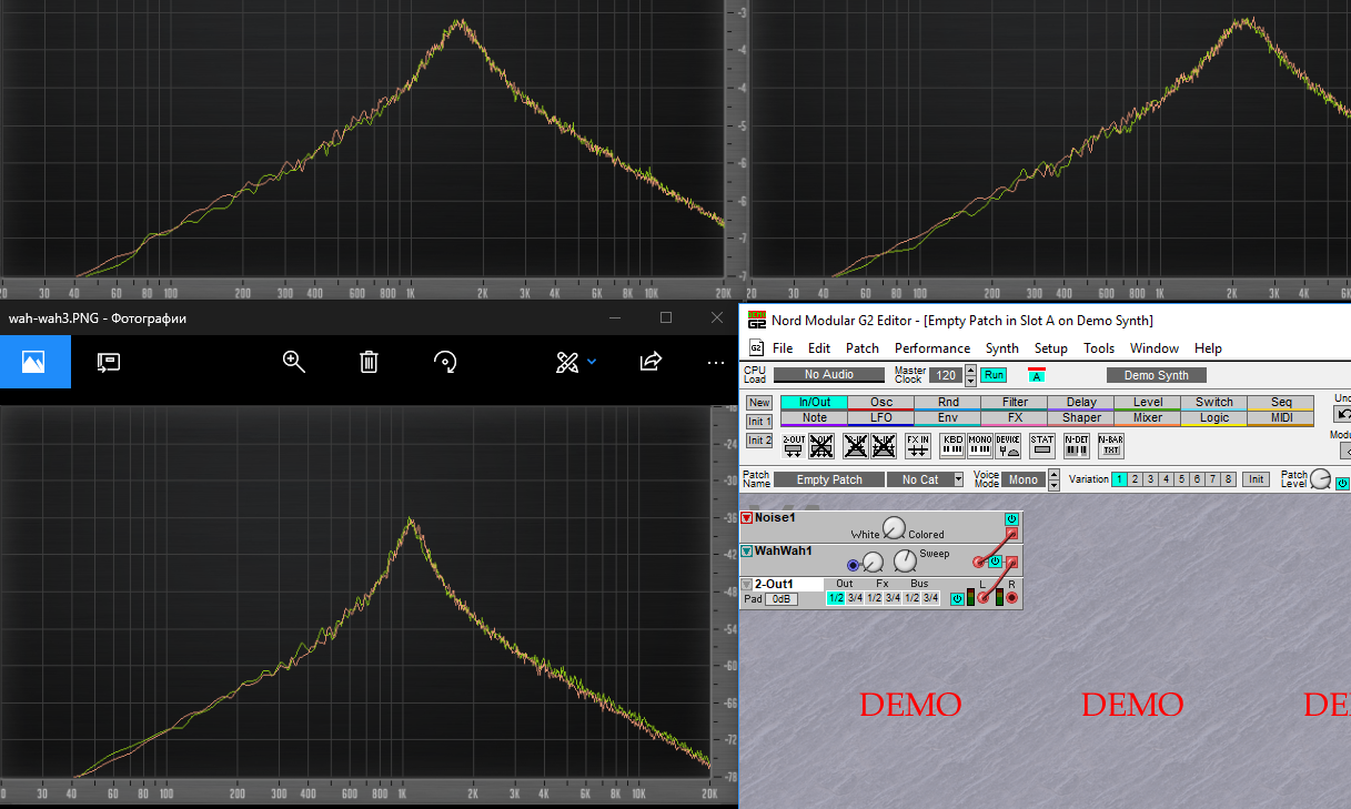

PostPosted: Sun Apr 08, 2018 1:56 am    Post subject: Filters... Reply with quote  Mark this post and the followings unread
Hi folks!
What about reversing some filters? Not the top ones for this type, but nevertheless worth doing.
Today we have FltMulti, FltStatic & Wah-Wah. All seem to be pretty well modeled by Csound's statevar filter, which is in turn a digital implementation of an analogue state-variable filter.
The first series of pictures is from FltMulti/FltStatic in 12 dB mode, without GC.
The second series is Wah-Wah. Just a BP, but with gain and Q changing across the freq range + some small static high shelf around 17k+.

Posts: 18260
Audio files: 228
PostPosted: Mon Apr 09, 2018 9:11 pm    Post subject: Reply with quote  Mark this post and the followings unread
Looks good to me. It doesn't have to sound exactly like a G2, just close enough.

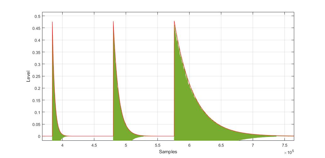

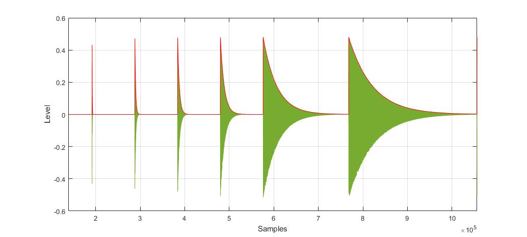

PostPosted: Thu Apr 12, 2018 10:59 am    Post subject: Decay Reply with quote  Mark this post and the followings unread
Hi folks!
Today we have a math model of NM2 exponential envelope.
On the pictures below the green signal is an original enveloped noise from DrumSynth, and the red envelope is our envelope model.
The function we use is
Env = exp(-4.7 * x / DecayTime)
More interesting things to come later....
