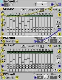

I assume you use a split keyboard, in which one part is send by Midi channel 4 to the Electro, which is set to channel 4 too?
No, the NordLead3 send his Program change when changing the Performance, not just a single Slot. This is only possible in Program mode, but then the other three Slots can't be changed as a 'Performance' in one go.

In the picture you see a simple set up of 8 changes of two extern synths without using Program Change of the G2 itself by just pressing one button on the G2 panel.

What message would it be other then Program/Bank Change?
I think you can do it this way...
Don't use NL3 Performance mode if you don't want to change Slot A to C. Then create a special Bank containing silent Programs and load this bank into Slot D. You are able to name these Programs with the memory locations of the Electro or name of the song with memory location of the Electro. Set Slot D and the Electro to the same Midi Channel. When Slot D is activate and is changed to another Program, the Electro will follow. If you need to make a jump, use the Rotary Dial of the NL3.
BTW the Electro only has 64 memory locations, so you're are only using half the bank.
In this set-up it is impossible to save the value of the Program Change in the Program of the NL3. (It can in the G2, which has a flexible Midi Out set up)

As I wrote above, the only Clavia synth which is able to preform such things is the G2. It has a miracle Midi module to preform this task, the Midi Automate, which is able to 'read and save' settings of another synth.
The G2 (or Engine) is a real synth tool!
I use the Midi section to make the Organ Draw bars Velocity sensitive, like on the Stage.
