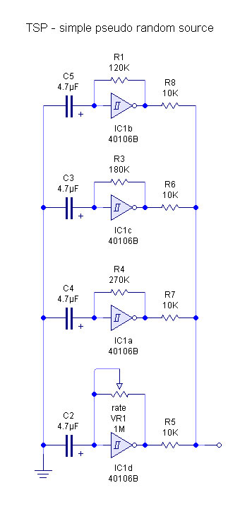

The core of any Lunetta system are the oscillators. Lunettas use only square wave oscillators, usually made by very simple logic. Typically, Lunetta oscillators have a relatively limited frequency range - just a couple of octaves - because the circuits are so simple. That is much less of a problem than it seems, because most of the frequency setting is done down stream though various other circuits. Thus, while a good Lunetta oscillator does in fact have a frequency knob, the are used more like clocks than a conventional VCO in an analog modular system.
Bugbrand already posted a nice appropriate Lunetta style oscillator which I'm reposting here to get things started off. (Click on the pic to see it full-sized).
This is a good one to start with, The main OSC uses a single inverter with an RC (Resistor Capacitor) network to set the frequency of the OSC. The sync out is a nice bonus with this circuit, but the sync feature is not necessary.
There are other variations of the inverter OSC which I hope people will post here. Also, this topic is a place to post questions and comments about oscillators built with simple logic.
Note, it is possible to use an analog VCO with a Lunetta, but this can present problems with interface circuits. For example, Digital logic likes input swings between 0 V and Vcc.
So, let's see some more oscillators here and questions and discussion.

here are a few, common as they are
i know you said square but here is a 4049 tri / sine ( well close enough ) lfo i've used. its not perfect but very usable. using a smaller C1 will get it up into audio range, not sure how well the shape will stay put up there though
a simple as can be 4011 squarewave osc with a fairly good range.
and the all too common 40106 pseudo random square osc
