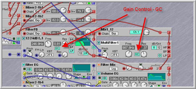

Thanks,chaps.Here are a couple of example patches.Similar in sound,work progress type thing.Best to play one note,C3 or something,to hear what I'm on about.By the way,Rob,pardon my ignorance,but what is the GC button you referred to in your list of suggestions?Thanks everybody....

I listened to Another Life, nice patch. I could hear the clicks with headphones. I started from the back of the patch and started eliminating modules. First, I just disconnected the output and connected it to the FX in. Still clicks, can't be anything in the FX section. Continuing backwards, it seems to be coming from the filter module just before the envelope generator. I turned on the GC on the filters and the clicks seem to be gone. I also followed Rob's suggestion and set tip pad down -6 dB on the FX input. Here's a photo to show you the GC buttons.
Try similar techniques on the second patch and I'm sure you'll get the clicks out.
GC buttons on filters.

You're a star mosc!Thank you very much.I do programme synths (when I get the time),and am reluctant to admit that I go as far back as owning Moog and Arp back in the '70's.But i never got into the modulars,and even though this is virtual,the principal's the same.Thanks for the diagram,too:really helpful.Let me know if wnat somefreebie patches! Very Happy
GC stands for Gain Control and is coupled to the resonance of the filter. Turning up the resonance on a filter creates a peak with more amplitude than the incoming signal. Some filters, like the 12dB, can have a significant boost of this resonance peak, driving the peak to the headroom limits and causing clipping. The GC button attenuates the filter output if the resonance is raised, to compensate the extra gain in the peak. So, on the 12dB the GC should be On, light up that is, or else the signal into the 12dB should be attenuated first to some 25% to allow for resonance settings of 5 and up.
The Nord filter can also significantly boost the resonance peak, so here the GC button should be On as well, except when one really knows what one is doing, e.g. resonance not much more than say 1.25.
The Classic filter in itself compensated the resonance peak gain, as this type of filter attenuates the lowpass band up to -12dB when the resonance is raised. Similar to the Moog ladder filter. So, this filter is safer to use on higher resonance settings, and is also the most 'liquid' sounding of the G2 filters. But some extra EQ in the low is often used to beef up the low that gets lost by the -12dB at higher resonances. In this case be sure that the EQ band is lower than the lowest pitch the peak will have in a filter sweep, to prevent the peak being boosted by the EQ, which again could result in clipping.
In general the headroom of the G2 is small, only 12dB of the total 144dB range of the 24 bits. But it is very well possible to work with signals at a relatively low amplitude in the patch itself. E.g. a raw oscillator output has a resolution of some 22 bits, and by attenuating that to 25% it is still about 20 bits, more than enough for a perfect sound quality but giving 24 dB of headroom.
It is tempting to set everything in a patch to 'loud', but all digital systems are quite unforgiving about 'loud', rule of thumb is to make it 'loud' in the (analog) mixer. Which everybody here in The Netherlands seems to do with D&R mixing desks.
