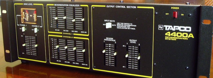

PostPosted: Mon Aug 04, 2008 7:53 am    Post subject: Reply with quote  Mark this post and the followings unread
I've got a Tapco 4400A Dual Spring Reverb that's rackmounted in my modular case. It sounds great... you get two channels with separate 4-band EQ. Inside are 2 tanks. Overdriving it sounds crazy, and with the EQ's you can really get some extreme sounds. From what I understand, they are pretty cheap (~USD $100) when you can find them.

Peake
Joined: Jun 29, 2007
Sweet- I haven't seen one of those in years, and not in that condition! Congrats!
