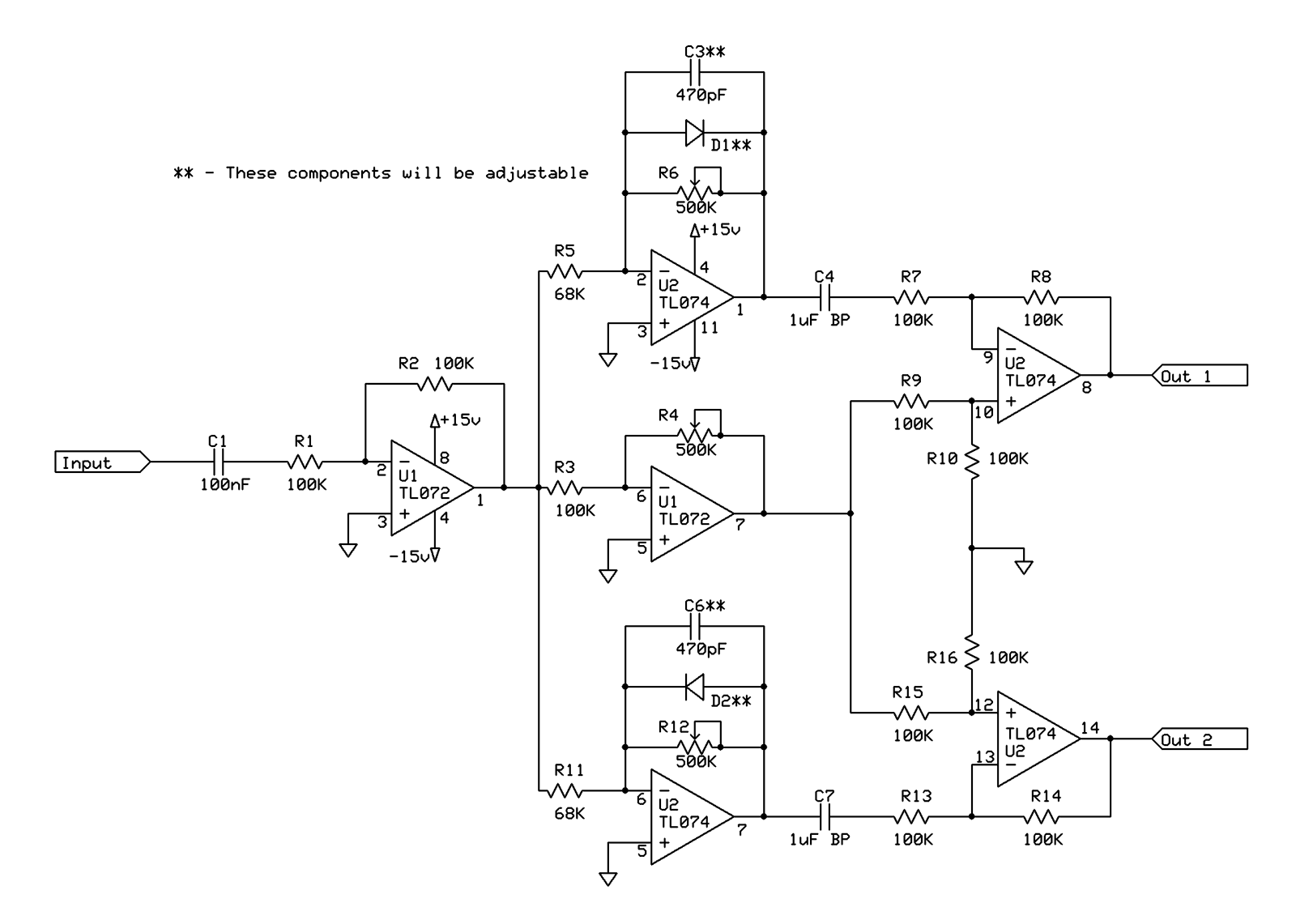

Here's the schem,
Updated 20-10-08
Can those of you who have more theory background than me check it over for any obvious problems or questionable practices?
Thanks heaps. Smile
For example, I don't think I really need C2/C5. I've tried bypassing them, and can see no real difference in the response. Would they change the way the clippers work? or act merely to de-couple DC?
By comparison, I know I want C4/C7 as I wanted to remove some of the DC offset from the clipped version before feeding it to the difference amps. I think this makes for more interesting crossover points. Any thoughts? I think maybe they need to be bigger though, as the clip has a bit of a ramp on it, (ie; they're discharging too quickly?)
I'm thinking of replacing R9/R15 with a dual gang pot to control how much of the original is subtracted from the clipped versions. I'm wondering if I should just replace R9/10 and R15/16 with dual pot based dividers (500K?) with the inverting inputs on the wipers? Any thoughts?

PostPosted: Sun Oct 19, 2008 8:22 pm    Post subject: Reply with quote  Mark this post and the followings unread
Yes, thoughts. In the movie I did not detect the stereo shifting effect, I presume the movie is mono?
Those 100nF caps are 15 kOhm at 100 Hz, which is the region of your bass signal fundamentals, and lower obviously at the harmonic region. So they are comparable in impedance to the 10 kOhm resistors they are in series with, and they will shape the waveform. If I recall correctly, a cap on the input side of an inverting opamp has a high-pass effect. So you should hear some difference when you bypass them.
Similarly, the DC blocking caps of 100nF are too small, if they are for DC blocking only. I'd make them bigger.
Instead of using a dual ganged pot on the diffamp inputs, I'd just use a single pot on the prior inverting amp feedback path. That would be cheaper, easier, etc. - always avoid dual ganged pots when designing for cost, as I'm sure you know. Also, putting the pot there just "feels right", as in "I've seen that a lot" and in the other positions it doesn't "feel right".
Just my 2 cents, nice circuit. I may have more comments later once I have a little time to think about it, but I wanted to address your questions right away. Fuzz On!

Yes, I think it may as well be, just an ambient pickup into the mic of the (normally still) camera.
So bypassing them is only going to improve bass response. That's actually a good thing as I'm a bass player really and I quite like a bit of fuzz on a bass sometimes.
Cool, my intuition was right on that one. I'll probably go with 1uF BPs.
Yeah, good call on that one, even though I don't think I'd ever "design for cost" alone, it's alot more elegant to use a single gang in that way. That high gain stage should have a small cap around it too I s'pose.
Thanks for taking the time to give me that feedback Les. Very Happy
PostPosted: Mon Oct 20, 2008 5:51 am    Post subject: Reply with quote  Mark this post and the followings unread
I just updated that schematic a couple of posts back with some enhancements,
Got rid of the caps on the inputs to the clippers,
Added pots to vary clipped levels and invert levels,
Tweaked gains for each,
Changed the de-coupling caps to 1uF BP
And I must say it's really starting to sing now. It's got great control and variation.

PostPosted: Mon Oct 20, 2008 9:24 pm    Post subject: Reply with quote  Mark this post and the followings unread
What about C1? Shouldn't that also be 1uF since it looks like a DC blocking cap?
I must say, Uncle, it is a really elegant little circuit. Do you mind if I add it to the EChucK collection? Do you know about EChucK?
