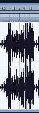

PostPosted: Sun Oct 25, 2009 12:10 am    Post subject: Reply with quote  Mark this post and the followings unread
This all sounds a bit weird, logic for me sounds no different to Live.
Your mp3 is extremely clipped, see the image I have attached so your first step would be to get this in order by reducing some of your levels.

PostPosted: Sun Oct 25, 2009 7:42 am    Post subject: Reply with quote  Mark this post and the followings unread
Well to make something sound loud what tends to be done is to compress the hell out of it but then you are going to loose dynamics.
Have a search for maximizers on google.
There are a few fee ones around, this Waves L1 limiter clone might start you off: http://www.yohng.com/w1limit.html

PostPosted: Sun Oct 25, 2009 7:45 am    Post subject: Reply with quote  Mark this post and the followings unread
Also worth remember is that most music you hear nowadays is compressed to hell so to get louder than that is impossible!
