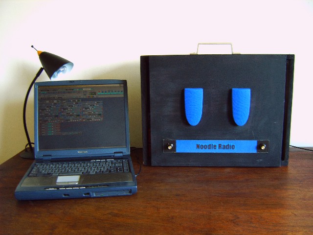

Alternatively, it's possible to load up a bunch of performances into a G2 and use another one to select performances at random from the first one. This is something I made for a performance last summer. Such a system would have to be set up in advance of the festival though.
Both systems are 'performance only', so contributers would have to convert single patches into performances first.
Attached are some pics of the alternative system.

The Noodle Radio system would be great - requires no connections to the internet. I don't know if it is rugged enough to bring over on an airplane though.
Apart from that, the $7 speaker system it uses is fine for me, but it wouldn't be for others I'm sure :-).
And then there is this 110 Volt issue as well, the G2's can be switched with some effort but the rest can't .
But it's just to give an idea of what would be possible, with just a little work something more usable for the event could be made. Probably using a regular audio system and just a little box in order to get a minimal user interface like the radio has. One knob for volume and another one for patch selection - the custom controller I built ffor that is very small (the PCB with the large black chip on it in the rear view)
