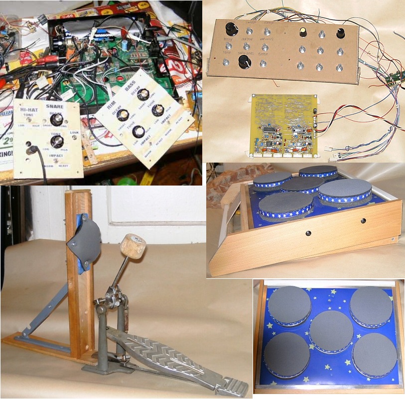

Funny you should mention that. Smile Here's what the whole setup looks like at this exact moment, just a few moments ago:
Drum synth progress
I do want to make drum pads, but at the moment there are three ways of triggering these bad boys:
1. My body, since the banana jacks aren't grounded the inputs are floating like bananas, and even the slightest touch to the metal makes something happen.
2. MIDI via the MD24 and my TR-505
3. My Lunetta via some clever little one-shot circuits that Ray Wilson put on this page(but I'm using XOR gates): http://www.musicfromouterspace.com/analogsynth/mmlogic.html
Recently added some Synsonics also! Haven't hacked into them yet though, but I have some good info from RichardC64 about it.
Sound soon! I recorded last night but need to edit a bit.
The eeePC is proving to be a very nice recording tool with Ubuntu running Audacity.
The top panel on the left is an SN voice awaiting final wiring, still haven't gotten the nerve up yet, but maybe this weekend.
Edit: Spelling mistakes.

PostPosted: Fri Apr 02, 2010 6:39 am    Post subject: Reply with quote  Mark this post and the followings unread
If double-posting was allowed, this could also appear in "post your backlog." I'm too embarassed to to say how long this has been "in progress"
Shown: early stages of Synsonic mods; 2-unit Bass++ that needs troubleshooting, with its temp control panel; bass pedal with pad; box to house the electronics, with piezo pads.
