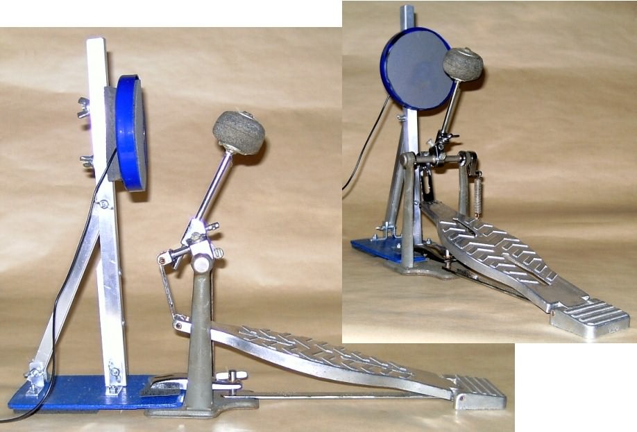

Not much progress on the electronics, but mechanical aspects are being dealt with.
Materials include: 2 aluminum "U" channels of different width, so that the diagonal brace fits inside the vertical member; bolts with wingnuts for tool-less set up and disassembly; mousepad under the 1/4" plywood base to prevent wobble, plus another piece to provide thickness and protect the wood from the clamp.
Here's an uninspiring sample triggering the Synsonic's Tom Tom 1 & 2 (both modded for lower pitch), first singly, then both together for a sort of surround sound bass. (Careful with your volume.)

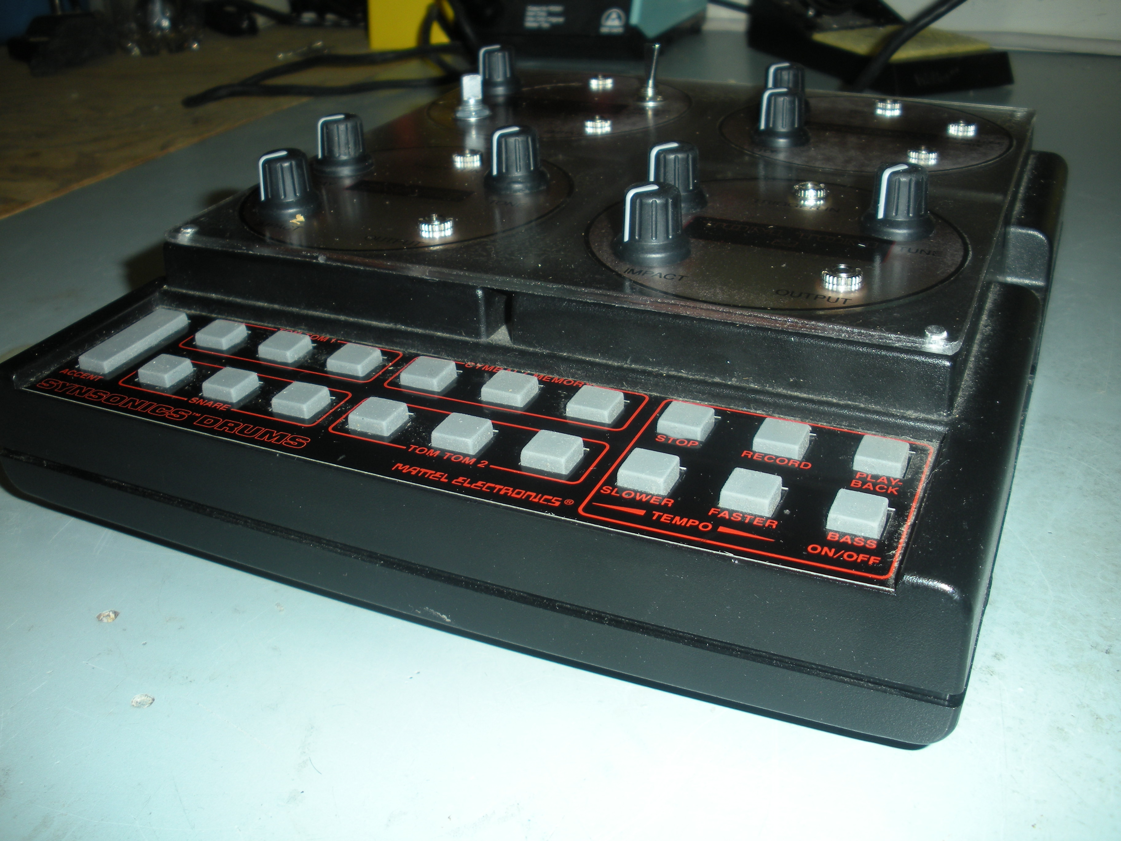

Well, I've just about finished with my modded Synsonics and this seems like the best spot for electronic percusion lately. The sound mods are all by our very own RichardC64. I have added individual trigger ins so my TH Midi to Trigger unit can control it under midi. All I did was add a diode from the hot jack to the analog trig in pins on U3.
I apologize for the crappy sound samples. I do not use my digital recorder (Zoom MRS8) very often and the results are less than stellar. But anyway, it does give you a feel of how much more aggressive the sound is than the stock unit. Perfect for your next NIN ripoff. Wink
I still want to add individual outs for each voice......... because I want to buy a new mixer Very Happy
