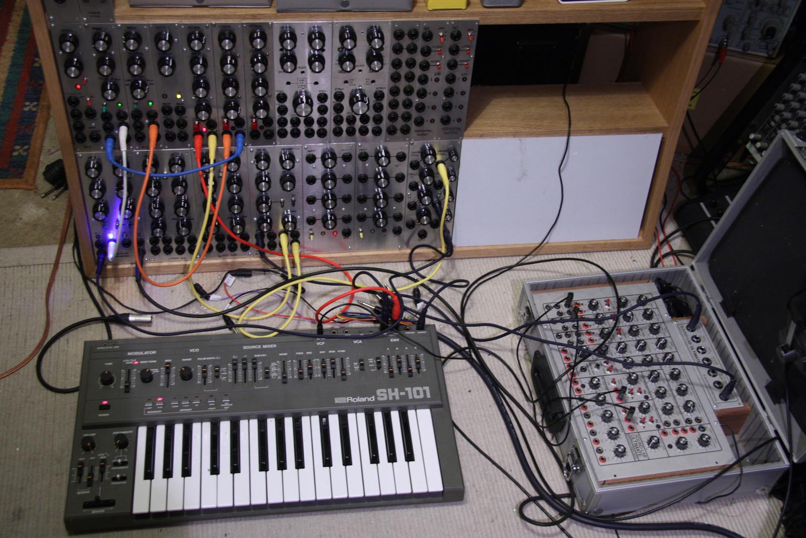

PostPosted: Thu Nov 25, 2010 3:50 pm    Post subject: Reply with quote  Mark this post and the followings unread
Ok, so the SH isn't one of my contraptions Smile
In dire need of oscillators (can't find any that don't require obsolete chips)!
Just awaiting further wiring instructions before I finish the two Buchla 281's (the ones with the larger knobs)..

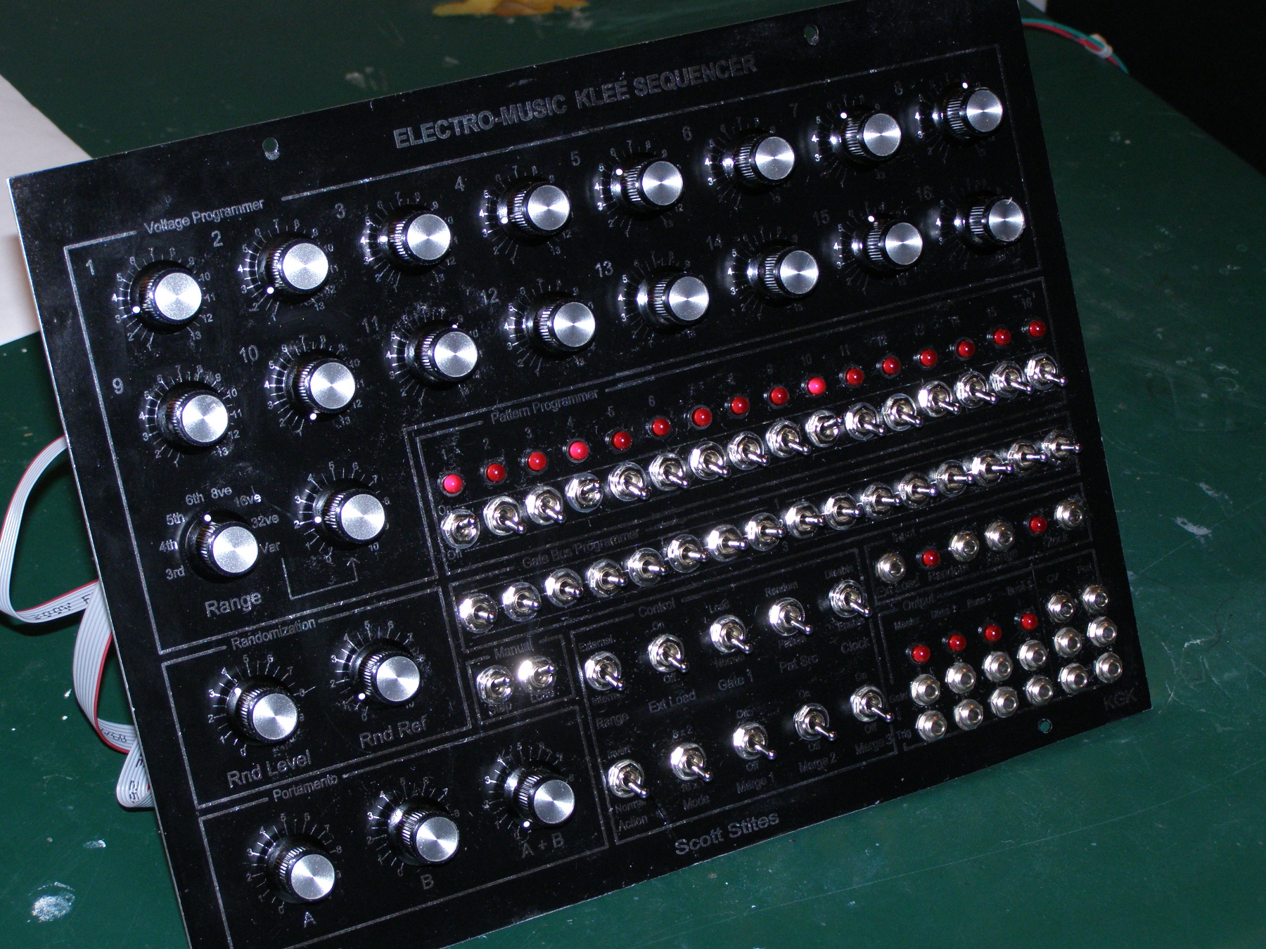

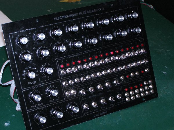

PostPosted: Tue Nov 30, 2010 12:12 pm    Post subject: My 2nd Klee Sequencer is up and running! Reply with quote  Mark this post and the followings unread
Unlike my first Klee Sequencer build, this one took quite a few evenings to troubleshoot.
I'm not sure why -- I just had quite a few wires reversed (nothing that damaged anything -- just switches and such. The worst thing was that I reversed SW40 and SW41 (the random switch and the pattern select switch) -- and as I tested the switches there was quite a bit of WTF??!!! before I found the error!
Frankly, headers and I don't get along very well and I prefer point-to-point wiring. I spent a lot of time straightening out and replacing the fragile contacts. There may be an easy way to do it but I haven't figured it out yet.
The good news is that, as usual, the troubleshooting process forced me to go deeply into the schematics and really learn how it works. So, it's all good.
The front panel.
 Filesize:  1.43 MB
 Viewed:  257 Time(s)
Under the hood.
 Filesize:  1.36 MB
 Viewed:  258 Time(s)

PostPosted: Tue Nov 30, 2010 1:19 pm    Post subject: Re: My 2nd Klee Sequencer is up and running! Reply with quote  Mark this post and the followings unread
Thing of beauty!
Must feel really really good to get that done and working!
Re headers: I'd think that working with that kind of header and ribbon cable might be more difficult than some other types...more easily confused at least...but I've never tried it myself.
Posts: 1471
PostPosted: Wed Dec 01, 2010 9:29 am    Post subject: Re: My 2nd Klee Sequencer is up and running! Reply with quote  Mark this post and the followings unread
emdot_ambient wrote:
Thing of beauty!
Thank you!
The feeling one gets from a finished module -- after all the sourcing, building, and troubleshooting -- is something shared by DIY people.
The Klee is a particularly satisfying build due to the complexity of the panel wiring and the density of components (108 Pots, LEDs, switches, and jacks).
In fact, sequencers in general are among the toughest projects, I believe.
Usually, I don't switch wires but maybe I stayed up a little too late when I built the cables. I plan to switch to color-coded ribbon cable after my current supply is exhausted. I like the narrow, braided wire, though -- very easy to solder and desolder.
The contacts are a bit fragile and I've found that they often need a little adjustment (with a narrow needlenose) to assure that they are straight and that the barb is at the correct angle.
If I were to build another Klee (I don't plan to, though) I would likely do point-to-point wiring with sufficient slack to allow the boards to be serviced.

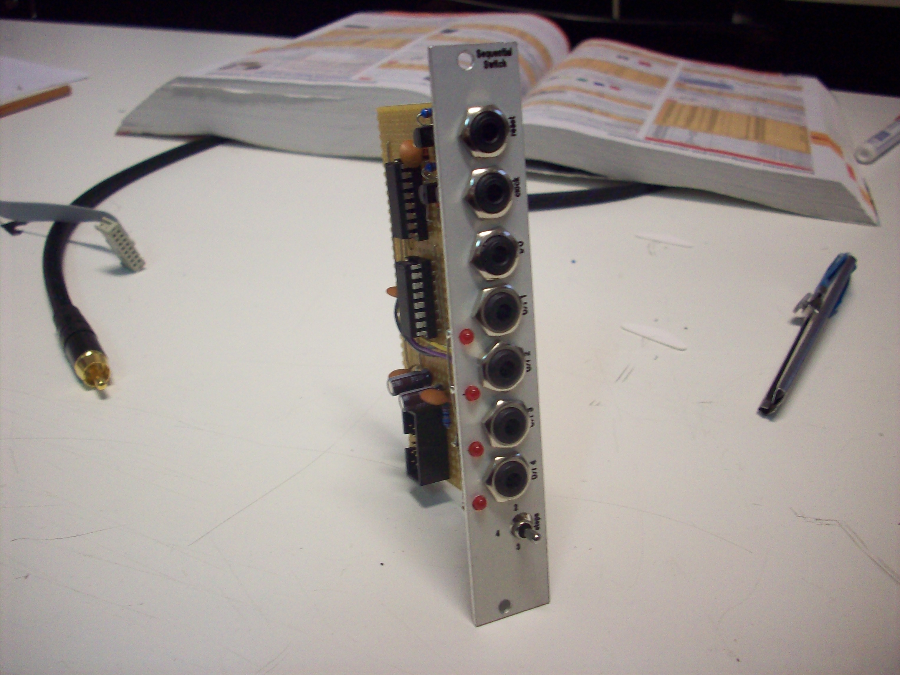

PostPosted: Thu Dec 02, 2010 3:34 am    Post subject: Reply with quote  Mark this post and the followings unread
Fonik's sequential switches (minimal version with no manual step and reset) on a stripboard!
 Filesize:  962.41 KB
 Viewed:  234 Time(s)
 Filesize:  884.57 KB
 Viewed:  247 Time(s)
