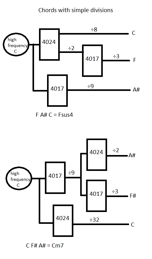

I'm starting a Lunetta, was wondering if it was possible to use this divider(or another) circuit to get several intervals from a single wave? I.E. Put in a C and get the rest of the scale...or some of it. So I could get a lot of polyphony from a couple of oscillators. I realize this is kind of what's being discussed in this thread but has a solution arisen?
Thanks. Been lurking for a few weeks and this forum is pretty awesome!

PostPosted: Thu Dec 05, 2013 8:50 pm    Post subject: Reply with quote  Mark this post and the followings unread
welcome, Deaf Wasp.
check out my thread here, for a similar idea.
That uses a lot of chips just to get a scale. You could use just a few divisions to get a chord, though: see attached (untested) example. Unfortunately you have to make some pretty big divisions to get the most conventional chords, eg. to get a major third in this way you have to divide by 6561! Also, the tones you get will be several octaves lower than the original signal...

PostPosted: Thu Dec 05, 2013 9:52 pm    Post subject: Reply with quote  Mark this post and the followings unread
Here's a major chord. Note that you put in an E and get out C E G about six octaves down... perhaps if there were a simple way to multiply by 3, 9, 27, 81 this could be made much easier: you'd put the base signal into a binary counter and take each divisions by 2, 4, 8, 16 into an appropriate multiplication circuit. Have a look at this pythagorean tuning diagram and you'll get the idea.
My method, rather than multiply by powers of three and divide by powers of two, was to divide by powers of three and then divide even further by powers of two. This avoids the problems of multiplying frequencies, but the downside is having to start with a very high frequency which is not at all like what comes out the other end. If you come up with anything be sure to post it!

PostPosted: Fri Oct 17, 2014 11:15 am    Post subject: Reply with quote  Mark this post and the followings unread
I know this is a really old thread....but I thought it might be interesting to somebody anyway...
You could use a divide-by-N counter like the 4059 or 4018.
