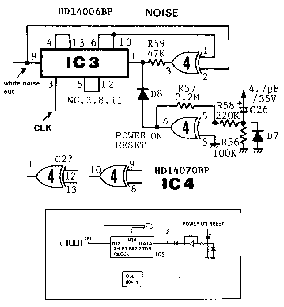

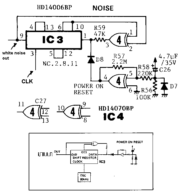

RingMad wrote:
Is this a problem with shift registers, or is just a peculiarity of this circuit?
Yes.
You have a 18-bit shift register, which will create a very long sequence before it repeats. It probably also freezes with a slow clock. You just haven't waited long enough.
When it reaches the state when all the bits are 1s -- or 0s -- there's no escape, because it clocks that state into registers that are already in that state.
There's ways to prevent the all 1 or all 0 state, but I've never understood the explanation well enough to tell anyone how to do it. Try NOT feeding one of your XORs back into the 4006. Or try the circuit below. It's the noise generator from the Roland DR110. Use one NAND for the Power On Reset and you'll still have 3 XORs and 2 NANDs you can use to combine 4006 outputs for random patterns.
Where'd you get that schematic? I've always despised those symbols. Without the IC# they convey nothing to me.
Fckn committees.

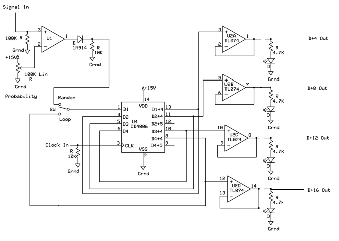

What if you replace theXNOR gates with NAND gates in the first circuit? Maybe you can try this klee sequencer number 1 schematic

Speaking of the klee v 1:
I notice leds on the quad op amp after some of the outs of the 4006. Might be worth exploring to see what results ya get. A fun circuit to add to the discussion at any rate Smile .

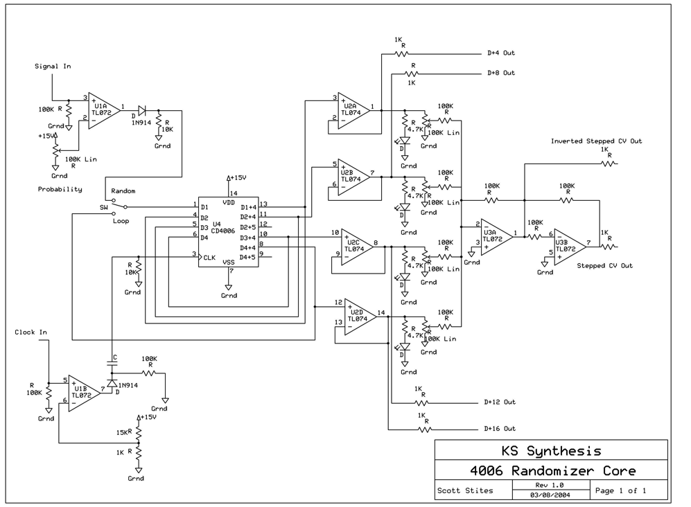

Maybe something more Lunetta-styled, like this?

Where I got the schematic?... like I said, my friend had photocopied it from a french electronics book... I had a little trouble reading it at first too, but certain things seem clearer. But I had a bit of trouble with that Roland DR110 circuit too... like, what's C27?
For the other circuits, they could be cool, but I'm not sure I want to get into lots of opamps yet... for one thing, I'm not using a bipolar supply. I've got just a single LM324 on my breadboard, for the R/2R.
Anyhow, I've posted 2 new videos... one of this circuit in action, as well as another random generator circuit... see the "the absolute beginners thread"...
richardc64
Joined: Jun 01, 2006
Posts: 679
Audio files: 26
PostPosted: Sun Feb 20, 2011 11:45 am    Post subject: Reply with quote  Mark this post and the followings unread
I should have erased "C27." The two unused XORs form the clock in the DR110. I deleted that part of the circuit, freeing 2 XORs, since you already have 1/4 4093 as a clock. I overlooked C27.

That klee circuit may have a couple of op amps, but it's no big hurdle. Notice no -15v on the schematic, just pos. and grnd. If not for you right now, no worries; it might aid others that want to play with the 4006 Smile .

Yeah, and i think you can leave the four opamps at the right out.
And if you have some digital, or amplified noise, you don't even need the opamp at the left! Haven't tested that...
