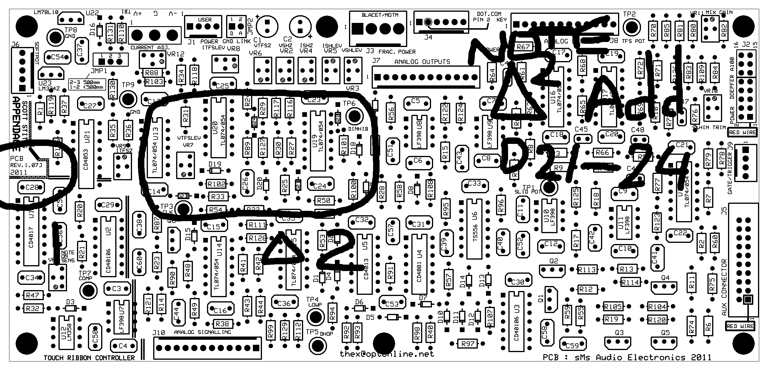

Here is where you can get ALL the latest build documentation for your Appendage Ribbon Controller. It includes the latest build document and BOM. It is also a place where I will be posting any changes or modifications to the build documents. the latest of any drawings will, from now on, be kept here.
NOTE: THERE IS CHANGE TO ALL PCB REVISION "H" OWNERS THAT ADDS 4 PROTECTION DIODES. IF ANYONE HAS BEEN EXPERIENCING ANY U21, CD4053, FAILURES, THIS WILL FIX THAT PROBLEM. THIS MODIFICATION IS EXPLAINED BELOW IN THE NEXT POST
THE LATEST ROUND OF APPENDAGE PC BOARDS ON ORDER, REVISION "J" WILL ALREADY HAVE THESE DIODES INCORPORATED. THESE REV "J" BOARDS ARE SHIPPING TO ALL NEW CUSTOMERS. PLEASE NOTE THAT THE CURRENT BUILD DOCUMENT FOR REV H PCB'S CAN BE USED BUT THE NEW REV J BOM ADDS 4 BAT85 DIODES. SEE BELOW FOR DETAILS OF PLACEMENT

Posted: Wed Sep 21, 2011 6:50 am Post subject:
PLACEMENT OF 4 NEW DIODES ON REV "J" PC BOARDS SHOWN BELOW.
Click on image to enlarge.
Thanks
Bill
