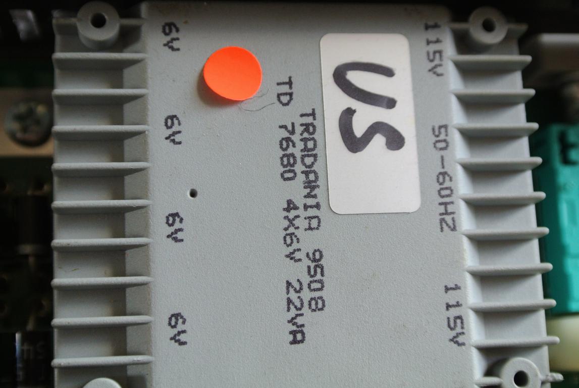

PostPosted: Sat Apr 30, 2016 10:02 pm    Post subject: Reply with quote  Mark this post and the followings unread
I've got a Nord Rack 1 from Japan and want to use it here in NZ on 230v.
Looking at the PSU board it has the 110 and 230 jumper points on the PCB but they are not jumperd to any of the possible 110 or 230 settings!
I would have expected to see both 110v jumpers connected as per the initial posts on this topic. Is it possible this unit has a different japan only power supply that doesn't make use of the jumpers on the PCB??
The cover of the main unit on the PCB is grey not blue. It is also marked with 115v 50/60HZ. (and somewhat confusingly a USA sticker!!) I could post some pics if this is not clear..
If I flip the unit over and look at the bottom there is a 100v 50/60hz sticker in silver.
The rear Voltage rating sticker is 115v!! ...
I want to convert it to 230v by soldering the 230v jumper but i'm afraid the PSU is different in this version and might fry itself.
Anyone have any ideas?
Posts: 24500
PostPosted: Sun May 01, 2016 3:57 pm    Post subject: Reply with quote  Mark this post and the followings unread
That is a lot of confusing information indeed ... in the end .. what is on the transformer itself is true .. when that one says 115V only it would be 115V only ... but usually there are two windings that can be put in series or parallel ...
Could you post some pictures of the PSU?
Maybe that would clear it up.

PostPosted: Sun May 01, 2016 9:25 pm    Post subject: Reply with quote  Mark this post and the followings unread
Photos, see what you think of them

Posts: 24500
PostPosted: Mon May 02, 2016 11:55 am    Post subject: Reply with quote  Mark this post and the followings unread
Ok, well, as I said, the transformer does not lie ...so it seems possible to convert it to 230V.
The odd thing though is that there are no visible jumpers neither the two 110 V ones nor the single 220 V one - I think you should have a look at the other (under) side of that PSU board to see what was done.

kiwibirch
Joined: Apr 28, 2016
Posts: 5
PostPosted: Mon May 02, 2016 4:36 pm    Post subject: Reply with quote  Mark this post and the followings unread
removed the board and it has the 110v jumpers soldered on the underside. Picture of underside of board attached.
So i take it then i just remove these two connections and connect for 220v by soldering the inner connections as per the initial diagrams in this thread?

Posts: 24500
PostPosted: Tue May 03, 2016 2:54 am    Post subject: Reply with quote  Mark this post and the followings unread
Cool
Riddle solved yeah, remove the two and place the 220V one.
