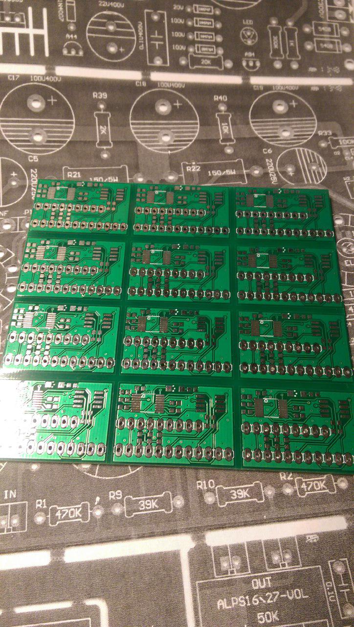

radek tymecki
Joined: Mar 22, 2009
Posts: 85
Location: PL
PostPosted: Tue Jan 15, 2013 10:58 am    Post subject: Reply with quote  Mark this post and the followings unread
can somebody check if it's ok?

[quote="radek tymecki"]can somebody check if it's ok?
Looks very neat! I´ll check the circuit later.
Before making the PCBs, try to arrange the components on a perf board with the same dimensions just to check for clearance in the voiceboard. Some electrolytics sit very close to where the 80017As were.
I was a bit concerned about heat dissipation, as the SSM chips get a little warm. But then so did the 80017As.
Mooger5
Joined: May 02, 2007
Posts: 199
Location: Portugal
PostPosted: Mon Feb 18, 2013 4:37 am    Post subject: Reply with quote  Mark this post and the followings unread
Radeck, there are some errors in your layouts.
SSM pin 2 should go to voiceboard pin 2.
Output of opamp should go to voiceboard pin 3.
I´ll check the rest later.
Edit - OK, sorry. I now see what´s going. The blank space in the voiceboard is counted as pin 2. I´ll check later in the evening.

PostPosted: Mon Feb 18, 2013 5:43 am    Post subject: Reply with quote  Mark this post and the followings unread
yes you must be careful with pins coz empty one has also a number [2]

PostPosted: Mon Feb 18, 2013 6:33 am    Post subject: Reply with quote  Mark this post and the followings unread
Absolutely. Well I just checked your layout and everything seems ok!

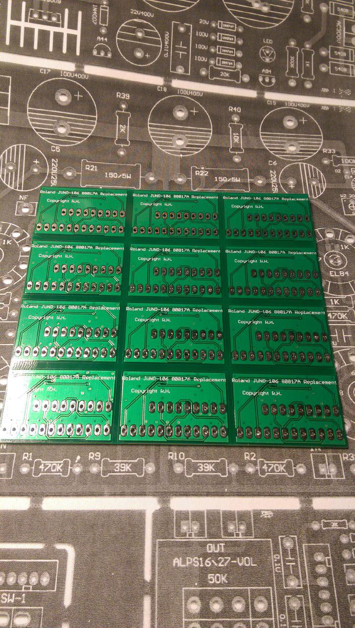

snapper
Joined: Aug 16, 2017
PostPosted: Fri Aug 18, 2017 5:27 am    Post subject:  Roland JUNO-106 80017A Replacement
Subject description: SMD Version with new SSI2144
SMD Version with new SSI2144 cool

Mooger5
Posts: 199
Location: Portugal
PostPosted: Mon Aug 21, 2017 3:39 pm    Post subject: Reply with quote  Mark this post and the followings unread
Uli, is that you? Smile
Seriously, very nice Very Happy
You know, I would ditch the BA6110. It sounds great but THT kind of defeats the purpose. I´d consider replacing it with LM13700 or CA3080 in SOIC format.
http://www.retroamplis.com/CA3080-SM
Plus, unless the Ba is to be soldered directly, without a socket, and its pins bent so that it will sit in parallel to the board, there might not be enough clearance due to the external components sitting very close to the voice chips.
Or at least place it on top, or vertically like I did in my prototype.
A more serious drawback with this design that prevents it from being used plug and play style is the pesky PNP transistor connected to pin 2. The SSM2044 already has one on-chip, so the PNP in the voiceboard must be bypassed, otherwise the resonance won´t work.
Unless there´s a way to revert the control voltage signal back to the value at R107, this 80017a replacement is deemed permanent.
Hey Mooger5,
regarding the above transistor TR18 I have a question for clarification. Is it sufficient to bridge the collector emitter or is it better to unsolder the transistor?
We're testing currently testing to build replacement chips for our Juno 106 here (see attached photos). If anyone is interested, feel free to get in touch.
--Andree

Mooger5
Posts: 199
Location: Portugal
PostPosted: Tue Mar 20, 2018 1:34 am    Post subject: Reply with quote  Mark this post and the followings unread
--Andree
Very neat.
I´d say it´s better to remove the transistor (and bridge the E and C solder pads).
Cheers!
