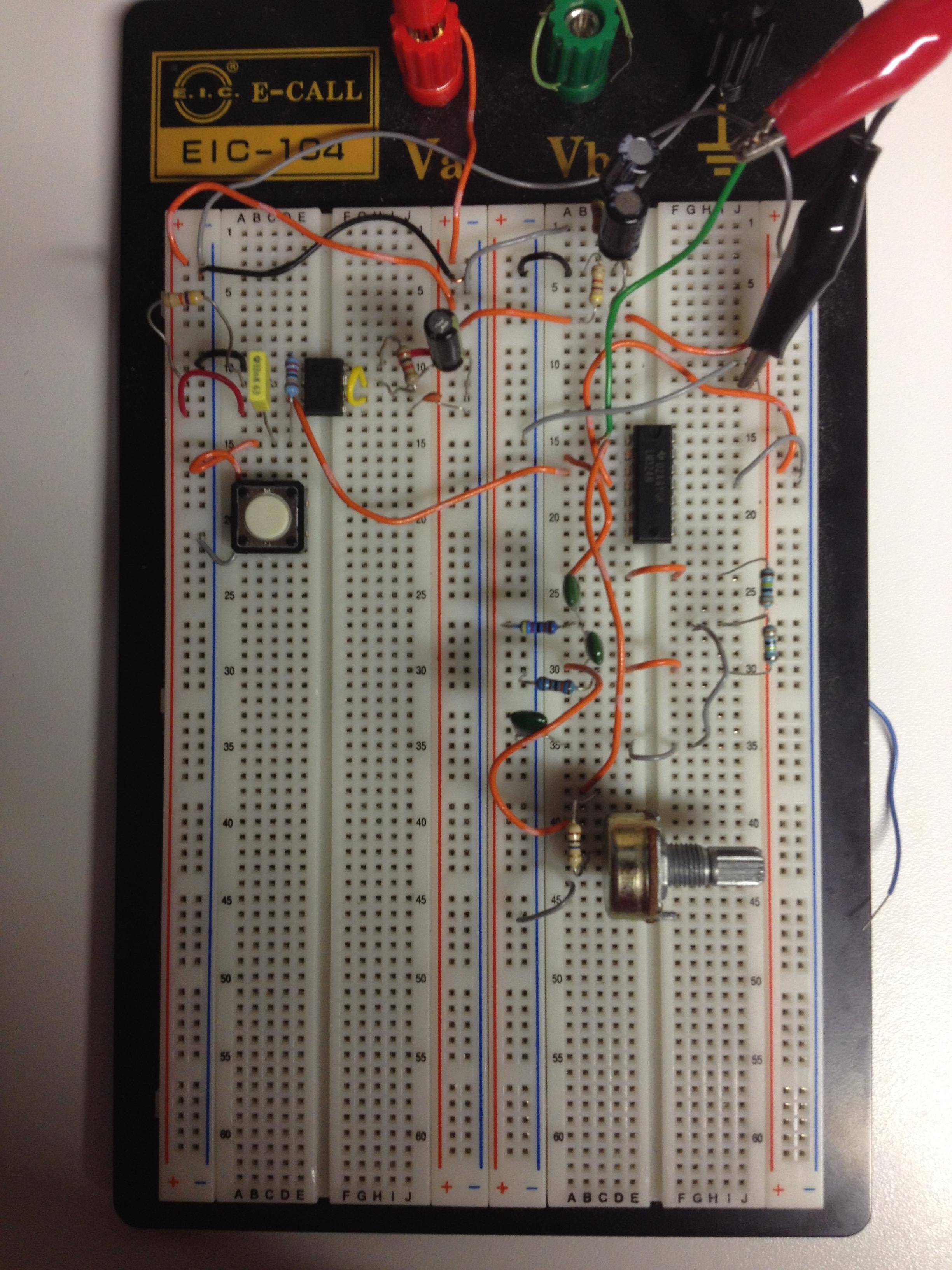

I hope nobody objects to me resurrecting this thread. alkopop79 I tried to build your circuit but I'm having some problems and I wonder if anyone can give me some pointers. I used LM324N instead of LM741. I also had no 3.9M resistors and I used 3.3M. Apart from that I think I used everything the same. I get a basic kick sound but the Twin-T part seems to do nothing to filter the signal. No change when I tweak the pot, or even if I remove those parts of the circuit.
I guess either the substitutions I made are no good, or I have made some kind of rookie mistake in the build. The problem is that I don't understand how the current should be flowing and what I should be testing for in different parts of the circuit in order to debug.
The 555 trigger circuit is on the left side of the breadboard. On the right there is the 'virtual ground' circuit (yes yes I know. grumble grumble) at the top. Underneath the LM324N is the non-functioning Twin-T section. The main power supply is a 9V battery. Perhaps I should be building and studying a simpler RC filter in order to understand better what the circuit should be doing.
I've been kicking around here for a while but took an extended hiatus from electronics and am still to all intents and purposes still a total newb. Any assistance at all would be greatly appreciated. I am not necessarily fixated on this particular circuit. My plan is to make some kind of crude drum machine and I have a shedload of LM324N. Twin-T seems like a great way to make a kick sound. I will make a new thread for my project once it starts to take shape.

PostPosted: Thu Aug 22, 2013 9:44 pm    Post subject: Reply with quote  Mark this post and the followings unread
I'm far away from anything to test with right now, but I'd expect the 3.3 to have more impact than the op amp. Do you have any 560k resistors? Put one in series and see if it improves anything, that should get you close to 3.8M....
