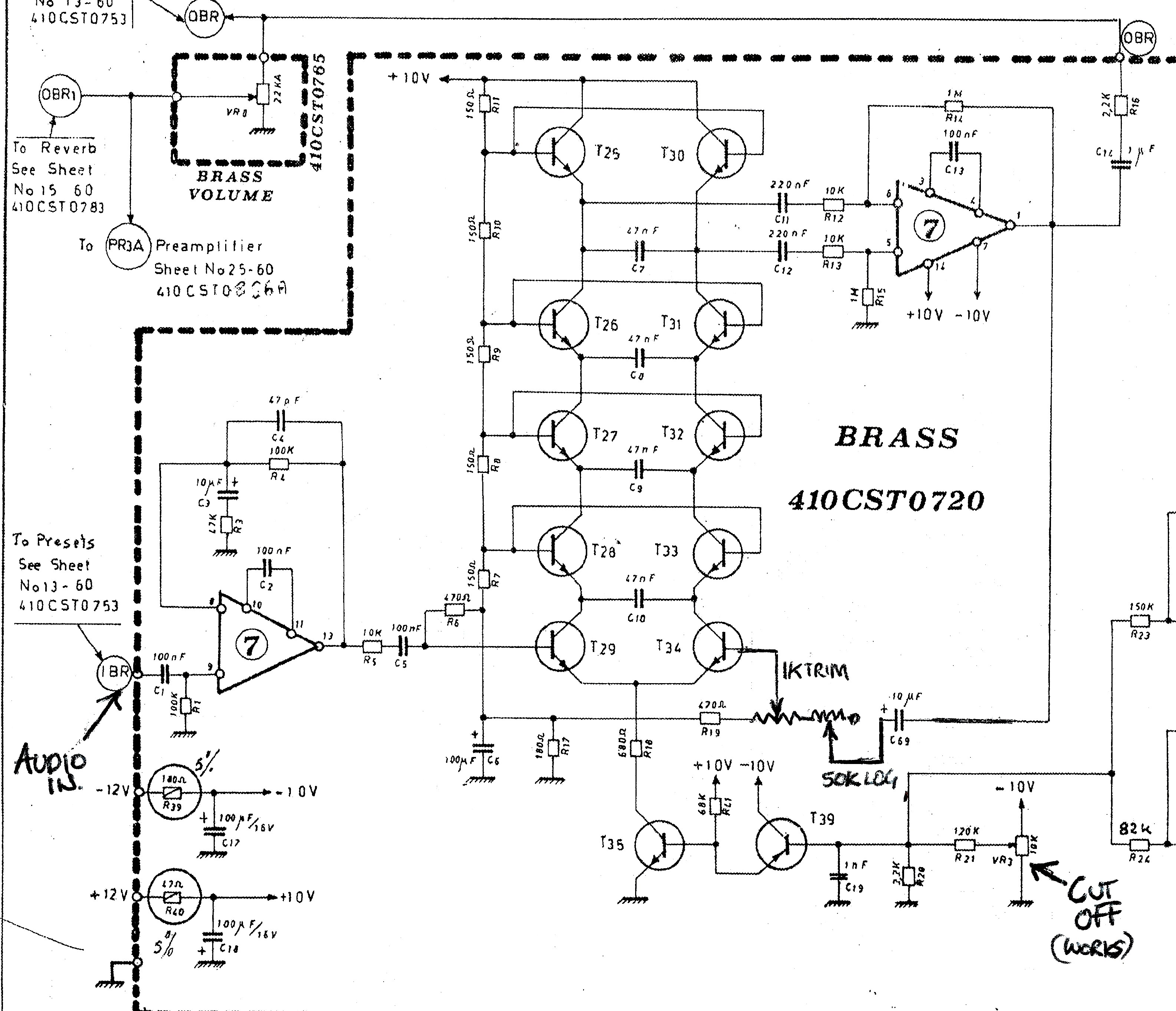

Hi. Ive modded my elka organ which has a ladder filter. Cut off works great with a 10k pot and a 10k trim pot, with both internal sound (brass) and using external input.
But i can't get resonance to work , ive put a 1k trim after the last transistor in the ladder , a 50k log pot and swopped the capacitor round next to the 50k log pot. The resonance self oscillates but theres hardly any control its like its on or off, i can just barely get some squelchy sounds out but it tends to oscillate too easily! Any ideas would be grateful. ive enclosed the circuit diagram with the trim and log pot mods, the dual op amp is an old u739.

You want a reverse log pot, not regular log.

Hi thanks for reply, I've also tried a 100k linear pot with a 100k resistor across the centre and outer pin , which I thought makes a tapered pot,but has same effect slight adjustment and it starts oscillating.

Assuming your pot taper isn't the problem, the only other thing I can think of is that your feedback signal coming from the opamp output is too strong and needs to be attenuated. A voltage divider or maybe even a larger trim pot might work. I don't know what the levels are in your circuit to tell you what a good value might be so you'll have to experiment. Do you have any experience with LTSpice? You might want to try messing around with the circuit in simulation to get a better idea of how it behaves.
Can you put up the original schematic without mods?

Because the res pot is setup as a variable resistor, not a voltage divider. If you look at the resistance of the pot + parallel resistor then yes, you get something resembling a reverse log curve. Which would be fine if resonance increased with resistance, but it doesn't, it decreases. Maximum feedback (self osc) occurs when the pot resistance is 0. If you plot feedback level vs how much the pot is turned, you end up flipping the curve and getting a log taper.

hi ive enclosed a unmodded version of the circuit. There was a 100k pot between the o/p of the op amp and the 10uF capacitor. I think you could be right that the o/p is too high so i will put 100k resistor back or increase trim pot.
Im struggling to find a 50k reverse log pot in the uk! any sources?

hi all, i got the rev log pot and resonance works alot better now more controllable, i also put a 100k variable resistor on the op amp output as the feedback was too high.
Im waiting on a 10k trim to replace the 1k trim for the resonance. As the 1k is having little effect and i may be able to remove the 100k from the op-amp o/p.
Is is normal when resonance is turned up the overall loudness drops a little?

yes this is the normal behavior of this filter

Hi thanks , I've put a 25k pot on opamp output and 10 k trim so its a bit better balanced now, think I will leave it as is.
