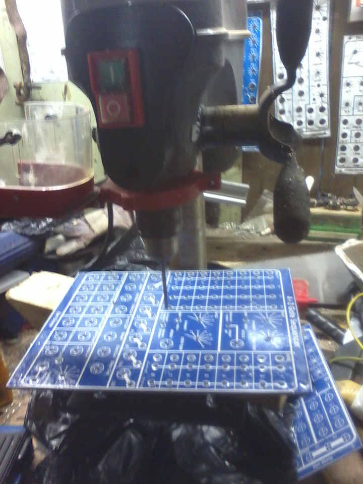

Posted: Sat Apr 19, 2014 7:48 am Post subject:
Extra buffers for gatemix / pulse rows C1 & D1 and a 4024 divider (Fonik) & 4017 divider (Yusynth) done & wired ready on vero-board .
Also got an off cut of 3mm aluminium 250mm X 200mm from Engineers/ metal workshop in town, needs a clean with solvent then ready for the drill template mid week after work.
Dave.

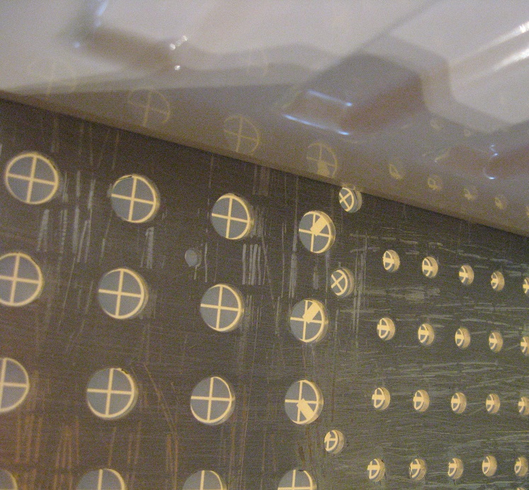

Posted: Wed Apr 23, 2014 2:33 pm Post subject:
Got the stickers done , 2 sets one drill template & one clean finish .
Raced to the shed after work and centre punched the panel(s) , started with the 4mm drill and piloted all crosshairs , then went over the switches / sockets with 6.5mm bit , then 8mm bit for led bezels , and finally 11mm for the 1/4" sockets , I give the face of the template sticker a good spray with cutting oil, messy , but the drills glide through the 3mm alum plate , there are burrs on the exit side but easy to take off , I use a very sharp old wood chisel to plane them off , then the back side of the panel gets a quick rub with wet n dry sandpaper , finally a spray all over with automotive carburettor cleaning spray , great for getting fine grit & swarf off the front surface , don't light a cigarette after spraying , a final wash with soapy warm water and the plate is good for the final finish sticker application .
More at the weekend .
Dave.
