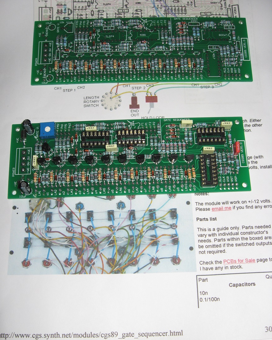

Recently I've been patching Gates from 4 of my diy sequencers through a sequential switch for some changing patterns for 1 bass line Smile , I really like the changing patterns but I'd also like to free up 3 sequencers Smile.
While browsing the net for diy solutions , a popular search return was the CGS89 Gate sequencer with a couple of add on switch banks/ buffers (like Thomas White's 4 channel CGS89).
Smile spent the last few weekends trying ideas for my panel, I think I'm close now Smile , Ordered some boards from Ken and I need to knock together a couple of veroboard divider circuits , one is on the test layout panel already , the space at the lower right is for a rotary selectable/ single out divider.
I'm going for a 4 channel for sequencer 1 and a 2 channel for sequencer 2 , I'm limited by a panel of 250mm high by 200mm wide for this module , I would have made Seq2 a 4 channel too but I will be tight for space , also there are no individual step outs , I had a long hard think about them and decided I'd be using probably just 1 out per cycle , so I went for a rotary to select the desired step & 1 out socket (to trigger my burst generator Smile ) .
Here is the blue test panel layout so far ....

CGS boards arrived yesterday , Smile , decided to stuff the sequencer boards with components this afternoon & make an order to Rapid electronics for some panel switches & sockets etc.
Hope to get panel finalised through the week and get drilling next week Smile .

On the home stretch now , tested & powered up the CGS boards last night , both working a treat , yay Very Happy ,Quick test set up as 2 X 8 step sequencers, after testing both, I tried patching end out to reset in on each sequencer (1 to 2 / 2 to 1) + setting both the switches to hold and it works great as a 16 step with the outs "or" switched to A1 & B1, fab Smile .
Now to connect up & test / debug my veroboard then cable tidy with some ties and give final checks / tests .
pics & some sounds of it working the modular in next post over the weekend.

Cable tying done and testing of whole unit finished Smile phew , nothing bad during final tests , I love it when projects work first time , heheheh Smile .
To the modular system.......
to get audio recording for next post.....
Dave.
