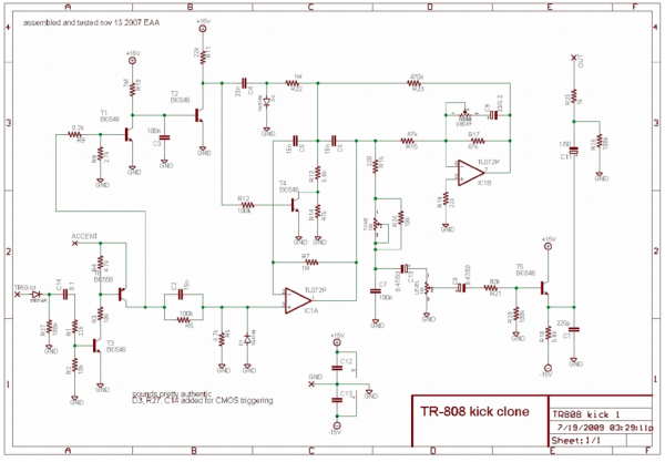

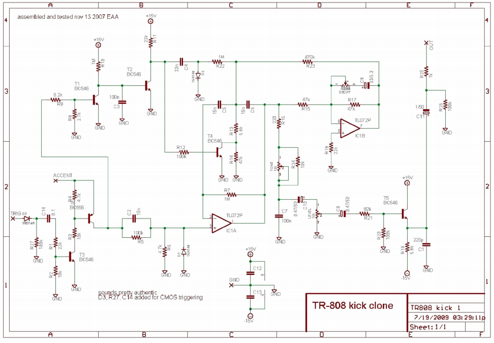

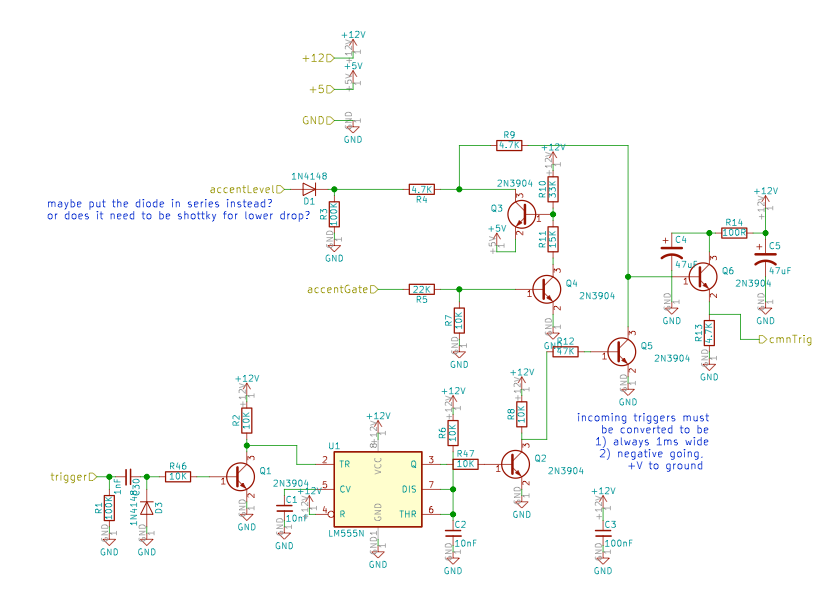

PostPosted: Mon Oct 30, 2017 8:15 pm    Post subject: Reply with quote  Mark this post and the followings unread
I should point out that I actually implemented the *original* accent method, not the workaround that so many have done of tying the accent to a fixed V+.
This is something I've been on about for all of those 5 years Smile
Attached is a more recent schematic that I've been using for some Euro based PCBs.
It differs from what I would have been using all those ages ago in that it actually converts the incoming trigger into a 1ms pulse, its output "cmnTrig" is tied to the "accent" input so-called of the voice and the usual "trigger" input is actually a voice enable gate, so I have tied it to +5V (which again is what it would have been in the original).
When I was triggering from an Arduino, I didn't need to convert anything to a 1ms pulse because I had complete control over that from the Arduino, and I did go ahead and raise and lower the enable gate instead of leaving it tied to +5 all the time.

PostPosted: Sat Nov 04, 2017 6:18 pm    Post subject: Reply with quote  Mark this post and the followings unread
Nice one thanks for the heads up. I might need something like that when I have a few more modules and a more sophisticated way of triggering than just pushing a button.
Did using this circuit affect the timbre? I'm guessing the higher 'Accent' the greater the gain and the more distortion.
I have my kick accent tied to +15 but don't get the same overdrive as you had achieved.
So could lowering the value of the resistors between +15 increase the gain and get more drive? Something like a 1M pot at R10?

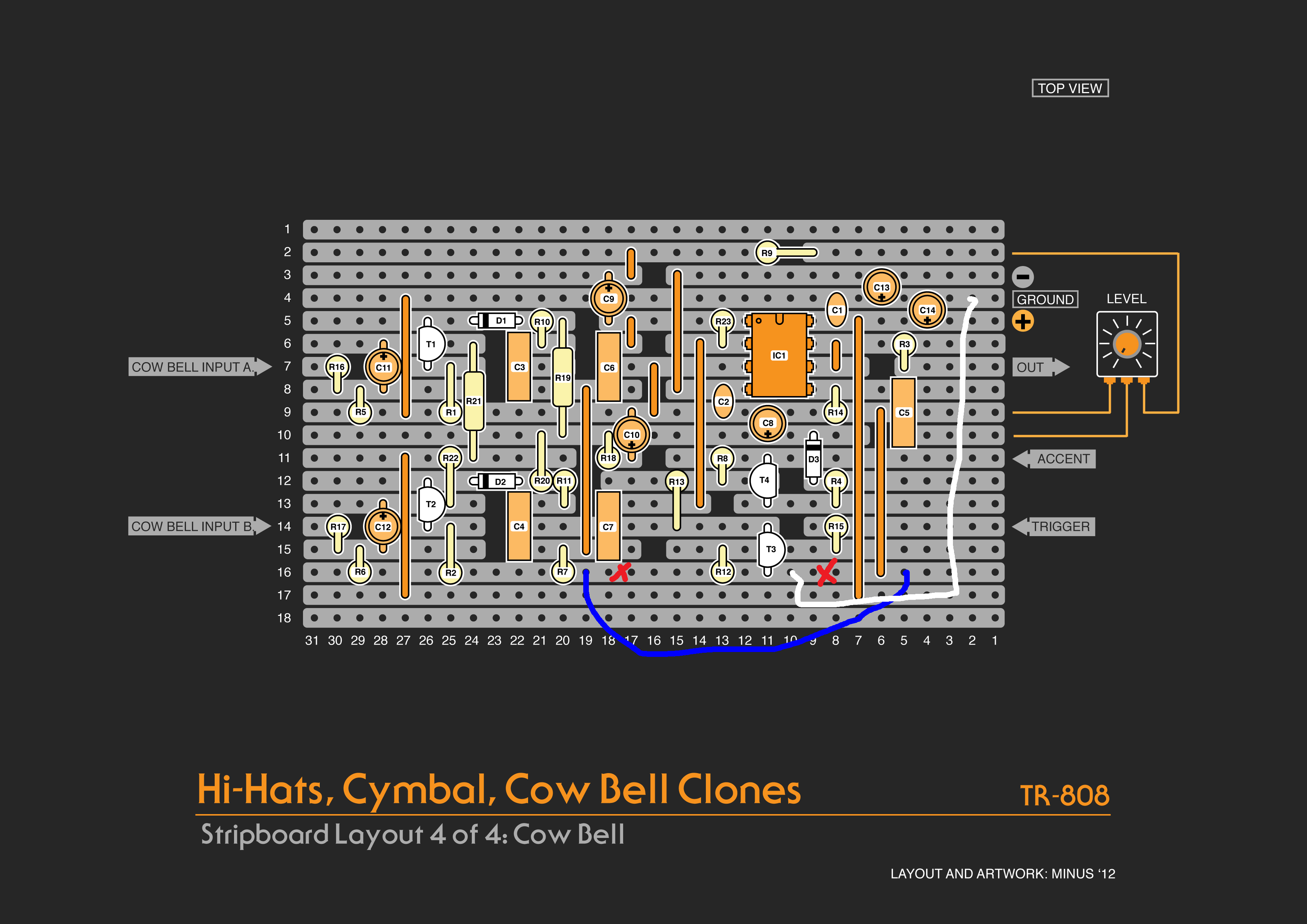

PostPosted: Fri Jan 05, 2018 9:44 am    Post subject: Cowbell Reply with quote  Mark this post and the followings unread
Hi all.
I have 'successfully' made the voice board, cymbal, hi-hats and cowbell.
Minus if you are out there still. Do you have the schematic for the cowbell?
I have some strange behaviour. I can get a cowbell sound but not be triggering from the correct node.
It sounds great actually, I have used the specified 1.85ms and 1.25ms tuning and it sounds almost exactly like an original 808.
I was using a 5v connection and momentary push switch, but have now switched to 9V battery for testing.
Essentially what I have. It won't sound from triggering at R15 or T3. However will sound from R4, R8, R13 or T4. In fact, I have now removed T3 completely from the circuit and I still get it to trigger from the wrong above-mentioned points. However, there is a very low-level signal leakage somewhere. I can just about hear the cowbell sound continuously. This was the case even before removing T3
So I'm curious comparing to the original schematic, the triggering circuit, T3 & T4 doesn't seem correct. Why is the T4 emitter and R12 on the same rail as R2, R6 & R7 and all heading off to the level pot? Shouldn't T4 emitter and R12 just be grounded?
Any help is gratefully received.
Late_to_the_party
Joined: Sep 24, 2017
Posts: 21
Location: London
PostPosted: Fri Jan 05, 2018 10:20 am    Post subject: Re: Cowbell Reply with quote  Mark this post and the followings unread
Ok, so I have possibly solved this myself, any feedback would really be appreciated.
I the solution hasn't stopped the slight signal leak, however, the output is now much louder, so my input gain to the soundcard is lower so the 'noise' is less noticeable.
I have made two cuts to isolate T3 and R12 from the Level pot path, added jumpers so R2, R6, R7 still go to the level pot. And added a jumper so T3's emitter and R12 now go to ground.
Hope this helps others in future.

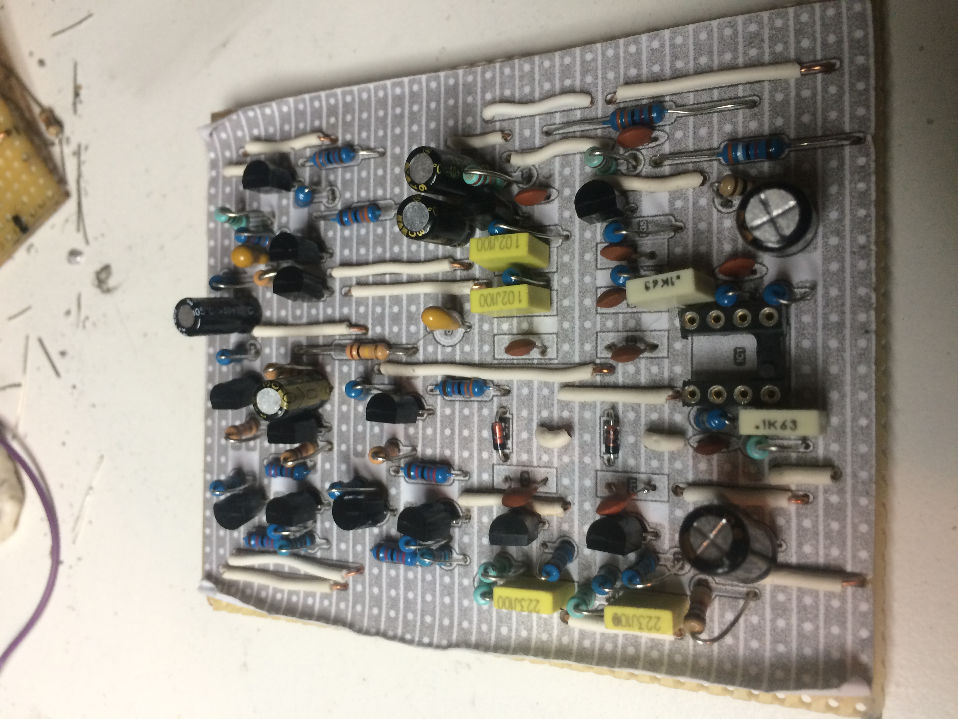

PostPosted: Tue Feb 13, 2018 4:10 pm    Post subject: Reply with quote  Mark this post and the followings unread
Help Please...
I'm pulling my hair out and was hoping someone could check my working...
I stupidly didn't just copy lysergist's stripboard layout of the rimshot/clave as I was trying to learn how to use Fritzing, and potentially get a PCB fabricated.
However, as far as I can see my schematic matches the original 808 schematics,
which should mean my layout is fine, but for both sounds, I get metallic 'PINGS' rather than the appropriate Rimshot/clave noises.
I know its a big ask, but any chance someone could have a look at my fritzing file and see where I must have done something wrong?
https://www.dropbox.com/s/fgwoaetpe78z07i/808%20Rim%20Shot%20%3A%20Clave%20TL074%20PCB.fzz?dl=0
Thanks in advance.
PostPosted: Tue Feb 13, 2018 5:59 pm    Post subject: Reply with quote  Mark this post and the followings unread
First thing that jumps out at me is that you can't power an op amp off of +5V and -12V.....
edit: but I see that you're calling +12V 5V for some reason so that's just confusing, not wrong Smile
PostPosted: Tue Feb 13, 2018 6:39 pm    Post subject: Reply with quote  Mark this post and the followings unread
Why are C9 and C10 increased from 4.7nF to 100nF? I see your notation looks like that's deliberate....
Same with C13 & C14
All your diodes are 1N4001's which is atypical. Normally these would be signal diodes, so 1N914 or 1N4148.
Note that Q1 is a FET, not BJT. I know you've got the transistor noted there, but your symbol is for a BJT....
C6 has the dual notation, but "your" notation is 0pF?? Similarly for C5. Right value in parens, what's the "0pF"?
C3 is marked as .022pF but it should be .0022 just like C1 & C2.
I don't see a resistance value in the original for R324 (your R27), how did you arrive at 220K?
I suspect the most likely problems are the 100nF instead of basically 5nF caps, those will likely move the frequency of those bridged-T networks way down (20x!), and/or C3 having the wrong value.
Hey folks,
I've spent quite a few hours debugging my cowbell as well. Yet it turned out, that the layout by -minus- was correct and it was my sheer carelessness. Embarassed
Therefore, I'm quite surprised Apollo had the problems as stated above -- in fact, the level pot has one leg tied to ground, so... nothing wrong with that. Cool
Anyway, the BOM has two minor mistakes:
1) the level pot should be 5kA (not 100k). Doesn't do much, but feels more 'natural'.
2) C5 (Roland schematic: C76) should be 22n (not 2n2). Again, this does not affect the sound very noticeably, but for the sake of completeness...

Hello everybody,
first off, thanks to all the contributors here, this board is awesome!
I'm fairly new to all this, and I just wanted to share a bit of my experience.
I don't know if this is obvious or not, I just didn't see this trick any where yet so I thought I could share..
After a first attempt, I found it very tedious to count the rows and columns on the board to find the right components place..
So I printed a 1/1 scale copy of the layout and sticked it directly on the stripboard: pinning the components in the right spot just got so easy!
The hihat is mostly working, I just still have a small volume problem, it might be a bad pot.
Thanks -minus-!
bruno
