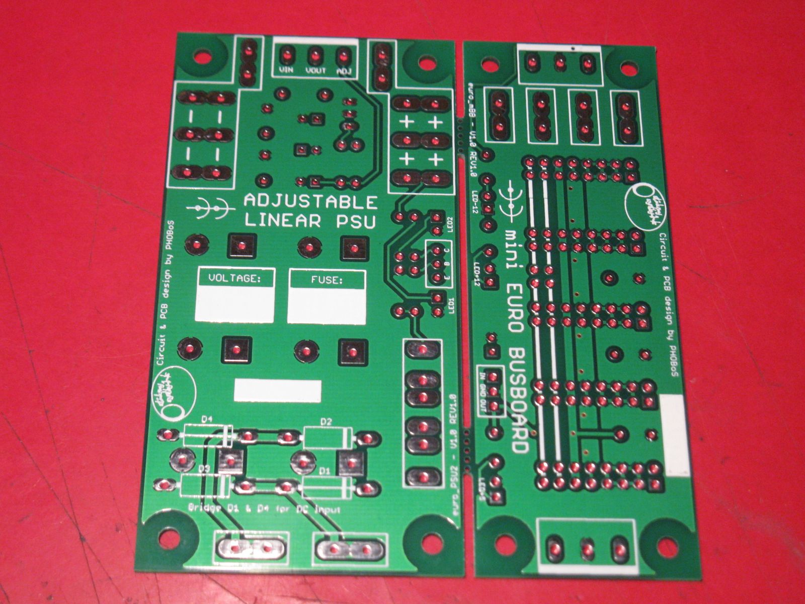

I have been working on a PCB design which I think is pretty much finished for fabrication. Because it is a double layer PCB
I was able to create some larger copper areas and make it a bit more compact than with perf as I am not stuck to a 0.1"grid.
the maximum size that would fit is 100x50mm or at least the 50mm is fixed. However the cheapest boards are 100x100mm
so I had some spare space. I thought about creating some small boards for a simple LM317/LM337 supply which can always
be useful but I also need some busboards. I can't fit a lot of connectors on such a small size but I wil have 10 of them so I
added some space for screw terminals to link them together. The reason it is upside down is because I cheated a bit to get the
maximum amount of board space. The demo version of eagle I am using allows a max size of ±100x85mm however I noticed
that this only seems to count for components. The boards can be larger and you can still add silkscreen, traces etc. just no
components. So I used this 'free' space for the connectors which don't have the solder pads close to the edge.
also, the fancy gold plated headers I'll be using for the connectors have arrived. Cool

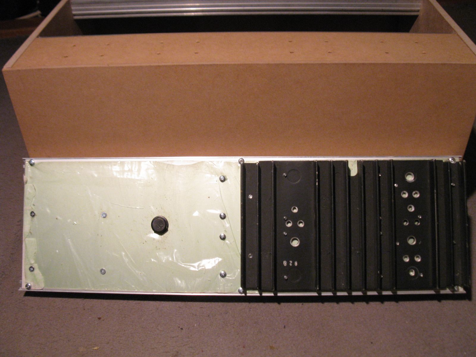

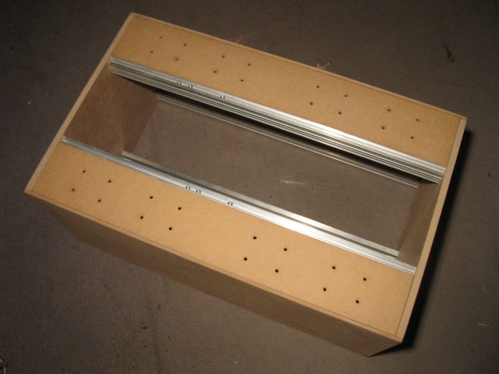

I added rails to the backside of the case to mount the PSU, added panels for the busboards and did some work on the PSU itself,
I hope the heatsinks will be sufficient. (the whole panel and rails will act as a heatsink too of course). I also did a quick test with
the regulators and they do work, I have no idea how well they will hold up under load though.

I received the PCBs today.
cheers

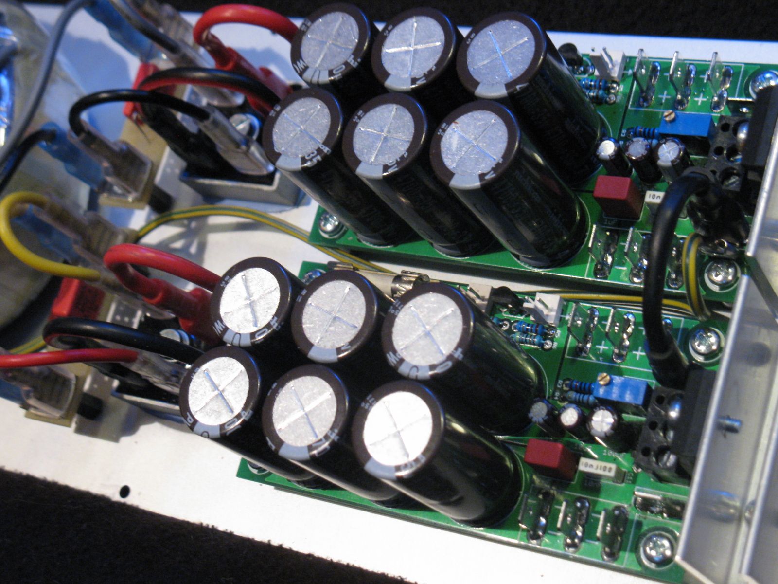

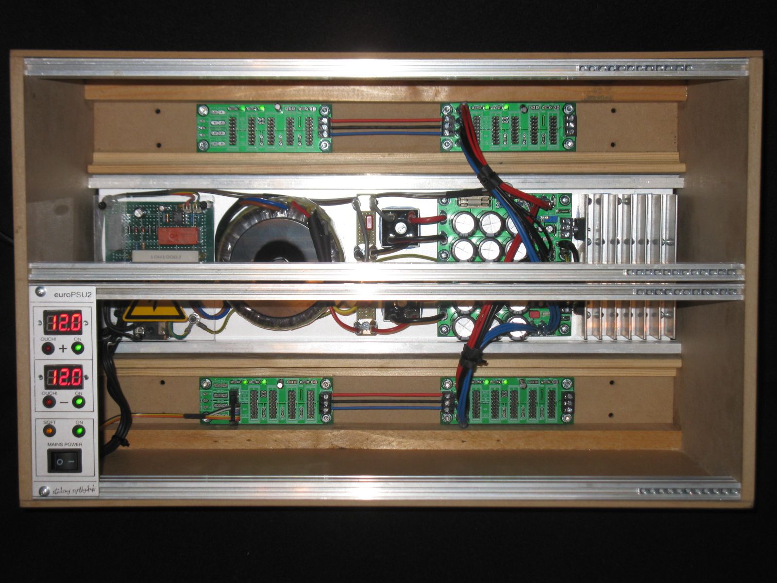

Almost finished, just need to make a panel for the mains switch and some LEDs. It does drop a bit under
load so I did a test with an LM350 but got the same (if not worse) results. So I guess it's good enough.

Nice build, looks pretty pro.
Re. the voltage drop on load .. how bad is it?
One 'but' I see is ... it may not be an issue at all ... you are not optimally using the heat sinks this way .. so when it runs too hot with the max current, mounting it a bit differently might help you out.
Posts: 5912
PostPosted: Fri Nov 17, 2017 11:43 am    Post subject: Reply with quote  Mark this post and the followings unread
With a 1.25A load (12V/15W lightbulb) it drops from 12.00V to 11.95V, not sure how much it exactly is as my meter
isn't accurate enough. It's a bit more than I was expecting but probably a lot better than my current wallwart supply.
I think it might actually be because the input voltage is too low, with the 1.25 load this drops to about 13.9V DC.
So I measured the mains voltage and at the moment that is only 216V Confused The transformer is designed for 240V
so the output voltage will already be a bit lower with 230V. It could be that I just need a new DVM though.
You are absolutely right about the heat sinks. Idealy the regulators would be mounted to the base but that's not really
going to work with the way I have mounted them. Although I was thinking yesterday that if I could make some alumiunium
spacers with cutouts for the regulators that would work. Another easier option that would improve it is to mount the
regulators upside down so they are much closer to the base of the heat sinks which is about 1cm thick.
