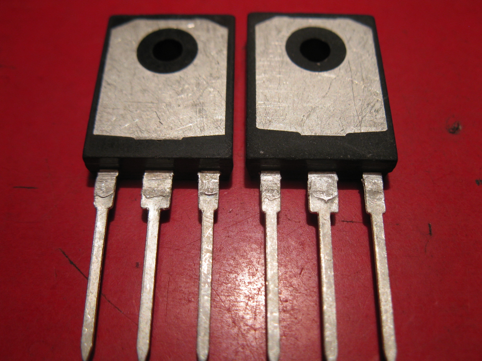

I received the LT1083 regulators and they are clearly refurbished parts. At first glance they seem to be ok but a closer inspection
reveals they are not what they seem to be.
The first clue is that there are some scratches on the packages. I guess this could happen if a lot of them would be packed
loosely in a bag and thrown around but that is usually not how components are handled.
The second clue is much more obvious and has to do with the pins. They look new and unsoldered, which they are, but if
you take a close look you can clearly see those are reattached pins and the old original ones are actually pretty short
and probably just cut off.
The third clue is that there are actually some slight differences between the packages of the two I have (this worries me a bit).
Not only do the mounting holes seem to have a different size but if you hold them back to back it also shows there is a small
size difference. There is also a difference between the embedded markings.
I also tested with acetone to see if the top layer comes off (which it shouldn't if original) and it does. This by itself doesn't
say much though. It could be an original although used LT1083 which they stamped a new code on so it looks new again.
I haven't removed the whole top layer yet (curiousity might get the best of me though) but I don't think it is likely I will
find anything underneath. If they are totally different components they'd probably grind off the original markings (I think
it is laser etched) but they would probably do this anyway to get a smooth surface for the new top layer.
I still have to test them to see what they do. Maybe I do some measurements between the pins to see if there are any obvious
differences between the two 'regulators' I have.
If they are actually just refurbished LT1083 regulators I don't mind at all as I only paid about 10% of what they should cost new,
as long as they work of course. However, because of the differences between the two I don't think they are.
edit: the readings I get (diode tests between pins) are consistent between the two devices and are different from a regular
transistor, so that is actually somewhat promising.

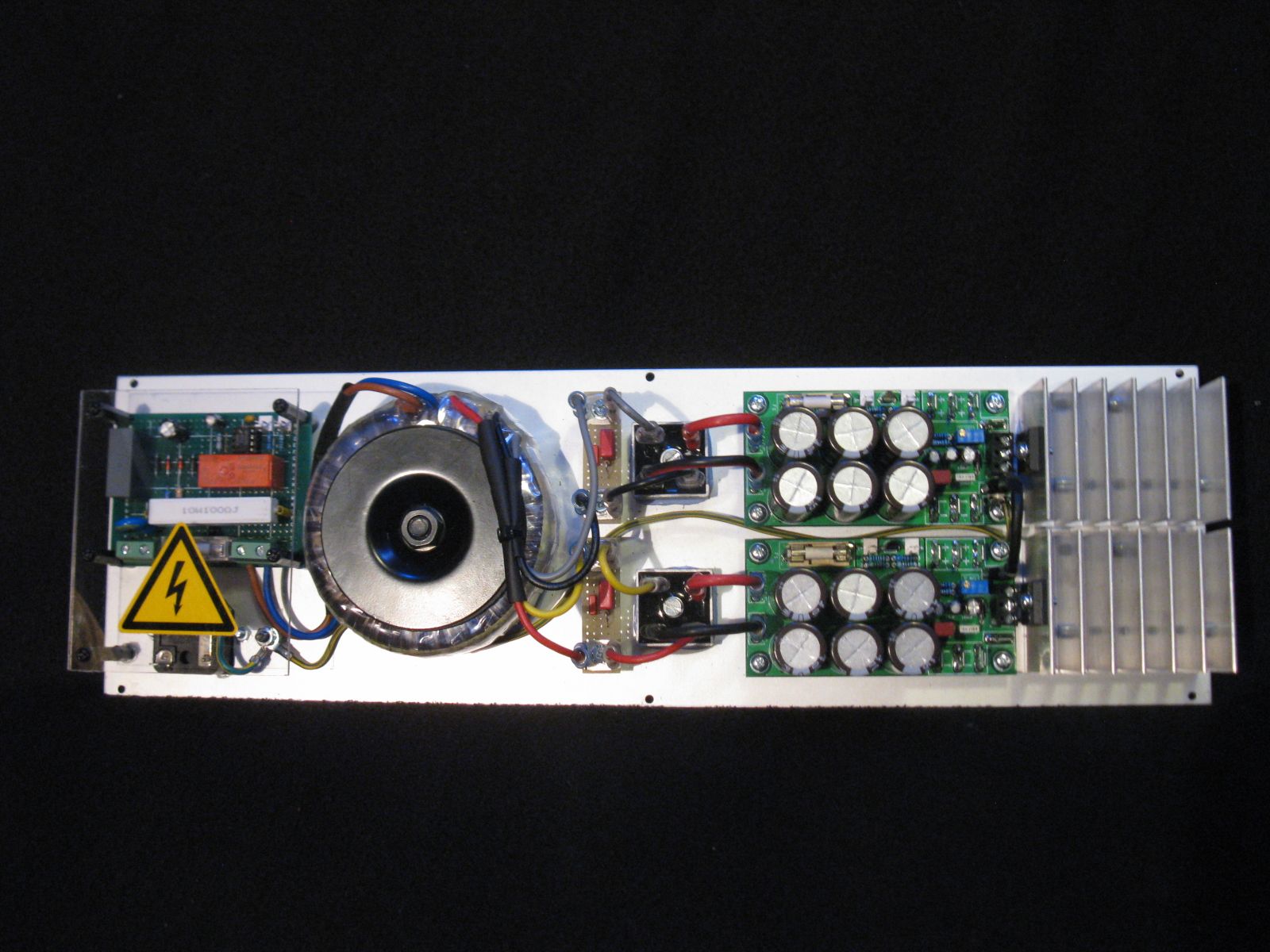

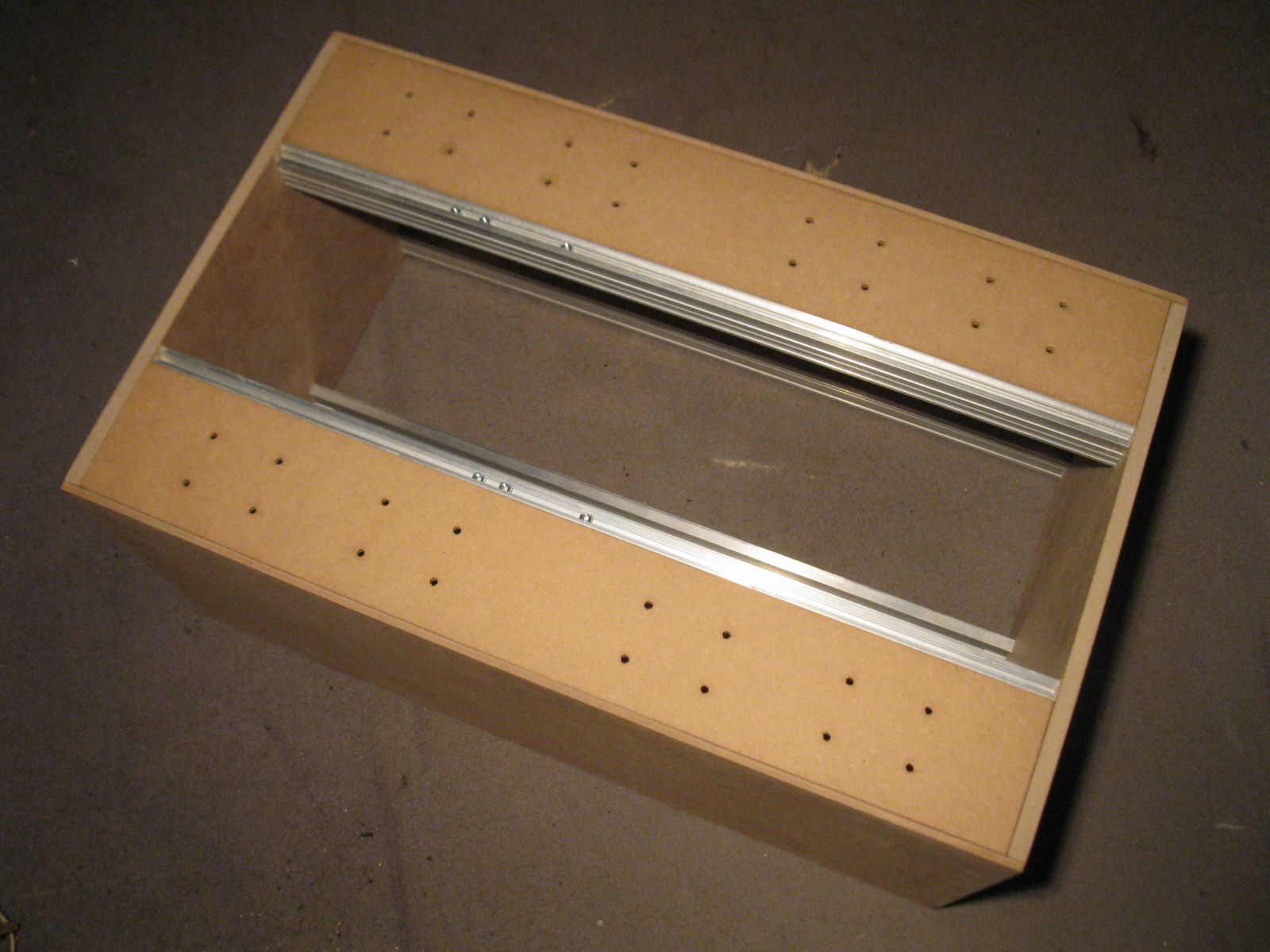

I added rails to the backside of the case to mount the PSU, added panels for the busboards and did some work on the PSU itself,
I hope the heatsinks will be sufficient. (the whole panel and rails will act as a heatsink too of course). I also did a quick test with
the regulators and they do work, I have no idea how well they will hold up under load though.

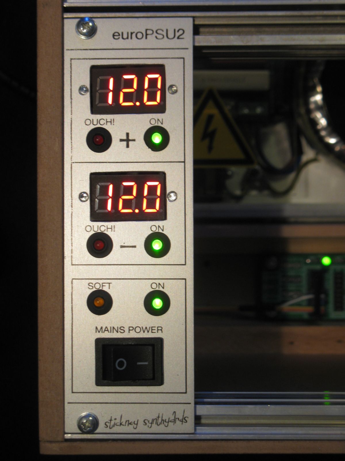

Almost finished, just need to make a panel for the mains switch and some LEDs. It does drop a bit under
load so I did a test with an LM350 but got the same (if not worse) results. So I guess it's good enough.

With a 1.25A load (12V/15W lightbulb) it drops from 12.00V to 11.95V, not sure how much it exactly is as my meter
isn't accurate enough. It's a bit more than I was expecting but probably a lot better than my current wallwart supply.
I think it might actually be because the input voltage is too low, with the 1.25 load this drops to about 13.9V DC.
So I measured the mains voltage and at the moment that is only 216V Confused The transformer is designed for 240V
so the output voltage will already be a bit lower with 230V. It could be that I just need a new DVM though.
You are absolutely right about the heat sinks. Idealy the regulators would be mounted to the base but that's not really
going to work with the way I have mounted them. Although I was thinking yesterday that if I could make some alumiunium
spacers with cutouts for the regulators that would work. Another easier option that would improve it is to mount the
regulators upside down so they are much closer to the base of the heat sinks which is about 1cm thick.
