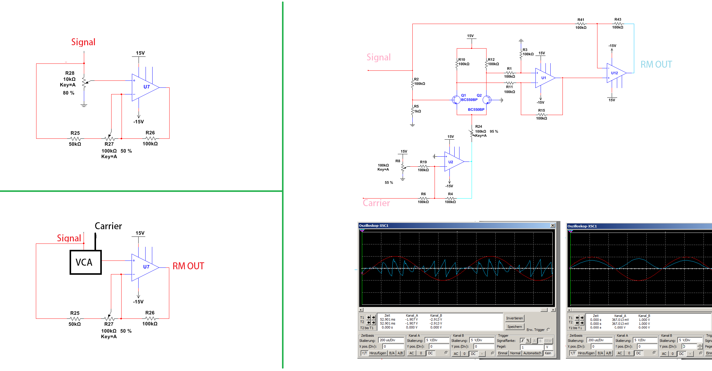

alanwilder has asked me what a vca has to do with a rinmod. I thought i will post an explanation of the circuit here, cos for me it was hard to find a good one when i was going to be interrested in ringmods.
Ringmodulation is also called 4quadrant multiplikation, so far so good.
A normal VCA does 2 Quadrant multipikation. Means if there is a CV and a signal present to output swings up and down, the cv paints the shape. BUT the cv is only positive. If apply a negative cv to the vca it will be mute to output. see pic1
If we put a second vca that can react on negative CV (eg by inverting the cv) AND mix those 2 signals together we have a maschine that makes , i guess, 2 Quadrant Multiplikation. that means the output will swing up and down, even there where before silence, like a copy of the active part pasted into the muted part. see pic2
now the only thing we have to do for have ringmodulation is to invert the phase of the second part we hav created, which can be easily done by an inverter. see pic 3. between the shape in pic2 and 3 is only a little difference when the cv is going thru zero and a important that in the "second" part the phase is shifted - like the wave is going backwards.
pic 4 shows the concept in blocks
any corrections and additions welcome.

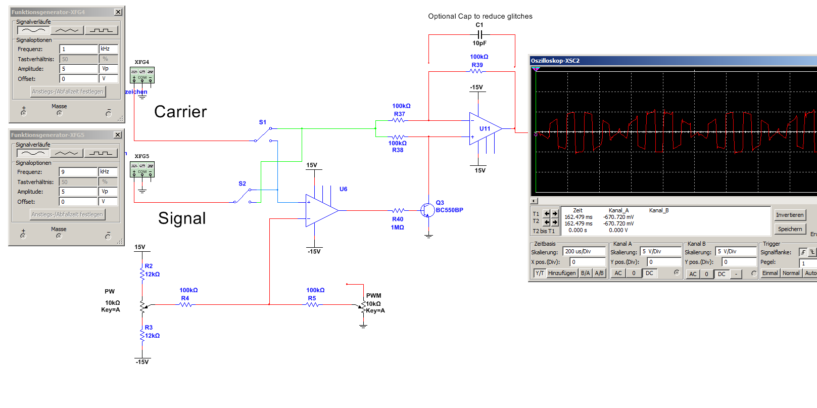

i guess i posted it already somewhere else, but ....
one very simple Ringmod, a switching one, which will give u of course a diiferent sound as a classical one Smile
and two mods for this, a ringmod with PWM Shocked and a double-switch to swop the inputs
this could also be used as a VCA for rectangular waves
 Filesize:  68.78 KB
 Viewed:  409 Time(s)
 Filesize:  89.19 KB
 Viewed:  408 Time(s)
 Filesize:  71.85 KB
 Viewed:  416 Time(s)

PostPosted: Sat Oct 27, 2018 3:30 am    Post subject: Reply with quote  Mark this post and the followings unread
and again something about: "how i can use VCA as RM"
single VCA:
u could rectify the CV/carrier and always when the carrier is negative u turn the phase of the vca-output
double VCA: same idea as some post above but maybe better to read
 Filesize:  49.6 KB
 Viewed:  400 Time(s)
 Filesize:  36.71 KB
 Viewed:  387 Time(s)
