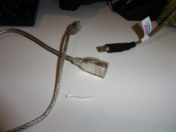

Of course, here I go.
I've uploaded some pictures with descriptions. I've also attached an audio file with the recording of my G2 using the regular cable, and then the extension with the paper. I suppose most people don't notice the noise but keep in mind that I use headphones almost always and that way is very noticeable. Moreover, once you record the audio into a DAW and start compressing the buzziness gets really loud.
The record is just the G2 straight into my Fireface 800, without any other synth turned on.
Please keep in mind that I really don't know why it works. I thought it could work and tried disabling pins until it worked. Wink

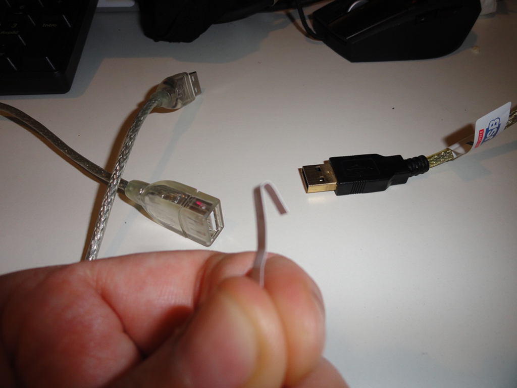

You need the cable from the G2 to the PC, an USB extension cable, and a tiny bit of paper (probably thin plastic would be better).

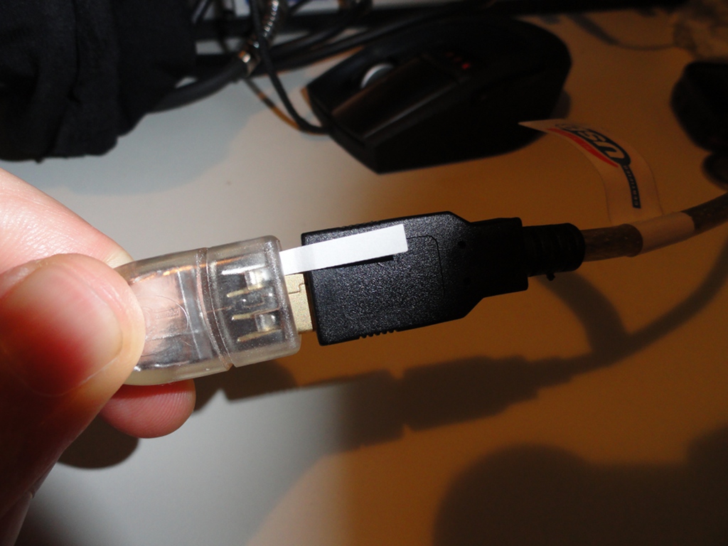

You have to put the paper exactly as it is shown in the picture.

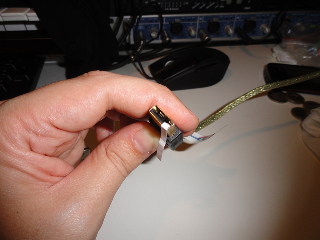

I like to keep the paper visible so I will remember this is a special USB connection, otherwise I may forget (bad memory here, really).

Now I know why it works. I'm disabling the +5 current pin, which is the one that carries the ground loop noise and it's not needed since the G2 has its own power source. I'm planning to disable every +5 USB pin not needed in my cables (ie. other synthesizers or devices that have their own power source).
Moreover, and I think this is very important: I know that the G2 does not need the +5v USB input pin (it's only used to provide power to some USB devices like mouses, keyboards, controllers, etc), but someway the pin IS connected to the synth board because the effects on the audio signal are very noticeable.
This leads me to think it shouldn't be that way. It may well cause the USB port to break if connected and disconnected very often, or if the computer sends a unusual voltage spike trough the +5v pin. You know there are many posts about broken USB ports in the forum.
What do you think about this?
Albert

I have similar problems and tried the "paper in the USB connector" approach.
For some reason, removing the connection to the +5V connector would not produce any result.
However, removing the Ground connection stops the noise. Hurray ? Is it safe ?

I wouldn't recommend doing that now. There is a much better and safe alternative, and that is using an USB Isolator. I have had one for years now and my G2 has worked beautifully since then, without any noise in my audio chain.
It was expensive when I bought mine (more than 60€ if I recall correctly) but nowadays they are much cheaper. It worths every cent and I feel more safe now.
