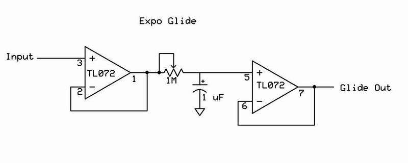

This is the lag circuit I was most familiar with - works OK with keyboard, but I don't like it nearly as much as the linear circuit above for keyboard. This one works great with S&H and other general lag nuttiness.

Scott Stites wrote:
Didn't the MiniMoog have linear glide?
Yup, the rate varies a little over the range of the keyboard but I dont think this is a feature.
Going just from the description, expo sounds like it should be the best option. In practice though, it sucks.
Thanks for that - I've heard that the Moog modular had expo lag - is that the case?
Just one switch to go from one to the other...
Yep, one switch. I've never looked into putting it on my keyboard - it's slightly more complicated (not much) because the buffer is a discrete FET buffer rather than an op amp buffer. That's not the hurdle. It's already soldered up on a board and my natural laziness has prevented me from actually *doing it*. That's the hurdle. Very Happy
The idea of a continuously variable fade from one response to the other to me is intriguing - don't know if that's one of those things that sound better on paper than it really is, though. There's not a lot to the circuit, though obviously there's more than a dual op amp buffer and a switch.
