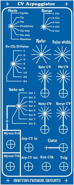

Hi , just finished a design for my front panel Smile
Im using rotary switches for some parameters & building a little stripboard circuit with an extra 2 cv mixers , i've worked out the resistors needed between the rotary positions which i'll post up once ive tested after populating.
I included a rotary switch for the external clock divider control as i usually clock all my sequencers from a midi source.
Dave.

PostPosted: Tue Jul 19, 2011 11:32 am    Post subject: Reply with quote  Mark this post and the followings unread
been busy over the last couple of weeks....
Finished the panel , fitted the hardware , wired up & powered up , just got the trimmer to set and also adjust a couple of resistor values on my rotary switches , i found that once the volt divider voltage went through the cv mixer / inverter stage the output dropped 0.2 of a volt , i re-calculated the resistors needed again and the rotary switches are selecting functions correctly now , Very Happy great , i will post up what values i used for the rotarys , i'am running this on 12v.
I realised i forgot the reset for the internal clock , so i drilled a push switch on the panel & also realised that the tempo / rate pot doubles up as the external clock divider control so i put a 2 way switch to select pot for rate control and rotary for division control , all good now, heh Smile .
Sounds to come later in the week .
Fantastic module , im having great fun with this & i got some ideas for a new track Very Happy.
