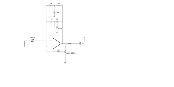

I'm trying to build a twin-T oscillator for synthesising drum sounds. The LM741 heats up pretty quickly and the circuit hardly oscillates even when the feedback is at 100 per cent. Even with an LM386 amp I hardly get anything (though I can see some oscillation on the scope). The circuit gets 10ms 5V pulses from an Arduino. Does the TL071/2 run from single supply? Can it replace the LM741?

PostPosted: Sat Apr 13, 2013 6:27 am    Post subject: Reply with quote  Mark this post and the followings unread
Have you checked to see if the chip is bad, by putting in another one?
TL072 does not operate single supply. LM324 does, but it's a quad chip. I believe LM321 would be the single amp version, but I've not used them.

PostPosted: Sat Apr 13, 2013 6:33 am    Post subject: Reply with quote  Mark this post and the followings unread
welcome alkopop79
The speaker ... I'd not directly drive a speaker from an opamp .. if you want a speaker in the box make a separate power amp for it.

PostPosted: Sat Apr 13, 2013 8:15 am    Post subject: Reply with quote  Mark this post and the followings unread
As Blue Hell said - the speaker - it's a very low impedance load and could easily cause the problem. As Blue suggests, better to run the speaker from a separate amplifier.

PostPosted: Sat Apr 13, 2013 8:56 am    Post subject: Reply with quote  Mark this post and the followings unread
It still wouldn't work.
For single supply, almost any op amp would work in this circuit IF the (+) input is biased to 1/2V+. (Which some mistakenly call a virtual ground.) Triggers should then be capacitor-coupled in.

PostPosted: Sat Apr 13, 2013 9:21 am    Post subject: Reply with quote  Mark this post and the followings unread
It's possible that the signal generator symbol might be intended to account for the required bias. I can't really tell for the symbol in the circle.
However, the signal generator also indicates 500 mHz which is .5 Hz. I suppose that this filter is intended to operate at very low frequencies?

PostPosted: Sat Apr 13, 2013 9:57 am    Post subject: Reply with quote  Mark this post and the followings unread
Looks to me that the signal generator is there to provide input pulses at a 0.5 Hz rate (as an illustration, I guess, of what it takes to ring the thing).
Like mentioned before, if it's single supply, it would need an artificial ground (1/2 Vcc) and (again) drive the speaker from a second amplifier.

PostPosted: Sat Apr 13, 2013 12:31 pm    Post subject: Reply with quote  Mark this post and the followings unread
Thanks for all the replies! I did further simulation and indeed, without virtual ground it won't work. THe circuit can be found here:

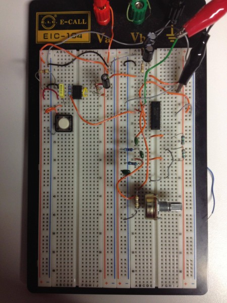

I hope nobody objects to me resurrecting this thread. alkopop79 I tried to build your circuit but I'm having some problems and I wonder if anyone can give me some pointers. I used LM324N instead of LM741. I also had no 3.9M resistors and I used 3.3M. Apart from that I think I used everything the same. I get a basic kick sound but the Twin-T part seems to do nothing to filter the signal. No change when I tweak the pot, or even if I remove those parts of the circuit.
I guess either the substitutions I made are no good, or I have made some kind of rookie mistake in the build. The problem is that I don't understand how the current should be flowing and what I should be testing for in different parts of the circuit in order to debug.
The 555 trigger circuit is on the left side of the breadboard. On the right there is the 'virtual ground' circuit (yes yes I know. grumble grumble) at the top. Underneath the LM324N is the non-functioning Twin-T section. The main power supply is a 9V battery. Perhaps I should be building and studying a simpler RC filter in order to understand better what the circuit should be doing.
I've been kicking around here for a while but took an extended hiatus from electronics and am still to all intents and purposes still a total newb. Any assistance at all would be greatly appreciated. I am not necessarily fixated on this particular circuit. My plan is to make some kind of crude drum machine and I have a shedload of LM324N. Twin-T seems like a great way to make a kick sound. I will make a new thread for my project once it starts to take shape.
 Filesize:  649.17 KB
 Viewed:  166 Time(s)
PostPosted: Thu Aug 22, 2013 9:44 pm    Post subject: Reply with quote  Mark this post and the followings unread
I'm far away from anything to test with right now, but I'd expect the 3.3 to have more impact than the op amp. Do you have any 560k resistors? Put one in series and see if it improves anything, that should get you close to 3.8M....
